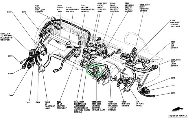

After replacing headlight lamp switch when car is started anti-theft alarm goes off. Car will not start.
Tried disconnecting the battery, tried turning the ignition back and forth. Nothing is working.
Any suggestions?

This may be an add on alarm system issue. Did you notice any wires tapped in to when you replace the switch?

No wires.its a factory installed anti-theft system.

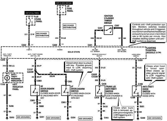

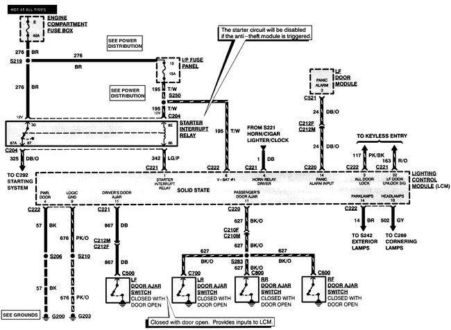

Something has triggered your anti theft system, the best way to diagnose this is to use a scan tool that can show the inputs and what they read to find out what has triggered the alarm. Also the system is tied in to the lighting control module, which is a known problem and can cause various faults. I've attached the wire diagrams so you can see how it ties in.
