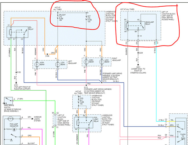

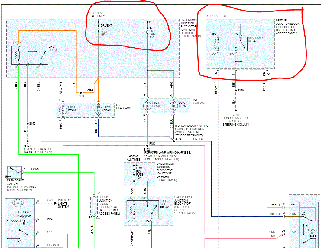

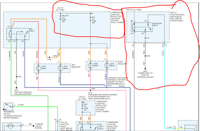

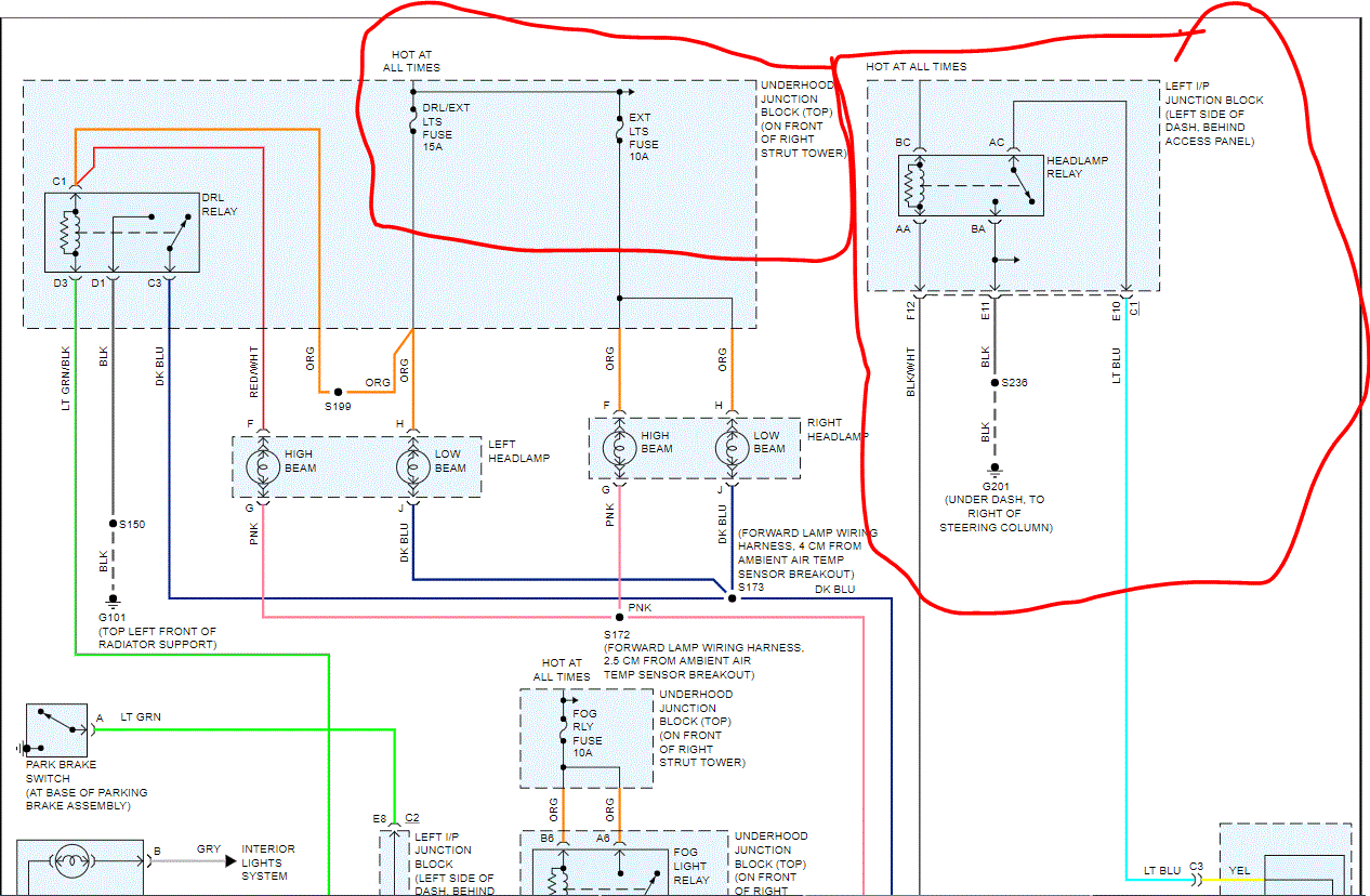

The idea that the lights fade is likely the result of a weak battery. That is the first thing I would check.
First, make sure the battery terminals are clean and tight. Here is a link to help:
Next, I would recommend doing a simple load test on the battery. Here is a link that explains how that is done:
I also attached two pics below that show the electrical schematic related to the headlamps. I circled two fuses and a headlamp relay that should be checked as well. When checking the fuses, make sure there is power to them as well as just checking the fuse. Note that the two pics are from one page. I cut them in half to make it easy to follow. I did overlap them so you can see where they come together.
Here are two links you may find helpful when testing the relay and fuses:

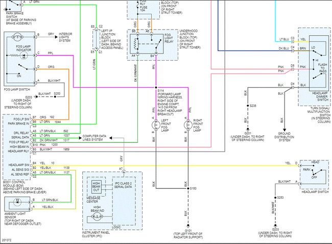

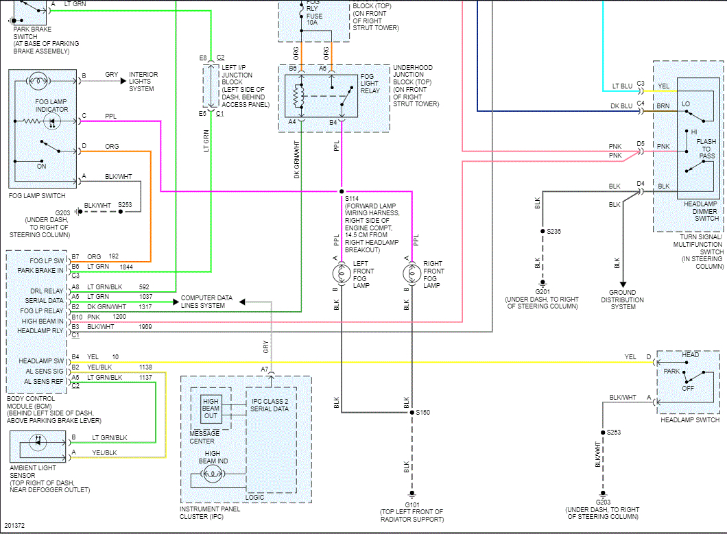

If they aren't working at all, we need to start by checking fuses and the headlight relay. I attached a portion of the wiring schematic. I suggest checking the fuses indicated and the relay. In addition to checking the fuses, confirm there is power to them.
Here are a few links you may find helpful:
Here is a link that explains how to test a relay as well:
Let me know what you find. If you have other questions, let me know as well.
