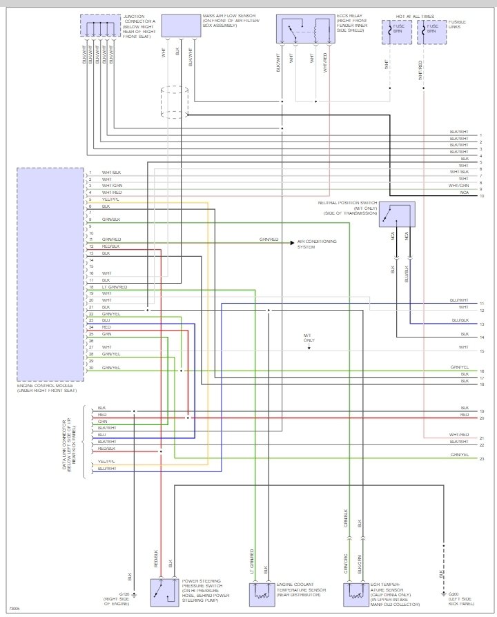

when you turn the key off the engine keeps running, the radio turns off, but the engine stays on. I have been turning it off by putting in 5th gear release the clutch, hold the brake and let it die, the dashboard lights stay on. I then disconnect the battery and reconnect and the lights are off.

7BEAR
I HAVE A NEW DISCOVERY, I HEARD A CLICKING ON THE FENDER WALL IT WAS THE ECCS RELAY, I PULLED IT OUT AND THE VEHICLE STARTS AND SHUTS OFF JUST FINE, BUT WHEN I PUT A NEW ONE IN IT IS BACK TO THE SAME OLD WAY. NEED MORE HELP.

  • 55,721 POSTS
I looked up the wiring for this relay and it looks like it is controlled by the ECM, here is the diagram, it could be the computer has gone bad not allowing the relay to open
