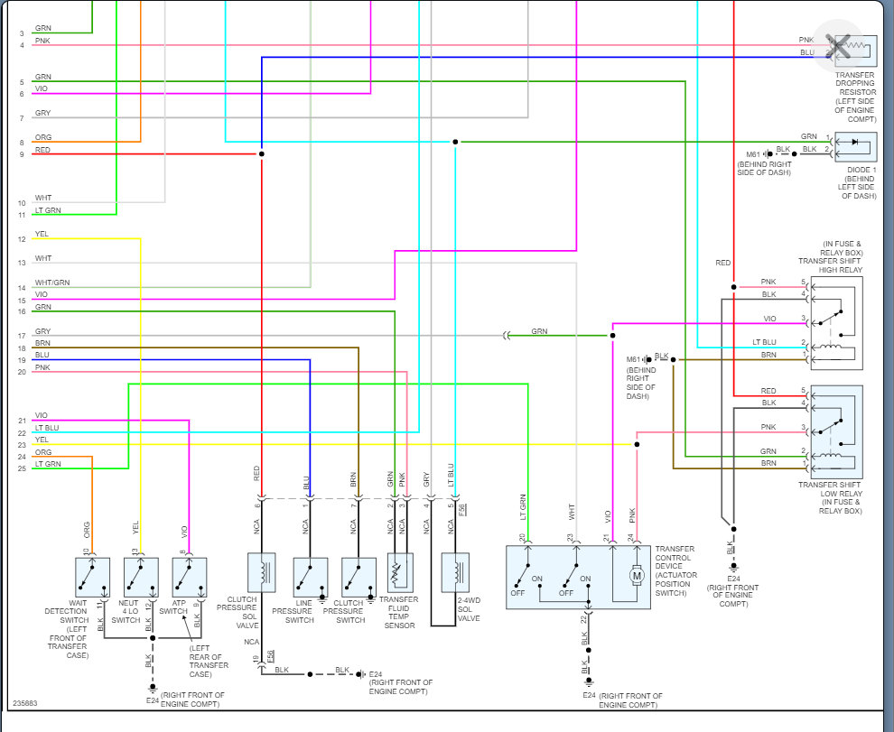

I just bought a used vehicle listed above and was putting it through the paces. When I switch from 2WD to 4WD (High mode), the 4WD indicator light flashes briefly and then stops indicating it is in 4WD. But, when I switched back to 2WD, the indicator light flashed for 6 minutes before it registered a static display indicating it is back in 2WD. Is this normal? Or do I have an issue that needs to be resolved?
Sep 8, 2009 at 12:15 PM

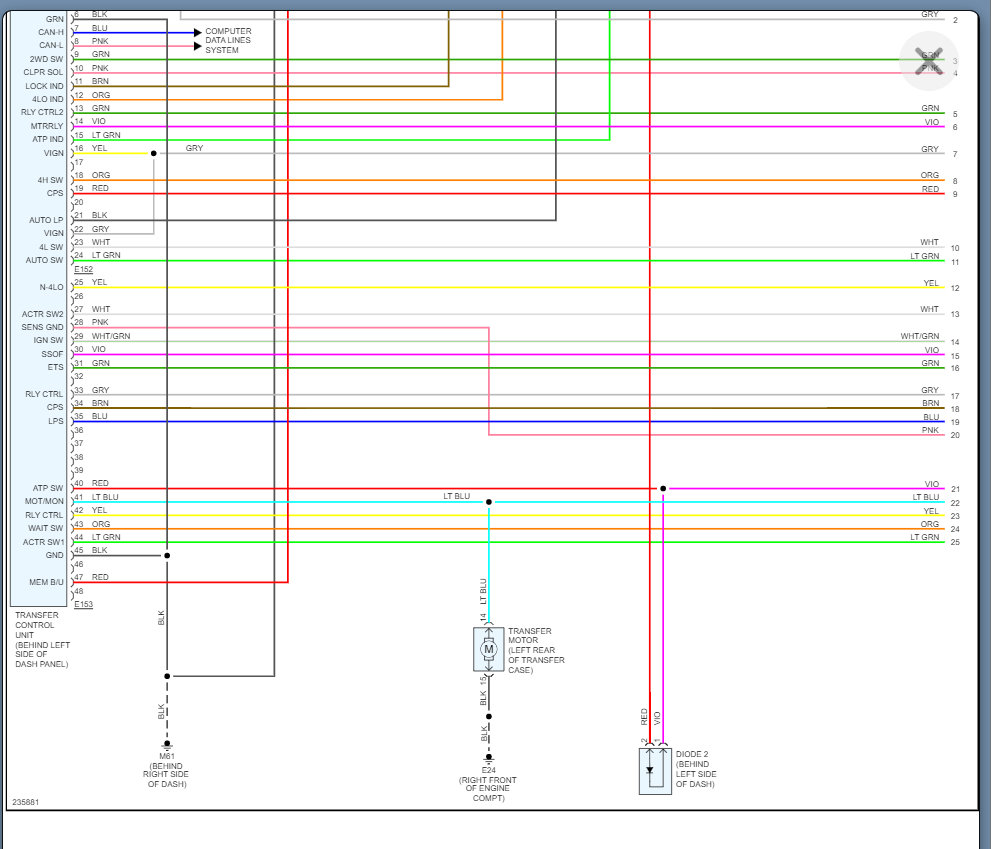

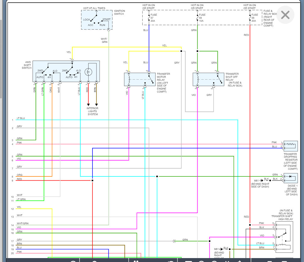

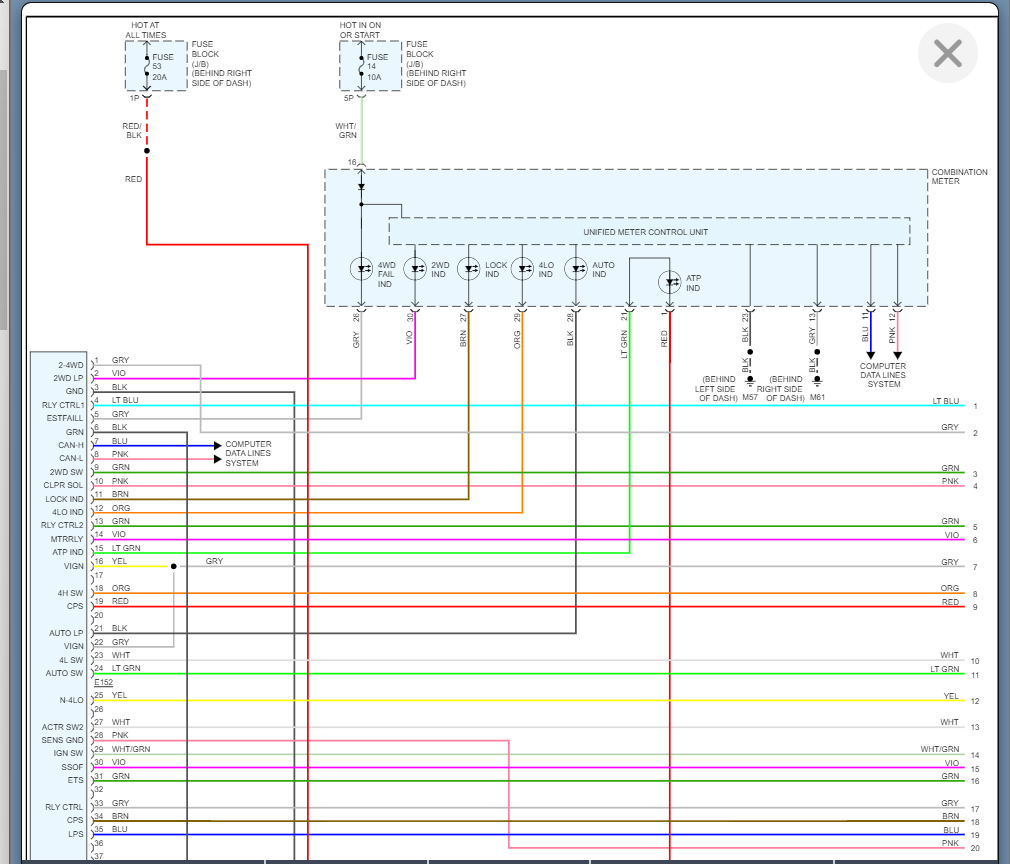

We need to start with finding out if it is ever actually going into 4WD and then back out. If the indicator is truly flashing for 6 minutes before it shows 2WD then that is not normal.
It sounds like we have a possible actuator issue, but we need to check the voltage going to it and make sure we have proper voltage.
If we do, then I would replace the actuator.
I attached the wiring diagram below which will help with this so let me know what questions you have, and we can go from there.
Thanks
