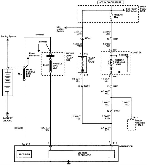

I need an electrical diagram that will cover the charging system.
Monday, January 15th, 2018 AT 5:22 PM
21 Replies
CJ MEDEVAC
  • 11,005 POSTS
This work for you?
See the diagram from Alldata below.

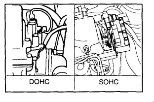

CJ can you please! Send me the exact location of the (crankshaft position sensor) on a 1996 Hyundia Accent SOHC 1.5 liter? I Googled it but nothing seems to come up. Thank you my friend.
Tuesday, January 23rd, 2018 AT 3:01 PM
CJ MEDEVAC
  • 11,005 POSTS
Okay boss.
Look right?
The Medic
Tuesday, January 23rd, 2018 AT 5:26 PM
CATAFINA
  • 98 POSTS
CJ you sure it is the CPS? That one there shows it is the camshaft position sensor to the right that you gave last time and fix the wiring. Do not know if this vehicle has both the crankshaft and cam sensor. Can you check please!

CKP
okay
not
CPS
It is one of those abbreviation obstacles.

Try this one out Raz.
The Medic
Wednesday, January 24th, 2018 AT 5:42 PM
CATAFINA
  • 98 POSTS
The last image you gave hit it, change out and it ran like a jack rabbit. Thank you very much my friend.

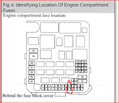

CJ buddy-can you give me the alarm fuse location on a 2008 Mitsubushi Outlander? Pretty please! Thank you-buddy.
Monday, October 8th, 2018 AT 2:48 AM
DANNY L
  • 5,648 POSTS
Hello, I am Danny.
From what it looks like it is located in Fuse #9 location. I have attached a few pictures of its location, and a tutorial for you to view. Hope this helps and thanks for using 2CarPros.

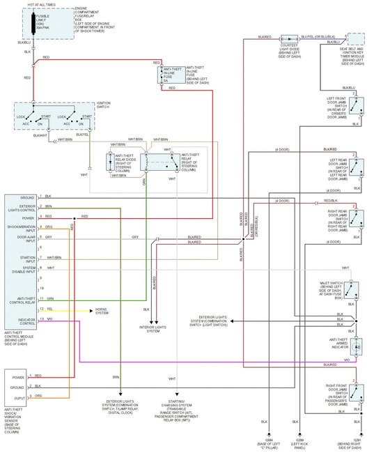

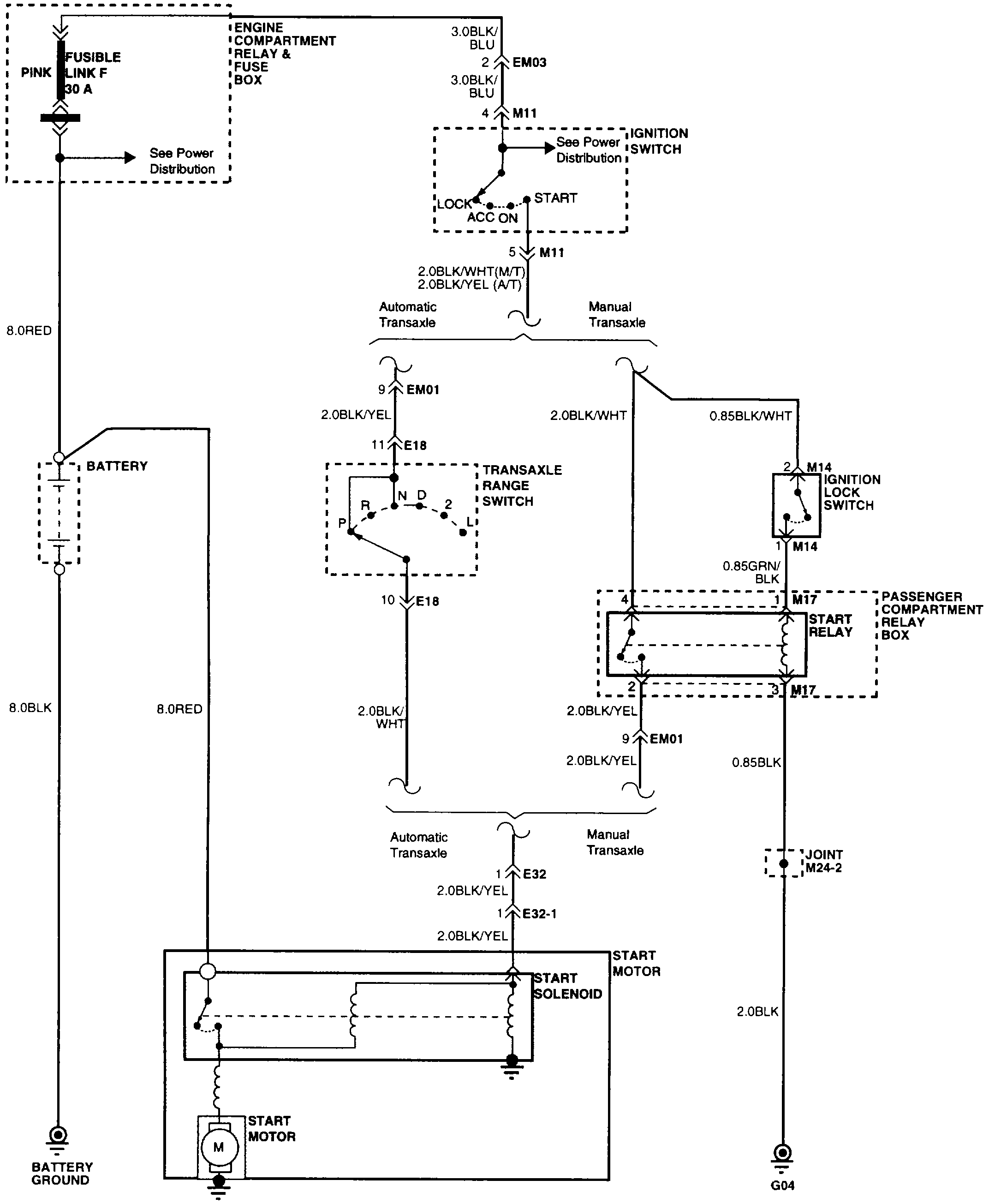

Dan, can you give me the exact location on the theft alarm relay? My car will not start it is an 2008 Mitsubushi Outlander. Tried resetting the system but no-go. Could it be a key fob that has a bad/weak battery causing it not to start? Thank you my friend.
Monday, October 8th, 2018 AT 2:45 PM
STEVE W.
  • 13,556 POSTS
Weak battery in the fob should not be an issue as that does not power the recognition transponder. Is the security light on while trying to start? What does it do while you attempt to start the vehicle?

No it is not, only when I lock all doors it comes and stay on. Also it has a light with a key and in the middle it has an exclamatory point what does mean? Been trying to figure this out a long time. Security light does not come on when am attempting to start. Thank you

It starts sometime when it feels like it. It is puzzling where the problem could be. Lets try to figure this out. Where is the BCM and Immobilizer? At one time I was answering questions, now am doing the asking for help. Lol

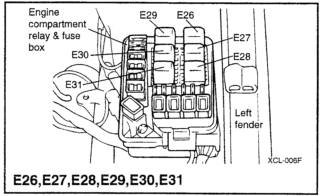

Also can you provide me the location of the starter and horn relay?
Saturday, October 13th, 2018 AT 8:12 PM
STEVE W.
  • 13,556 POSTS

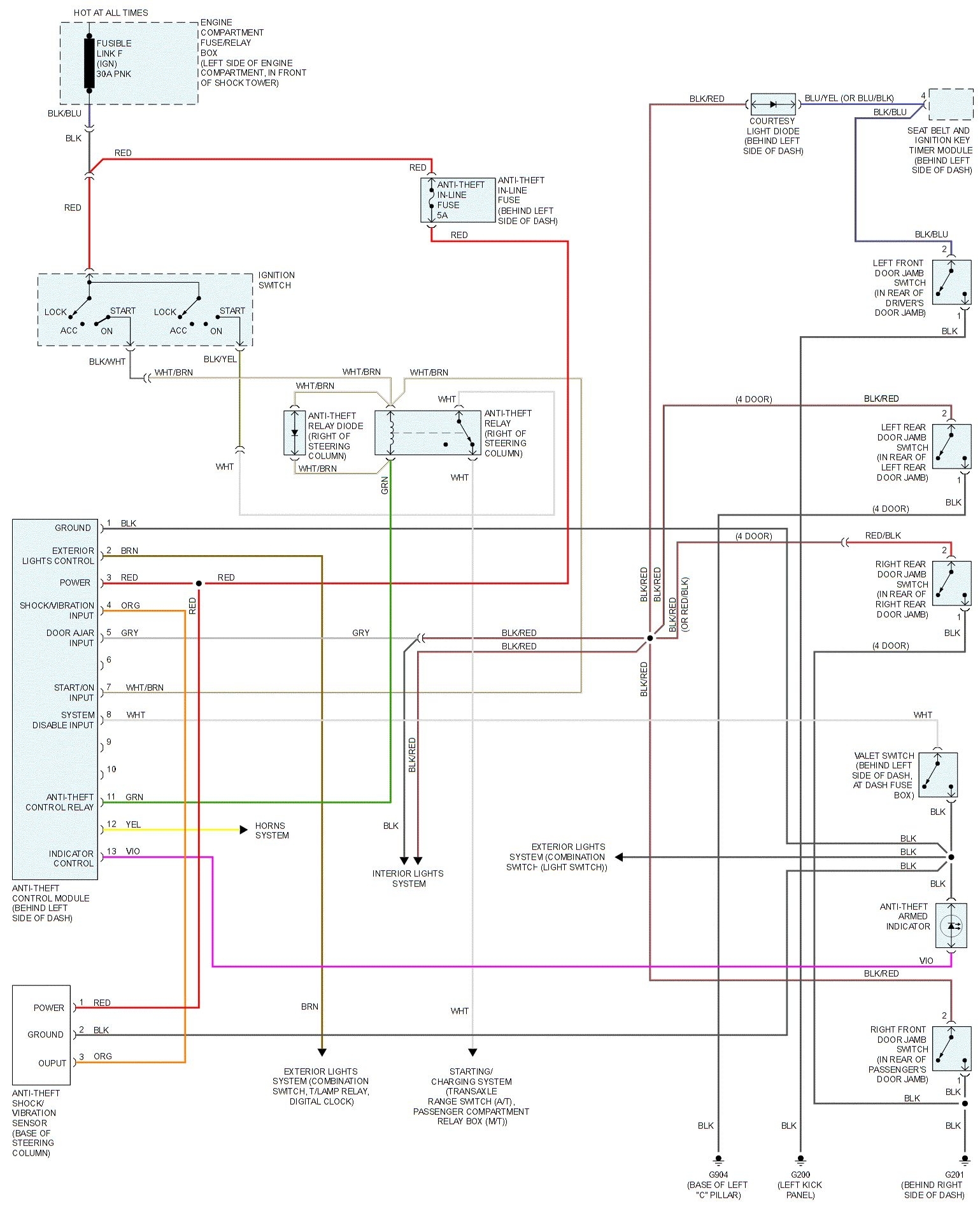

From the additional information it sounds like a bad connection in the starting circuit. The alarm seems to be operating correctly and it is detecting the key as the light doesn't stay on or flash when you attempt to start it. The key light means there is a problem in the starting circuit as well. Being an automatic it doesn't use a starter relay other than the one under the dash that is part of the anti-theft. If it has a bad contact it could still detect a good key and disarm but it may not start.
Below I attached the starting circuit and relay box. E29 is the horn relay.
The antitheft is the last image.
