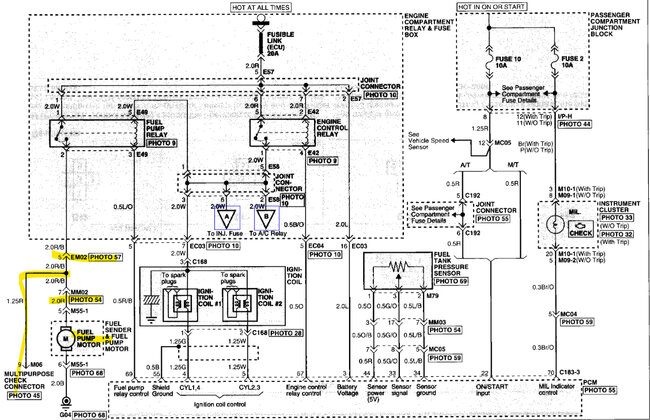

The car listed above caught fire and melted all the wording hoses and belts. Suspension and front end melted too. Since then I've replaced the belts hoses and put a whole wire harness in. It's also got another ECM because i figured that when it melted it shorted out something. And the front end has new CV axles and struts. I was checking fuses, and the hazard light fuse was blown. When the car caught fire the hazard lights were on. So, the switch was on. Now when I put a good fuse in the hazard light fuse spot the fuel pump would come on without the key in it. I hooked the switch up and turned the hazard light off and now the fuel pump will not come on with the key. I checked the pump, and it works, and I've got power to the relay under the hood. I'm stumped.

Hello, that sounds like quite the event. It sounds like you powered up the fuel pump yourself with an aux power source. And at the fuel pump relay location how many of the pins have power with the key on?
And what tools do you have, scan tool, multimeter etc.? Does the Fuel pump come on with the Hazard switch on now with it hooked up and a new fuse?

I didn't check the relay with the key on. I got power to one pi. In the relay box under the hood. My scan tool is reading po885 code. And I took the pump out to check it with straight wire. I checked for power at the harness connecter box the pump but nothing. I will check for power with the key on at the relay box when I get home. I'm at work right now. And yes, it is quite the event. Spent too much money on parts for this thing to still be sitting a d not running.

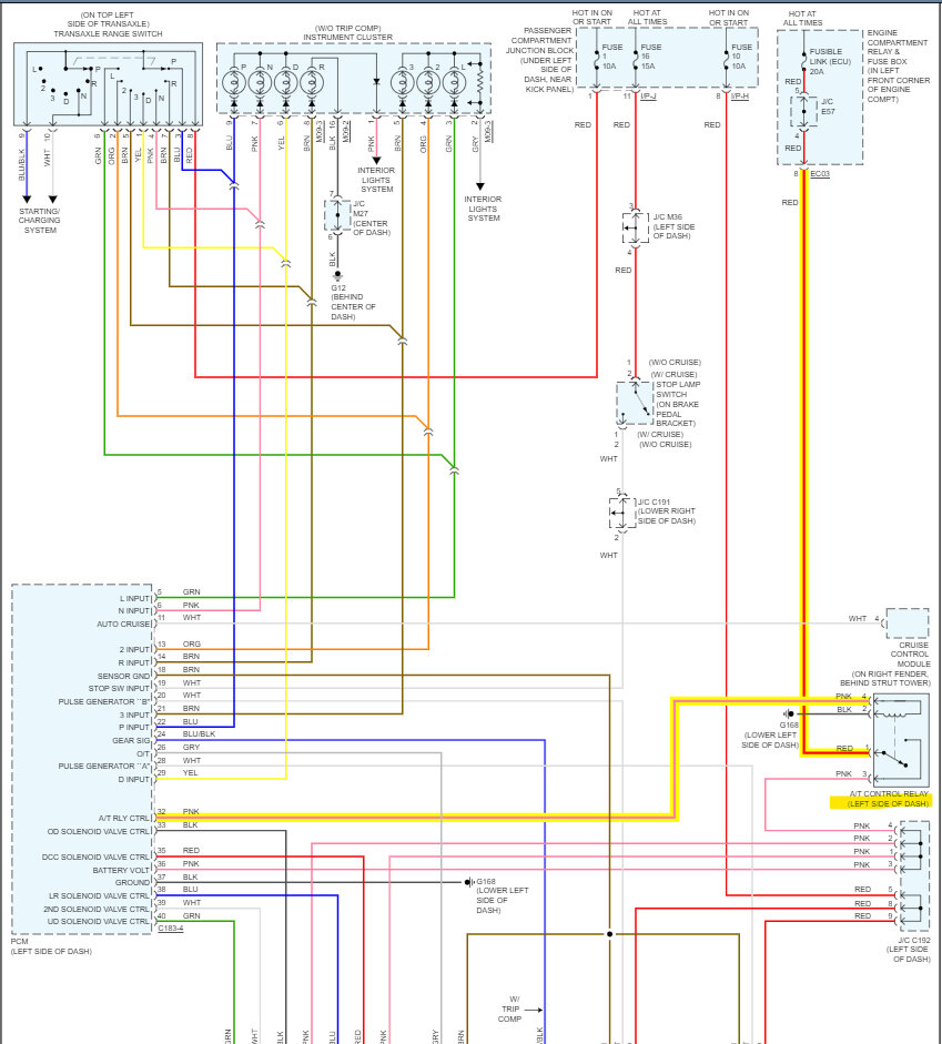

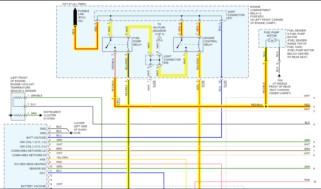

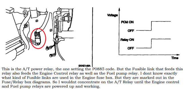

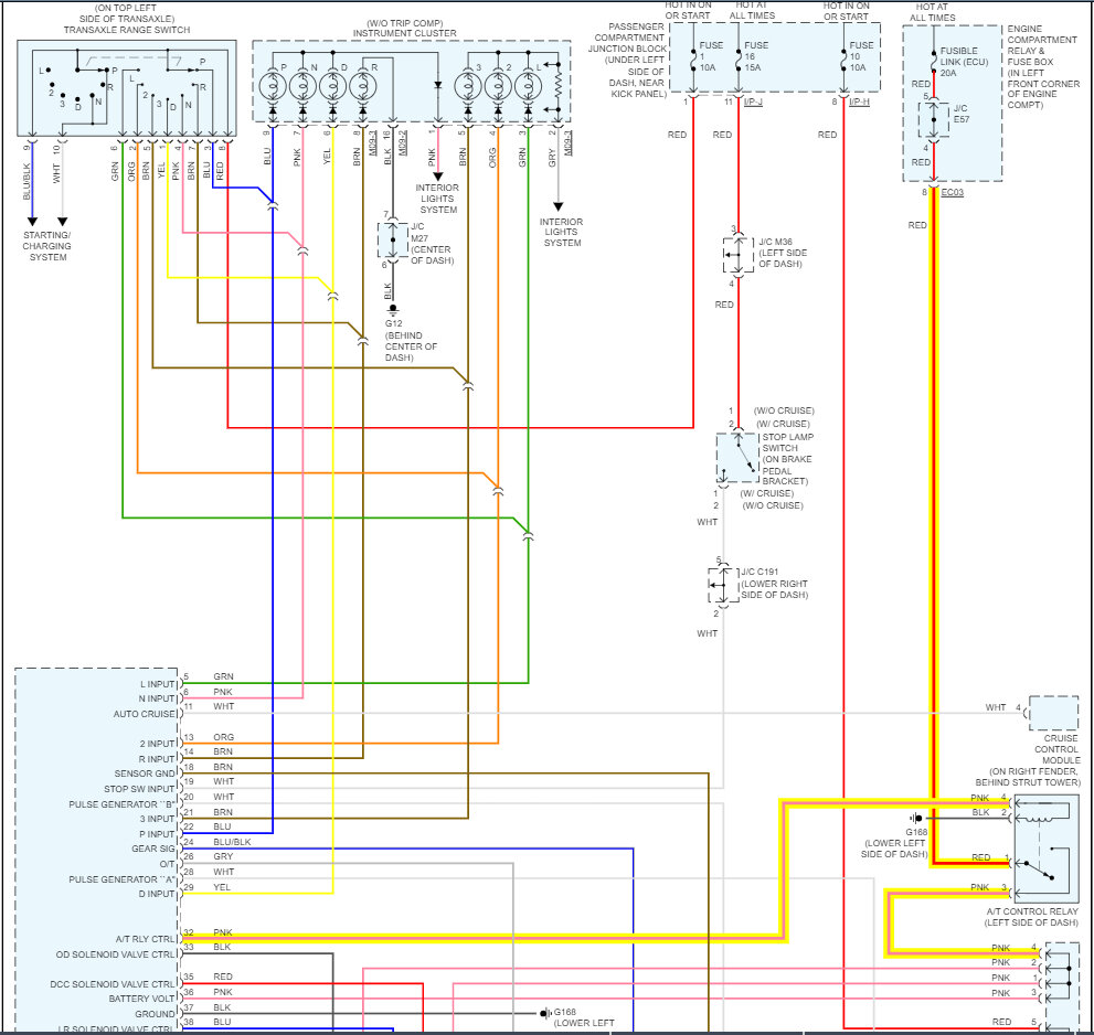

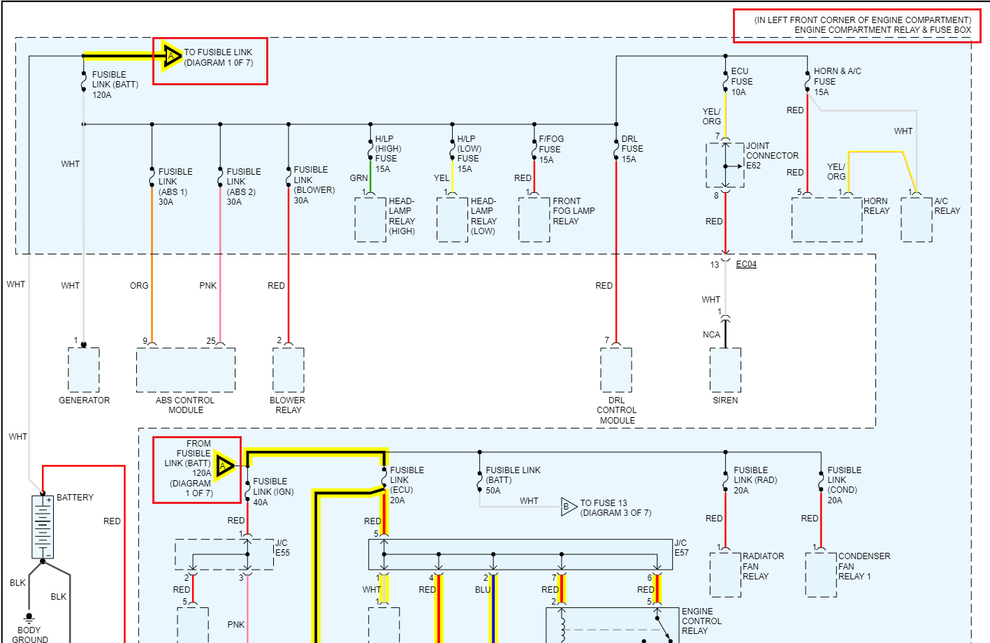

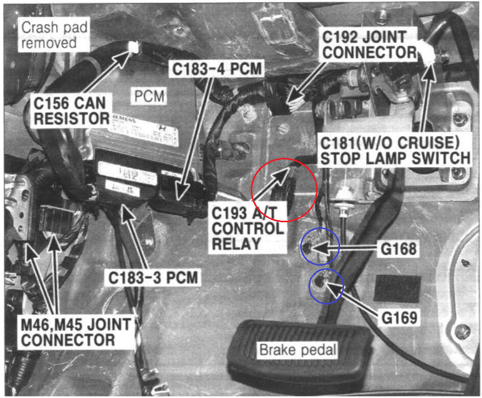

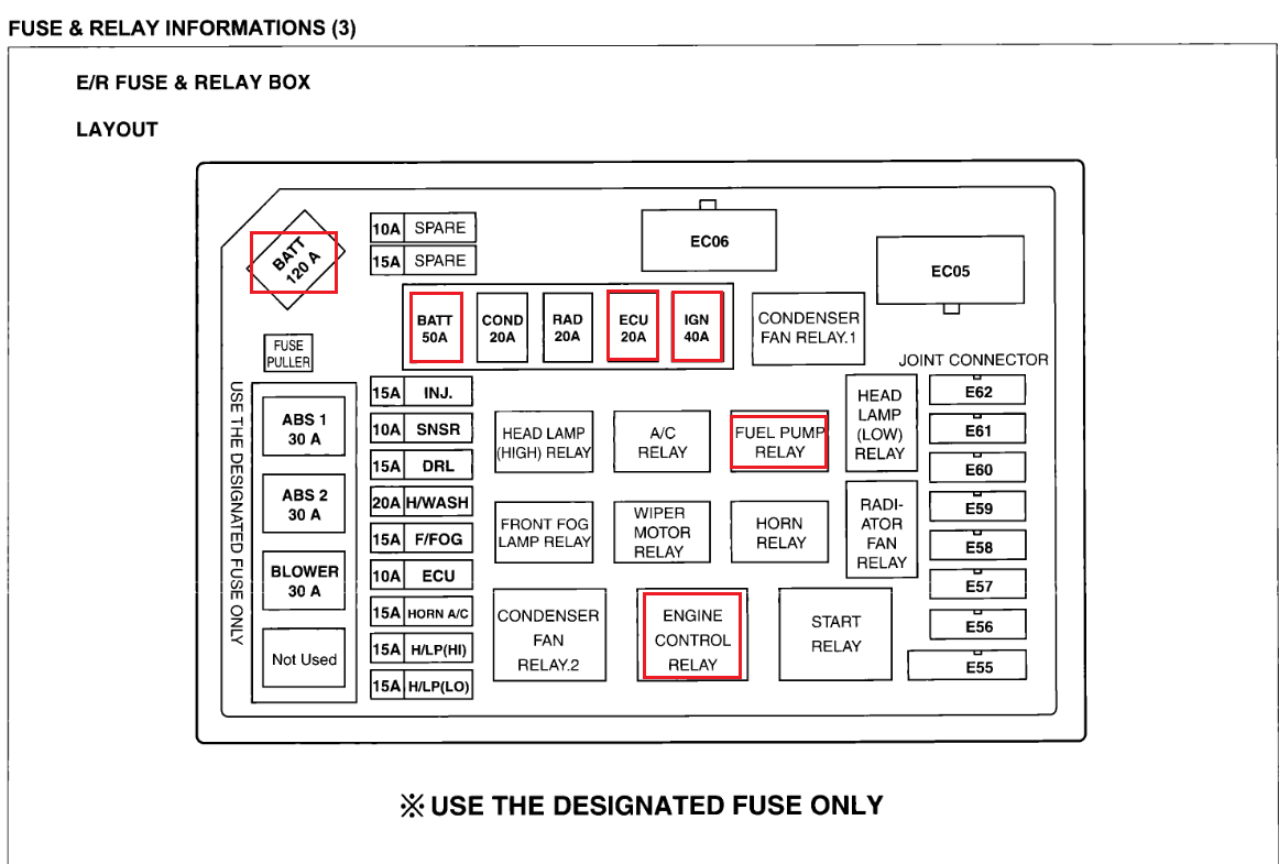

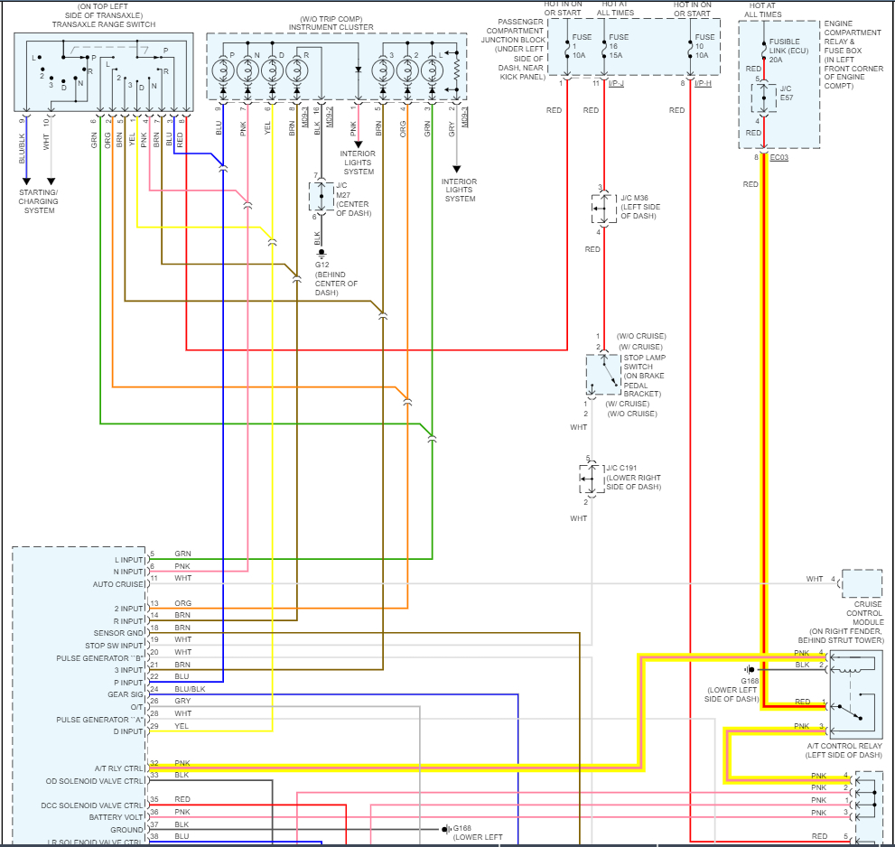

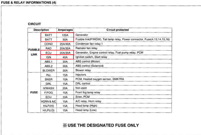

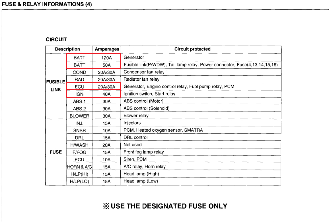

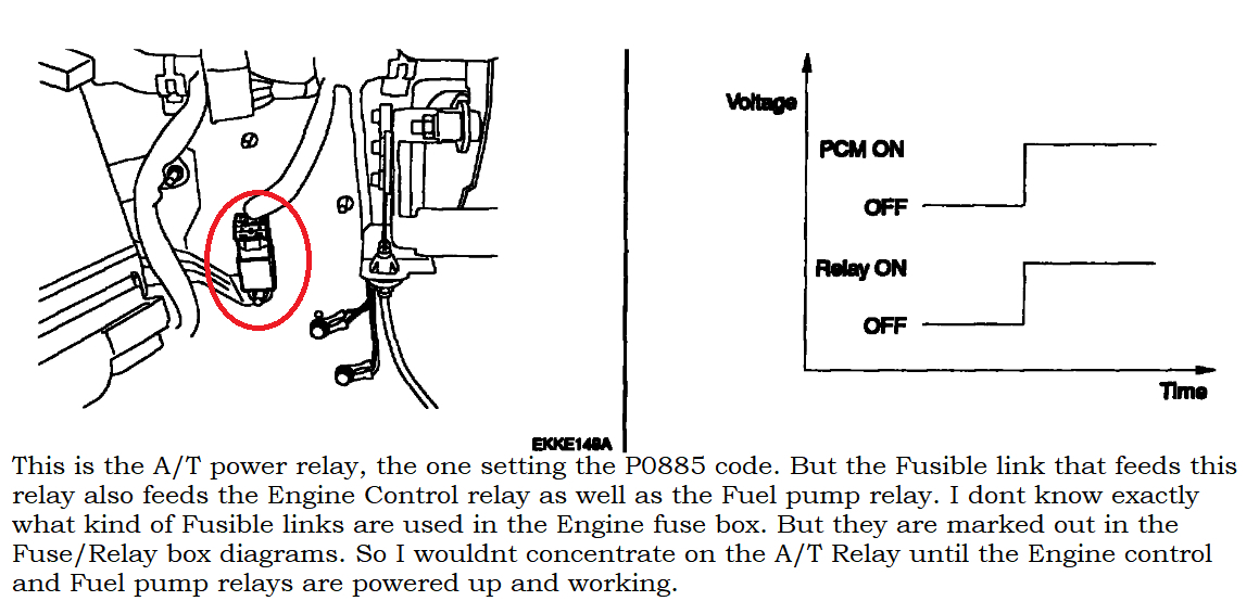

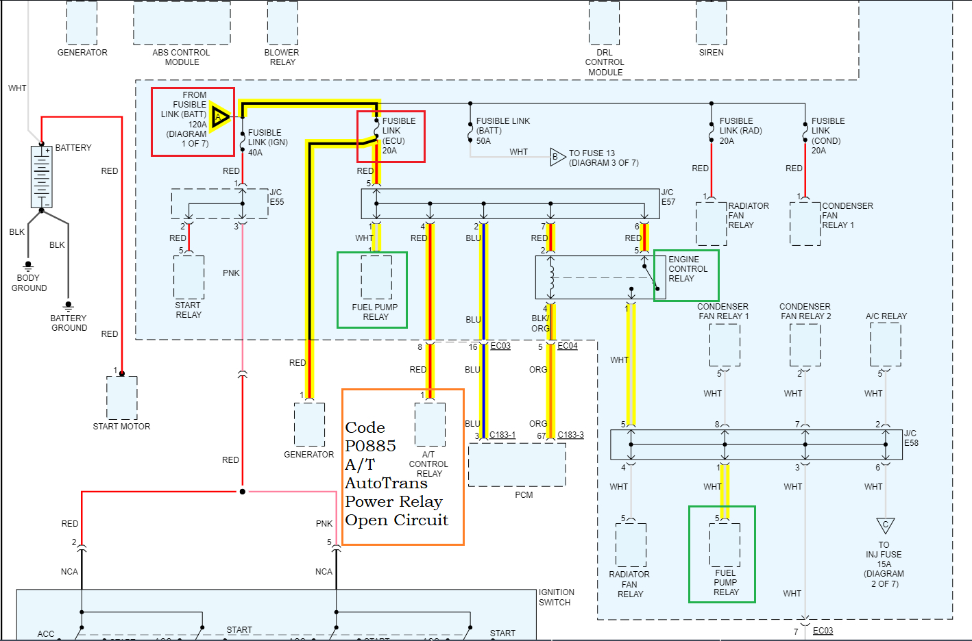

Here are all the diagrams you should need; it sounds like power is missing from one or more Fusible links. They are marked in the Fuse Box diagrams, although I don't know what type of fusible links they use in this model, they may have a plastic cover over them. The A/T power relay in under the driver side dash as you can see in diagrams 6,7. Also when checking the Fuel pump, never power it up dry, that will burn a fuel pump out quick. So only run the pump while in the tank.

So, you're not getting full voltage back to the fuel pump, can you check it with a multimeter and see how much voltage you're getting. And when you checked the fuel pump connector did you put the test light in place of the fuel pump at the connector, using the fuel pumps ground to ground the test light or did you ground at a different location?
With a fire like this, there could be any number of locations where circuits shorted out, even shorting power right through the PCM.
And does the Start fuse have a number with it, most of these wiring diagrams are only showing numbers for fuses.
Did you replace all the relays and fuse boxes in the engine compartment after this fire?
What does come on with the key at this point? Does it crank over, and do you have spark?

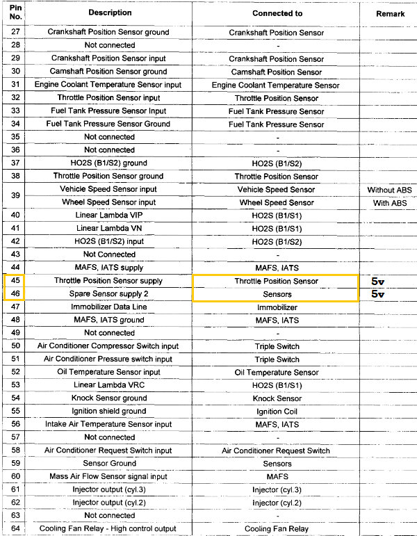

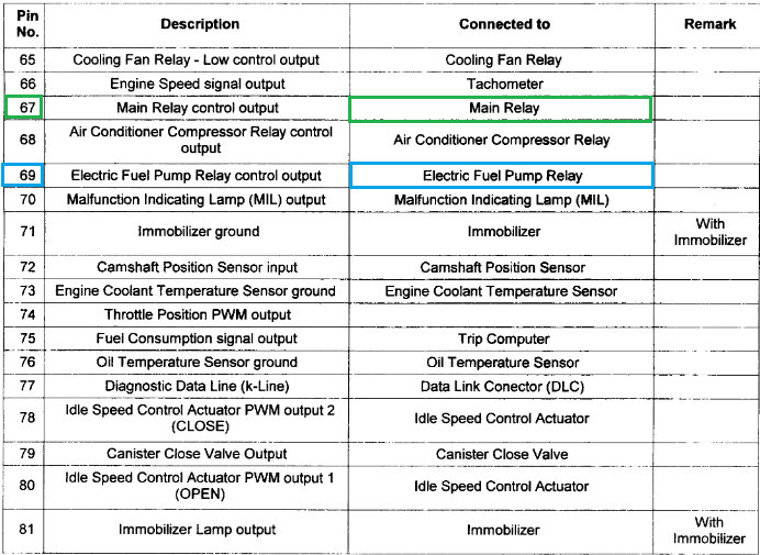

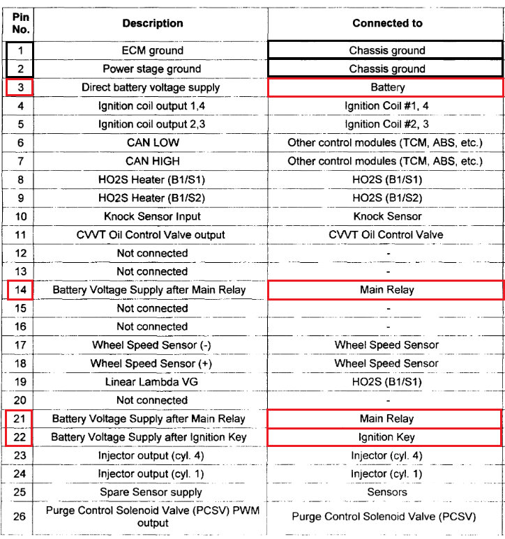

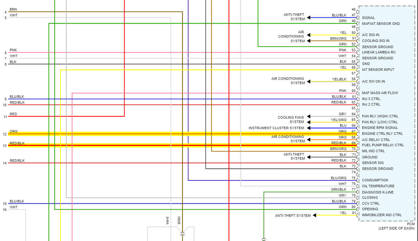

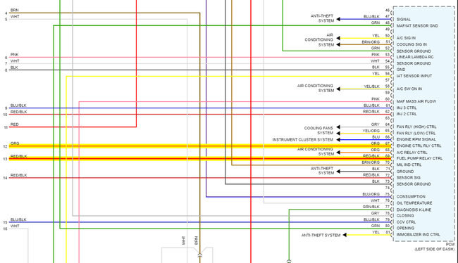

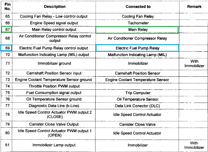

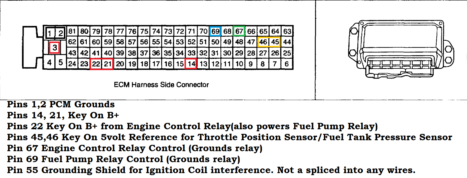

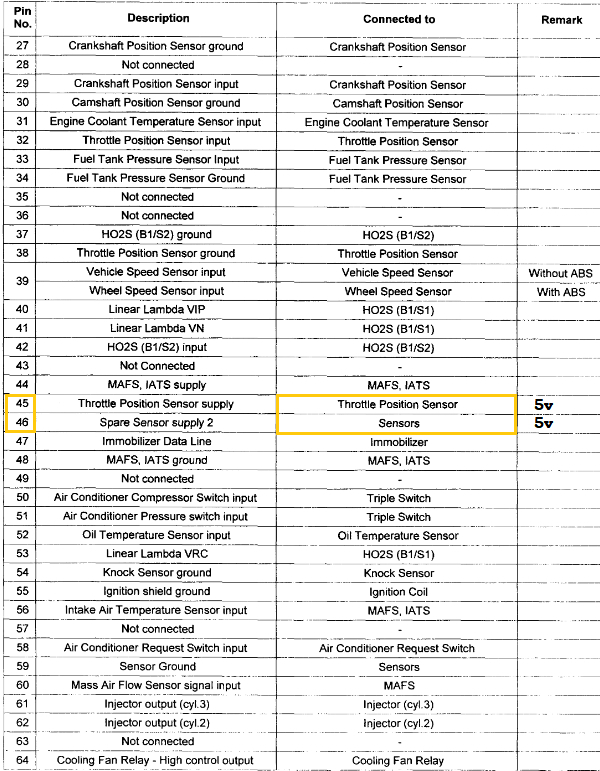

Here is the PCM connector pinout, to verify that power and grounds are good for the PCM, also check that there are two 5volt References.
Pin 67 is the wire that the PCM grounds to activate the Engine control relay and pin 69 is grounded to activate the Fuel Pump relay.

Yes. When I changed the wire harness, I also changed the fuse relay box. The motor will turn over and I've got spark to the plugs. and I've also replaced the ECU with another. When I tested the connector at the fuel pump, I grounded it to the battery and tested it.

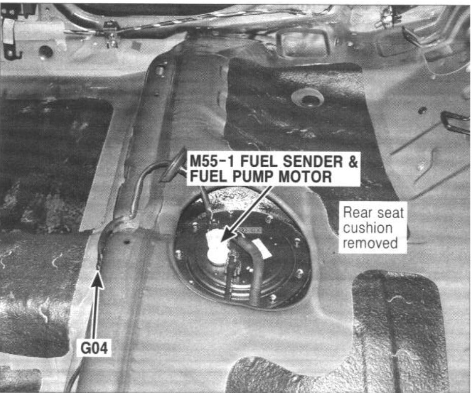

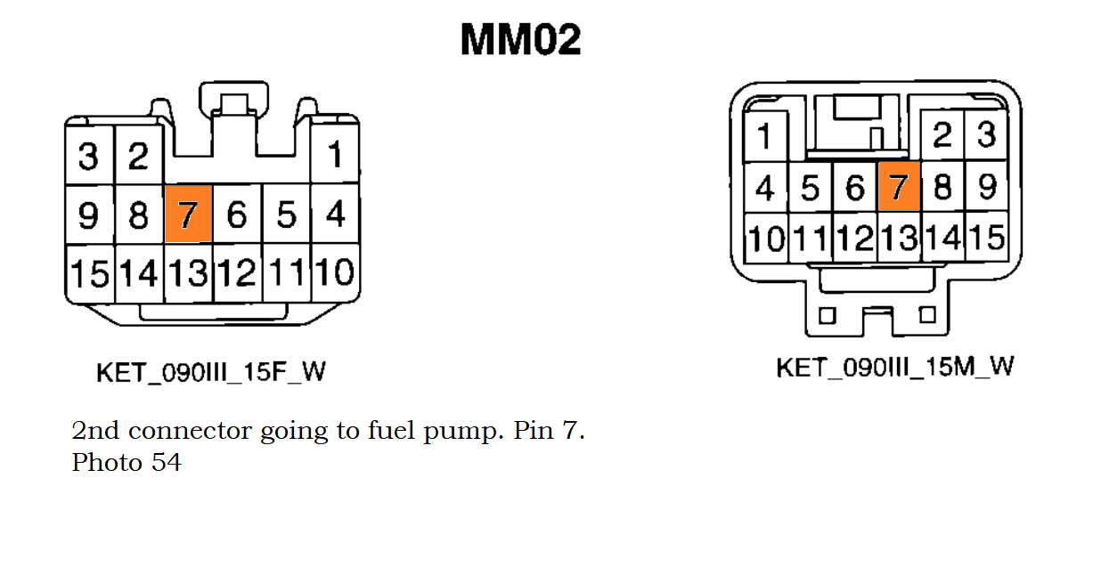

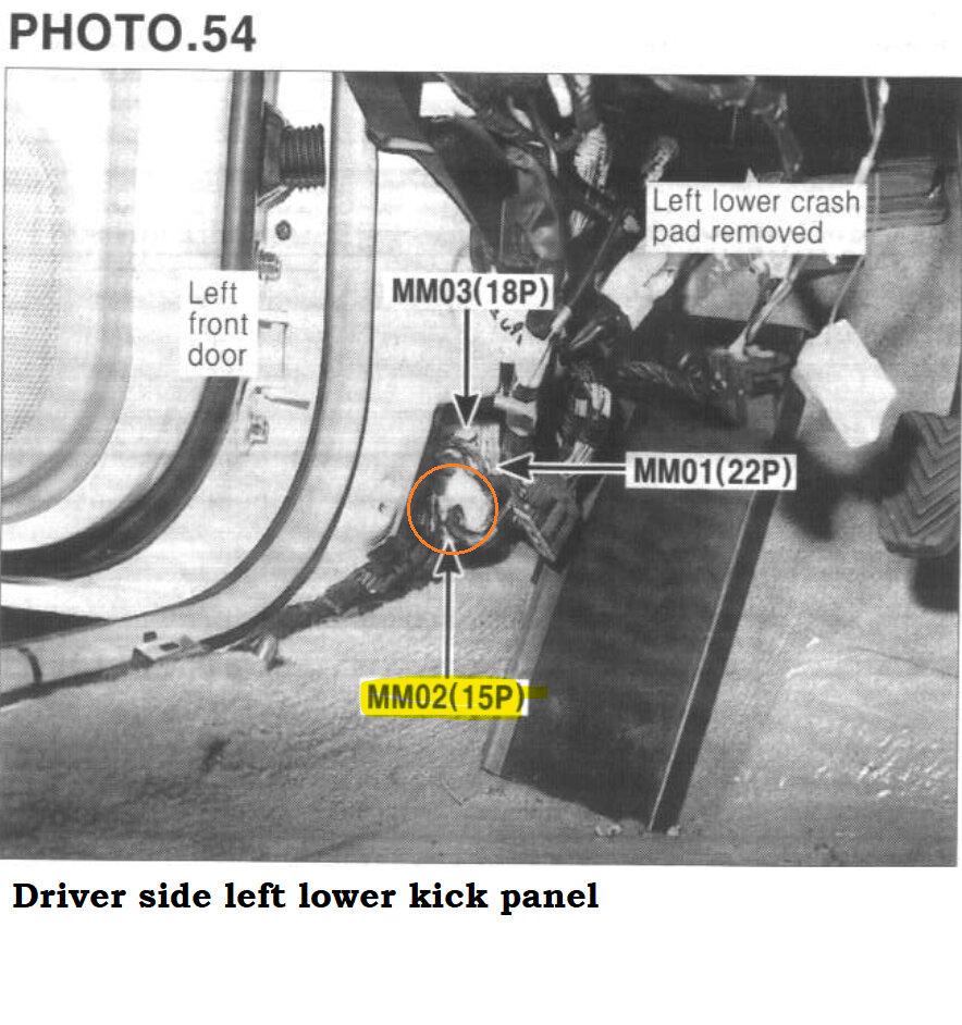

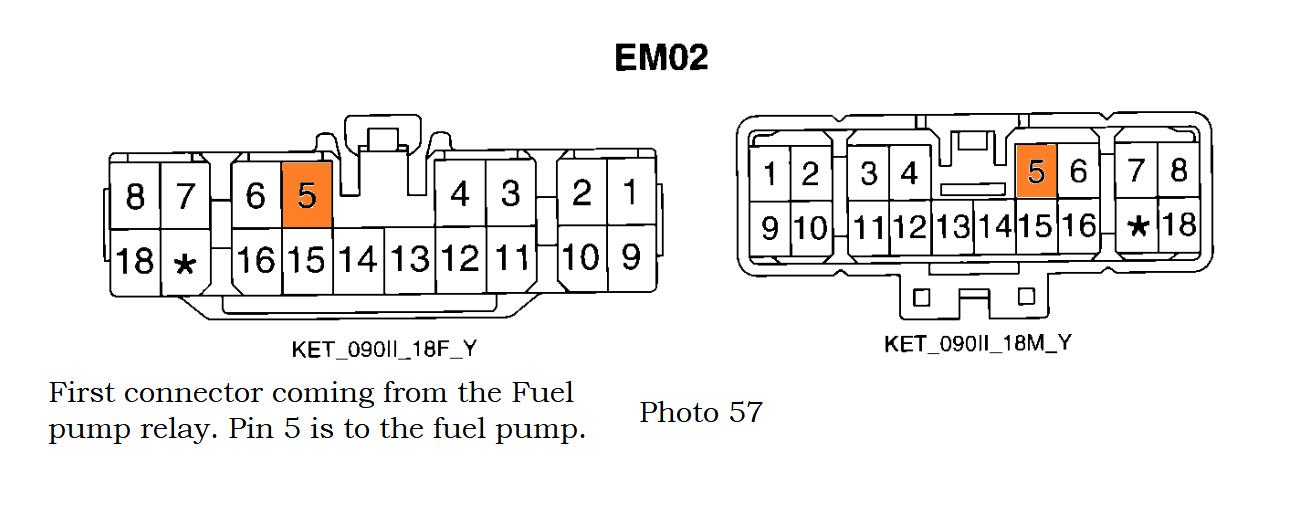

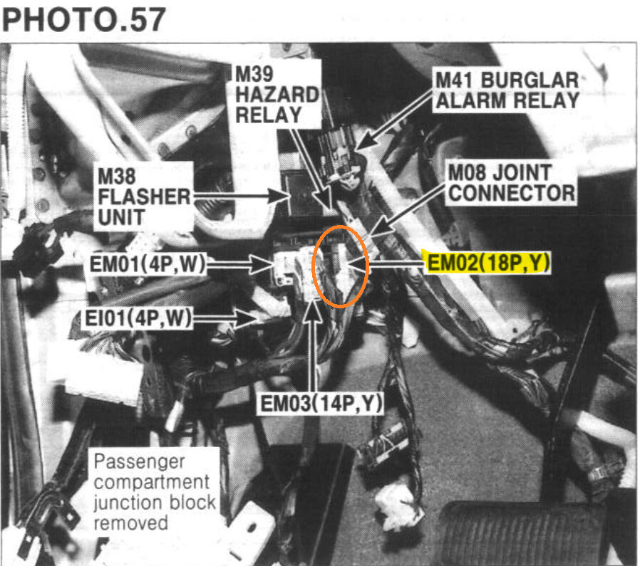

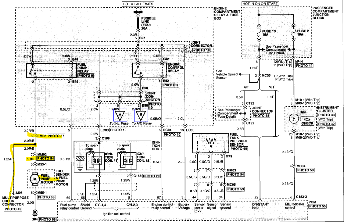

So, you've got a low voltage issue on the feed from the fuel pump relay to the fuel pump connector. It looks like there are two connectors on the fuel pump positive wire, EM02 and MM02 with a multipurpose check connector in between those two connectors, I'll see if I can locate both of those connectors. There are supposed to be photos of them as well.
Both the connectors are down on the lower drive side. Connector EM02 looks to be for the Passenger compartment junction block. So, checking the MM02 connector behind the driver side left kick panel for a full 12volts will be faster since it's further down the circuit towards the pump.

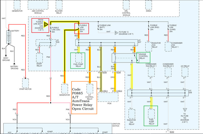

I think I grounded the a/t relay. I hooked up my scanner and it was showing a p0885 code but since I grounded the relay it is now showing 0 dtc with a yellow led light on the scanner. But I harvested the voltage for the fuel pump connect.

The TCM relay is always grounded, it's a power fed relay, so the PCM supplies power to the relay to activate it. The PCM controls the transmission and engine in this vehicle. What do you mean by harvested voltage for the fuel pump? Did you find a location where there was a bad connection? You should be okay with the new PCM, as long as it's programmed to the VIN, if the fire was enough to melt the front-end suspension, I'd be concerned about the old PCM as well, I know they are not located in the great place in the engine compartment on these vehicles. The new PCM should be clear of codes unless it's seeing any circuit faults when you turn the key On. Other faults it will detect when the vehicle is running again, so we'll deal with those once it's back up and running. Can you get a voltage reading at the fuel pump connector with a meter, so we know how much voltage is back there?

Okay, I tested em02 and mm02 with my multimeter. And both with the key on are showing no voltage. I also tested the connector at the pump, and it also shows no voltage. So, what does that mean? And I also double checked the voltage with the key on and it's showing 12.6 or so volts with a standing battery. Good hot battery.

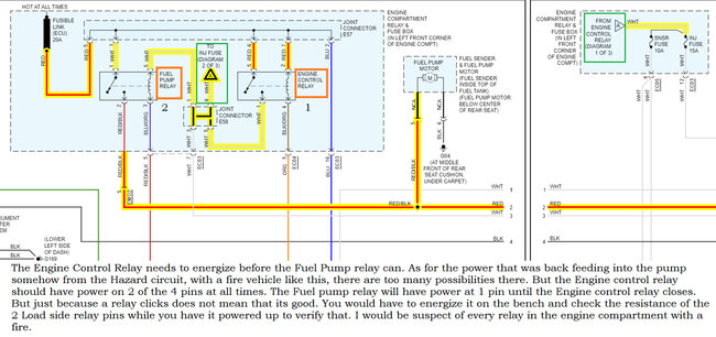

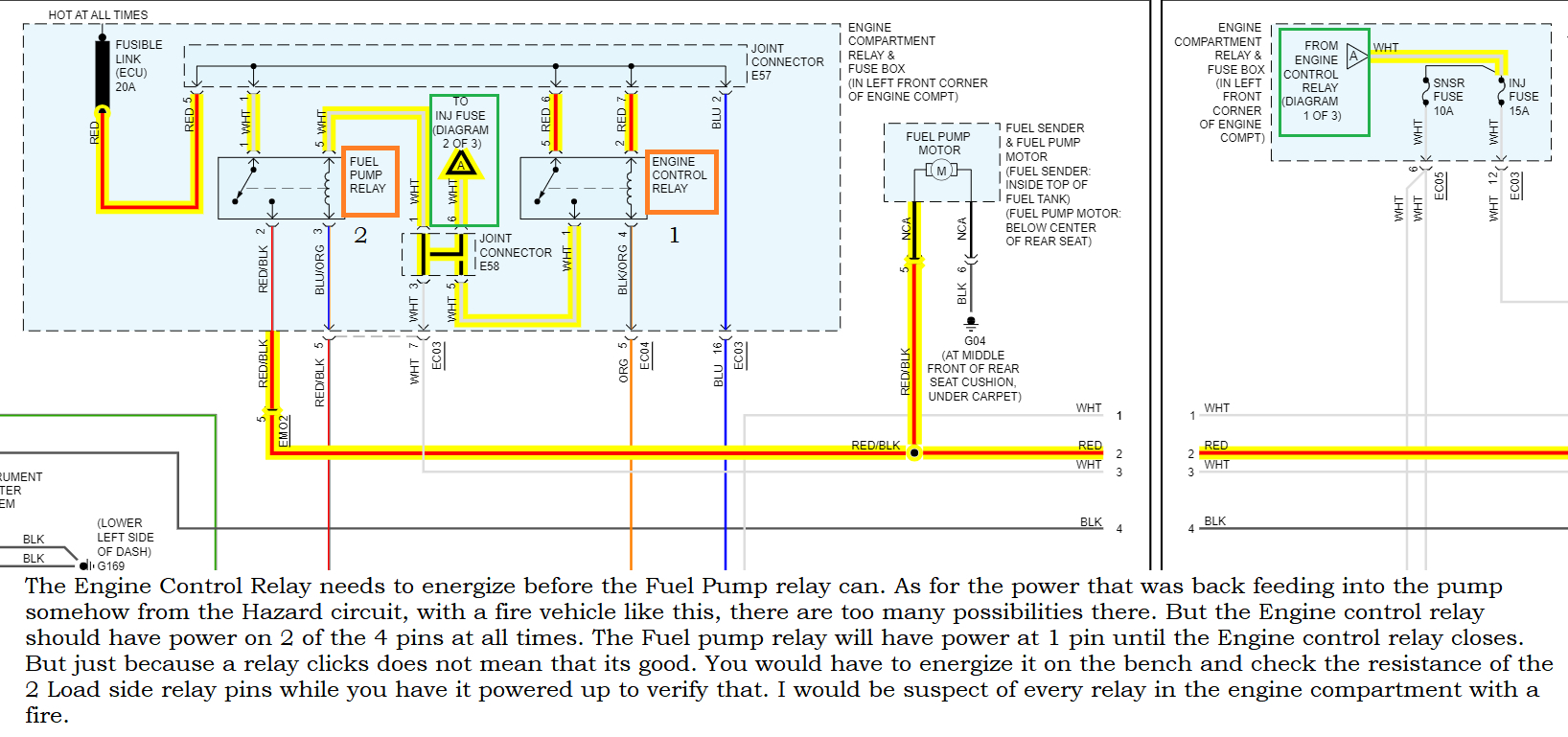

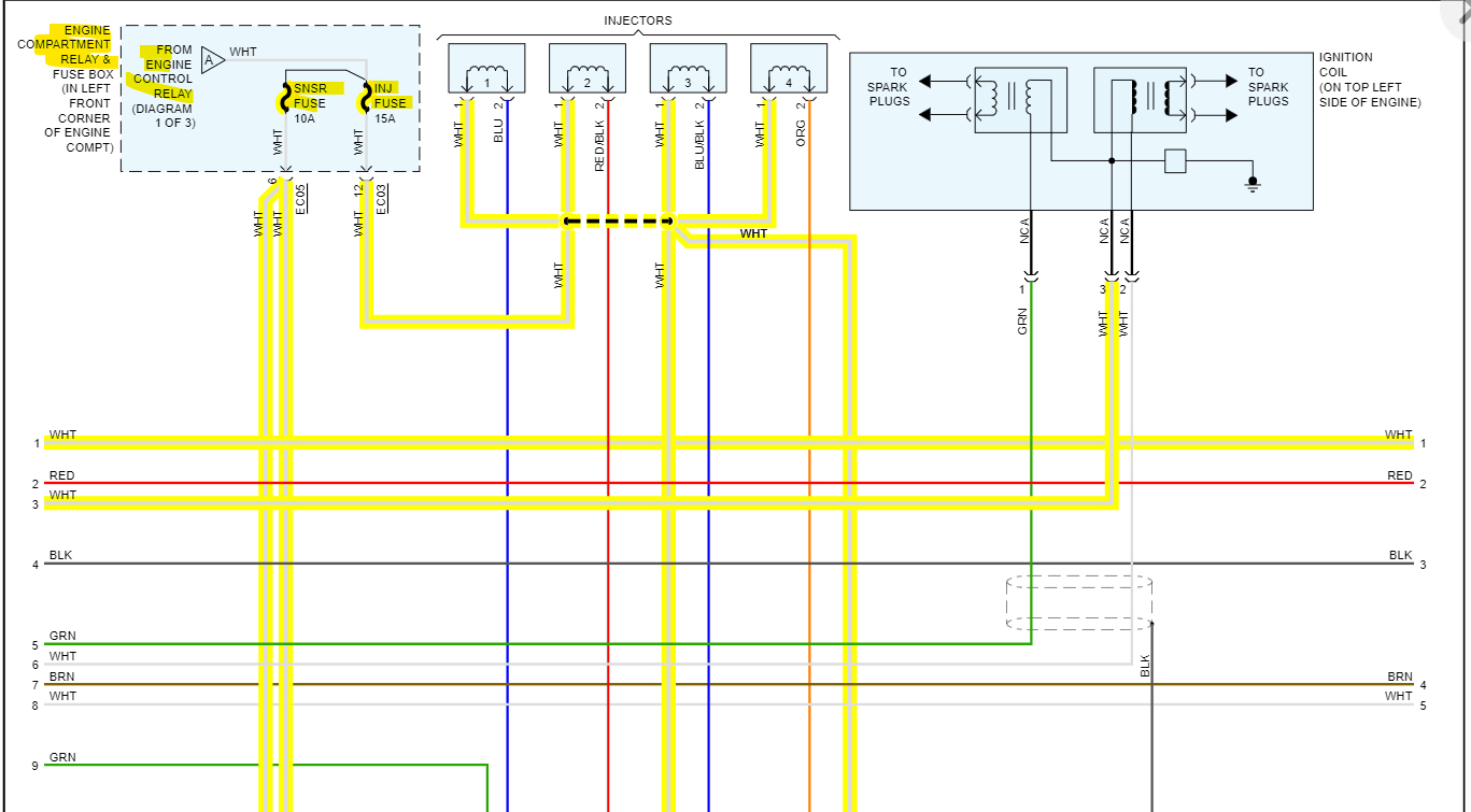

Okay, the EM02 connector comes directly from the Fuel Pump relay, the control side of the relay is powered up after the Engine Control Relay is powered up, the PCM is responsible for grounding both of them. The engine compartment relay and fuse box have the Fusible Link 20amp the provides power to both relays on the load side. So, it can be either you have a bad fuel pump relay, a bad Engine control relay, or some issue with the control sides of these relays. If you pull out the Fuel pump relay there should be power on 2 of the pins in that location with the key on, there should be power on 1 pin of the Fuel pump relay location all the time, as well as 2 of the Engine Control relay pin location all the time. So, if you are missing any of those 12v feeds to those relays, then there might be some corroded pins on the underside of the relay/fuse panel.
In the engine compartment they tend to corrode and break off due to exposure to the elements.
If the Engine Control Relay is not working, power will be missing at the SNSR Fuse 10amp and INJ Fuse 15amp. Those fuses feed power to the Injectors and ignition coils. So, checking power at those fuses will tell you right away if the Engine Control relay is at least sending power to those fuses. You can see there is a joint connector between the 2 relays, so there could be an issue in that fuse box. but check for power at 2 pins of the Fuel pump relay with the key on.
Also check the Engine control relay pins for power 2 of them, hot at all times.

AL514
  • 5,664 POSTS

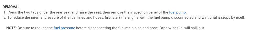

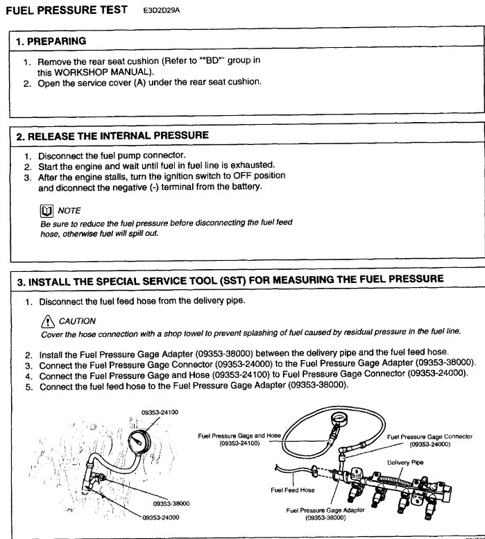

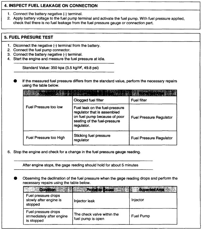

Okay, then power should be coming from the Engine control relay, so it might be a bad fuel pump relay. EM02 should have power while cranking which will energize the pump. I don't see in service info if there should be more than a 2 second fuel pump prime at key On. To test the fuel pump, service info states to apply battery power to the pump, so I would assume you'll only have power to the pump for 2 seconds at key On, and then while cranking. Here is the service info on pressure testing.

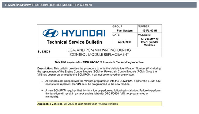

A few posts back you mentioned that the PCM should be okay as long as it was programmed win the vin. Now I got the Parr numbers from the dealership parts department. And I ordered it off of Ebay from a used part dealer in California. Don't remember ever giving the VIN so . What's that tell me?
Oct 22, 2023 at 6:48 AM
AL514
  • 5,664 POSTS
Yes, a new PCM needs to be programmed to the current vehicle's VIN. For example if you order a remanufactured PCM from Flagship One, (which is a used module company) they will require the vin number and preprogram the PCM to that VIN, and in cases where the module needs security system information, they will bypass the security system and it will not be active anymore, but that is more for a BCM replacement, they do other modules besides PCM/ECM. There is TSB on this as well posted below. So, this could be the issue. Sorry if I didn't remember the used PCM. We go through so many different vehicle cases a day, sometimes I forget things unless I go back through that specific folder again.
If you have a higher end scan tool, some can do programming and data transfers to new modules.
But some of the lower voltages levels you mentioned though, still seem like there might be wiring issues, you had some voltages readings around 7-8volts, that still points to possible relay or connection issues. I thought you were going to also try the old PCM again? Did that change anything at all?
