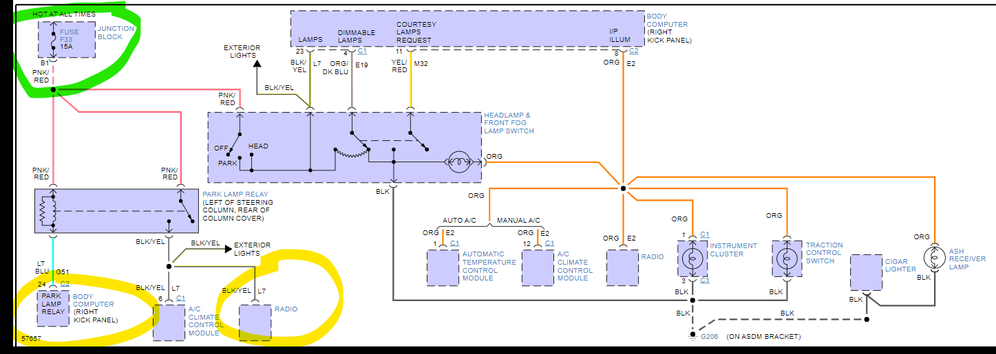

I had to remove my glove box from the dash and in doing so saw a spark come from the glove box closed button. Now my stereo deck and automatic locks don't work. I've checked my Clive box fuse box and found no blown fuses also behind my stereo deck fuse is good. I believe I read somewhere I might have damaged the BCM when it shorted, but not an expert on electrical systems. What should I check next? Thank you

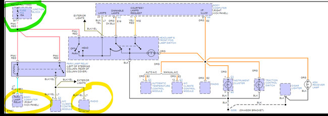

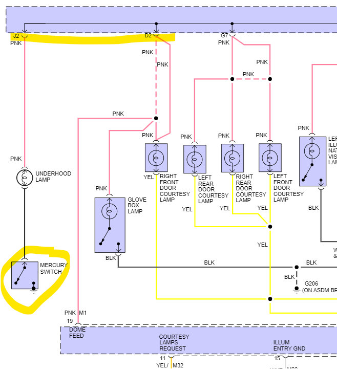

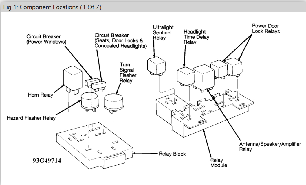

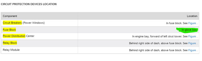

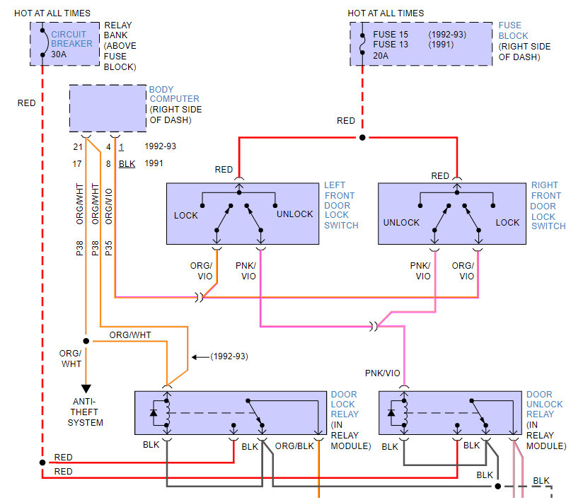

Hello, it's possible, but really the fuse for that circuit should have protected it. Did you remove the Fuses and actually check them closely, sometimes it's hard to see a blown fuse without a close look. Another possibility is in the third diagram you'll notice there is a Circuit Breaker, not a fuse. If that circuit breaker malfunctioned and didn't react to the short circuit, that could explain a damaged Body control module. Are there any other components in the car not working? I would think you would have additional failures.

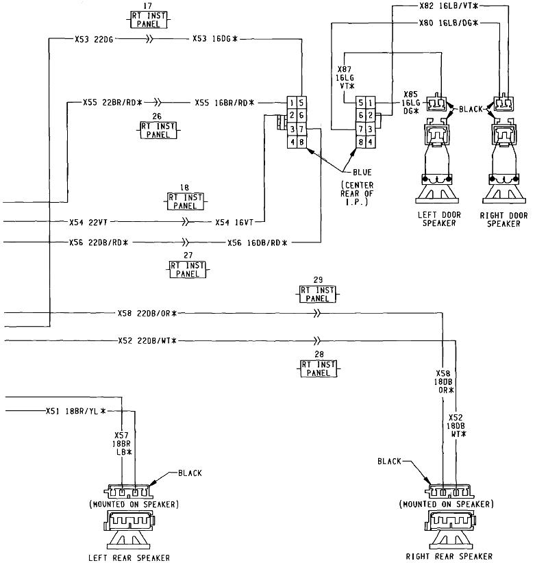

The Body control module controls the door locks, and the radio through different relays. In the second diagram you'll see the Body Control Module (BCM) Grounds the Park Lamp Relay to turn the relay on and the radio, but it also controls some exterior lighting and the A/C climate control module. Does the A/C work or any of the exterior lights not working?

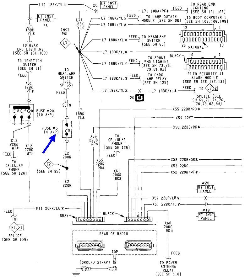

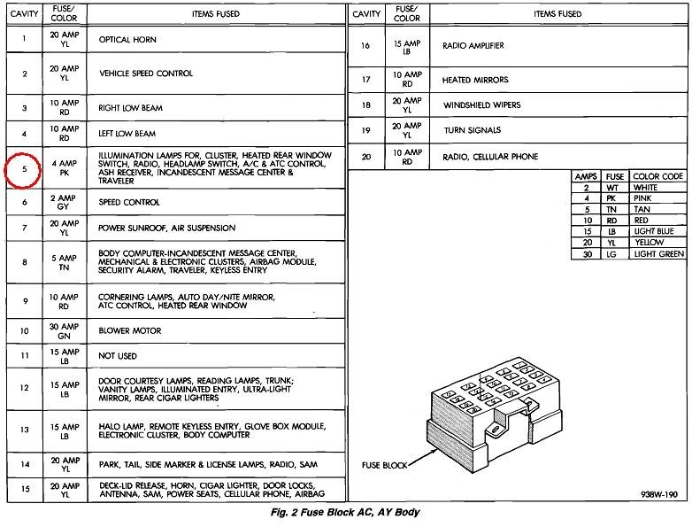

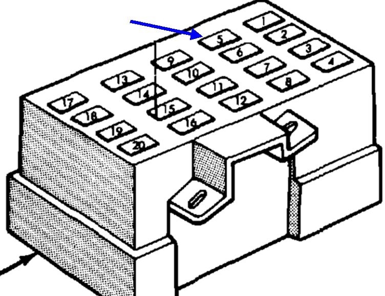

Double-check the fuse inside the glove box. Depending on the model number of the radio, they act differently when the fuse for the memory circuit is blown. Some work fine but revert to 12:00 and factory preset stations when you turn them on. Some tune normally but have no sound. Some will be totally dead. In almost all Chrysler products, that memory circuit is tied in with the interior lamp circuit, so there's no fuse labeled, "radio memory". Look for the "interior lights" fuse. In this case that's fuse number 5, a 4-amp shown in these drawings.
These diagrams are for the base radio system. The Premium system uses a remote-mounted amplifier, but the memory circuit is the same.

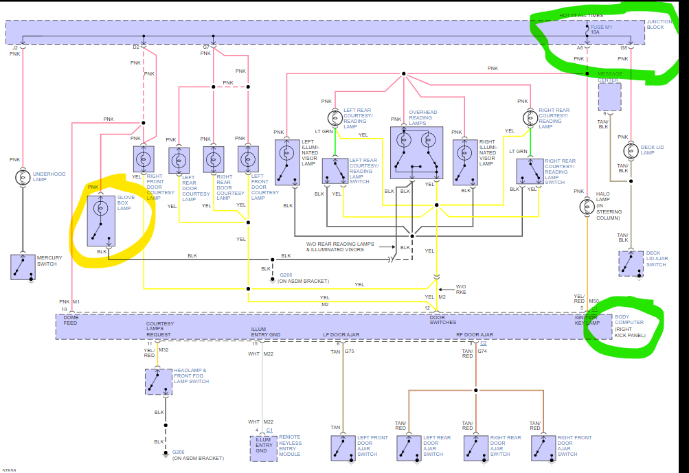

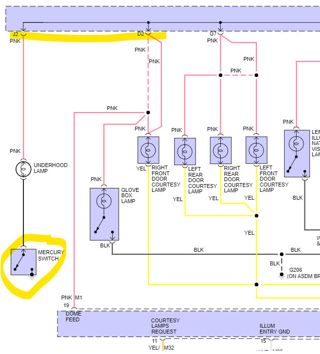

Can you unplug the glove box switch or take the bulb out? Disabling the circuit entirely and see if that restores any function. The hood lamp is fed by the same wire that feeds the glove box lamp. How did these wires spark to begin with? Are there loose wires behind you glove box just hanging there? All wires should have insolation on them to prevent them from touching any melted surfaces and shorting out. So, I would take a better look inside there and see if that pink wire burned up anywhere. It is possible that the circuit is still touching metal and that Circuit Breaker cannot reset because of that, it will just stay open circuit until the shorted wire is no longer over drawing current. That may be what's happening.
See the Circuit breaker in the top left in the second diagram, how it has a dotted line, which means that there is more to the circuit, it's just not shown.
