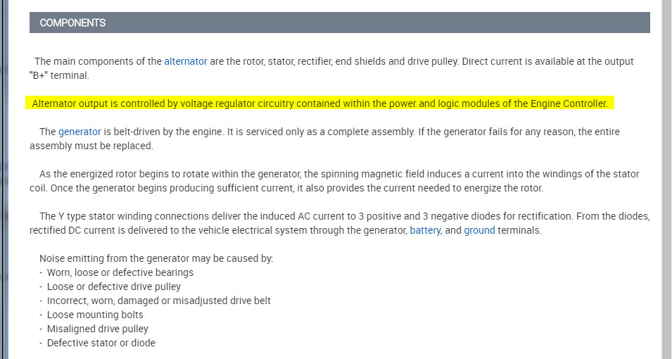

More then likely this is the voltage regulator which is contained in the PCM.
The way to confirm this is to measure voltage on the dark green wire from the PCM. I suspect the regulator is not operating properly which is why your voltage is erratic.
Unfortunately if it were me, I would go with the PCM at this point.
Take a look at this info and we can go from there. Thanks

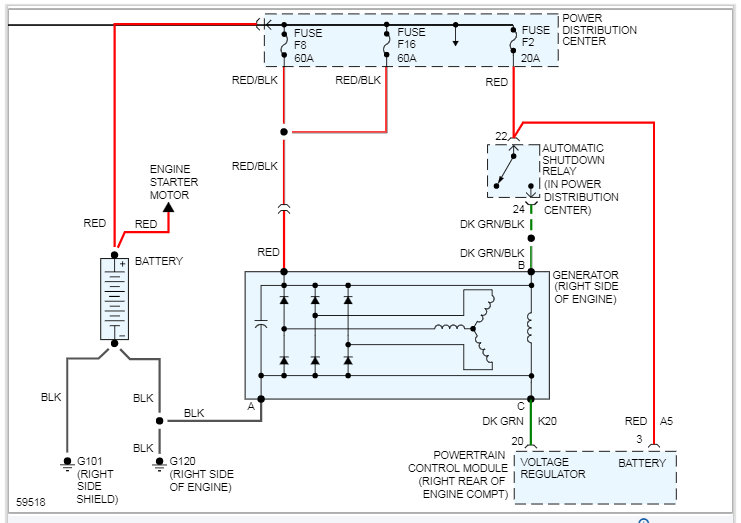

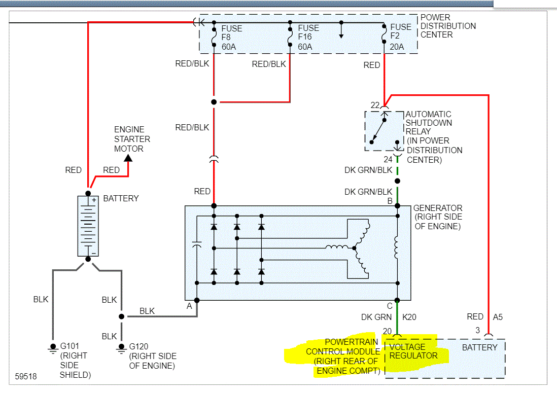

As I believe you are aware, the alternator voltage is regulated by the powertrain control module (PCM). If you would have told me there were times that voltage dropped and then would return to normal, I would have first suspected a bad alternator or a connection issue. However, the spike in voltage (which can be dangerous) doesn't indicate an alt or connection issue. Instead, it indicates the PCM is not controlling the voltage from the alt at all times.
I hate to say it, but I feel the PCM needs replaced. Spikes in voltage as you mentioned can cause other issues including the potential for something to overheat and catch fire.
If you look at the attached pic, it is the entire charging system wiring schematic. Note where the voltage regulator is located.
