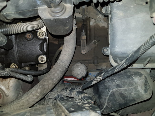

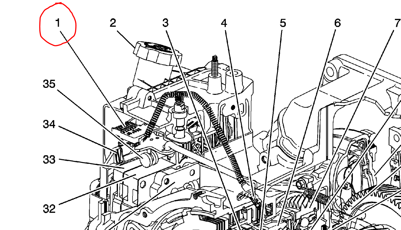

All of a sudden the pointer disappeared from the gears, signals and no rear camera not unlocking on Parking. Traction Control offed and like gear is not shifting. Even the Lift-gate is not opening. After I moved some cables from the gear connection side it worked and then itself disappeared its like on and off but I am failed to find the correct connector. I even have pressed the connections/connectors but no luck. It only worked once but don't know where exactly is lose connection. I also have pressed the big connector under the brake cylinder at driver side.
I doubt there's some missing voltage which is controlling all discussed areas.
Please advise if anyone experienced this issue and can advise.
Jan 25, 2020 at 7:20 AM
  • 110,190 POSTS

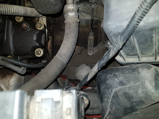

This sounds like an issue with the transmission range sensor. That is what determines what gear you are in. I attached two pictures below of location and wiring. See if something is loose on it.

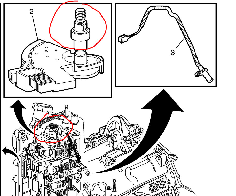

Not a problem. It should be on the side of the transmission. However, I would like you to do something for me. See if you can get your hands on a OBD2 scanner and check for diagnostic trouble codes. Let me know what you find.
If you can't, I need to know the 8th digit in the VIN number. There are two different designs on this vehicle. Let me also know if it is 2 or 4wd.
I found a pic of the internal mode switch (range sensor). I attached it. The top part of the pic shows the switch and below I circled where the linkage would be attached to it from the shifter. The connection should be near this point.

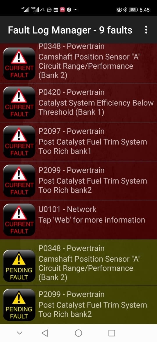

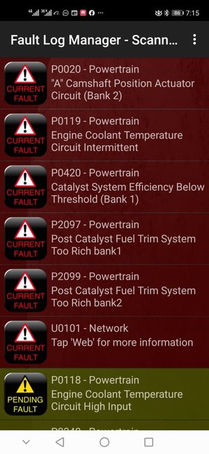

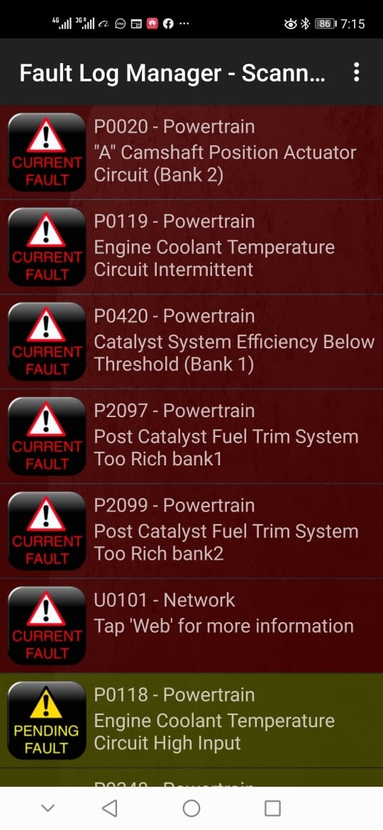

Hello Joe,

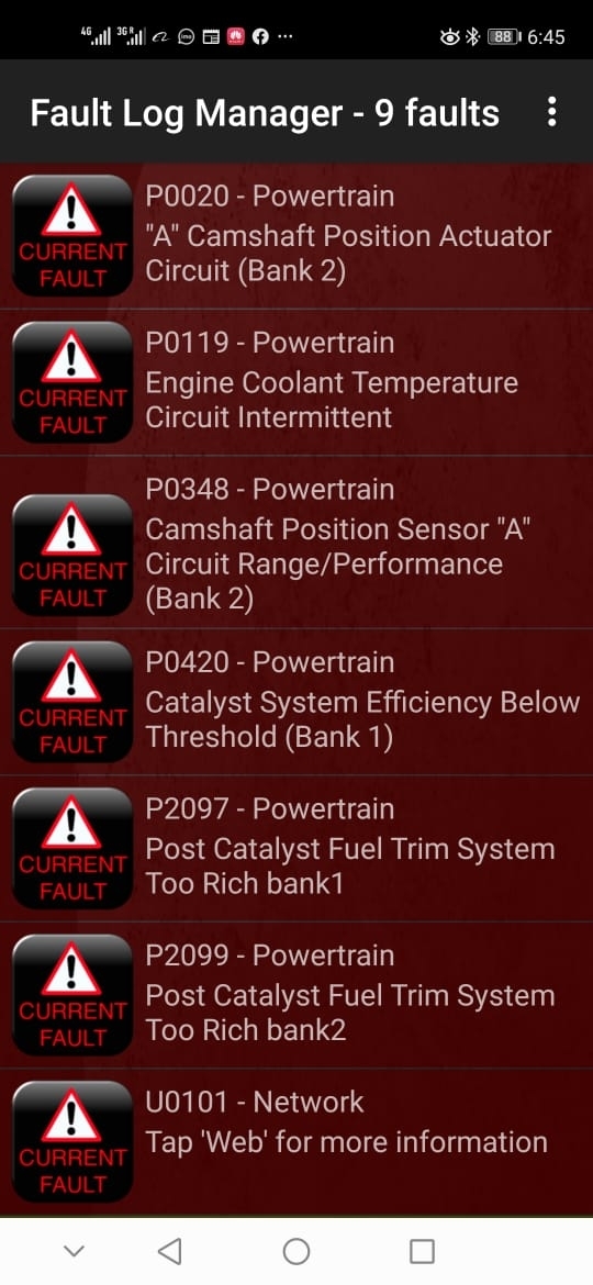

Please find attached the errors while the connection is loose.

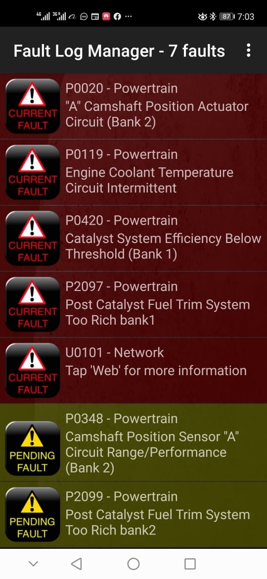

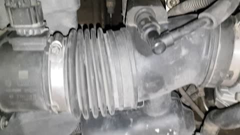

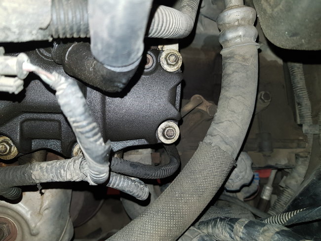

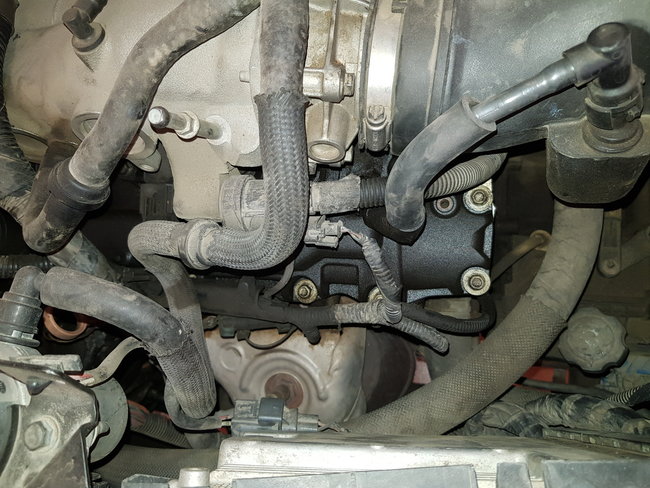

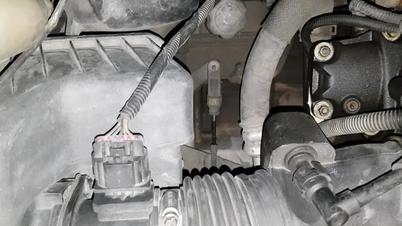

Here are more images.

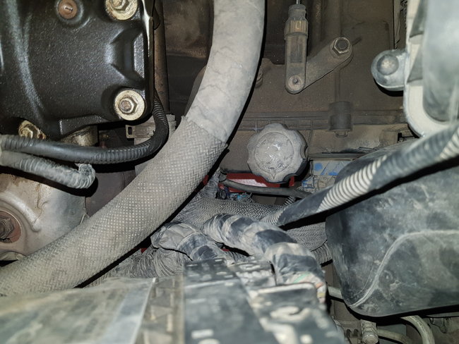

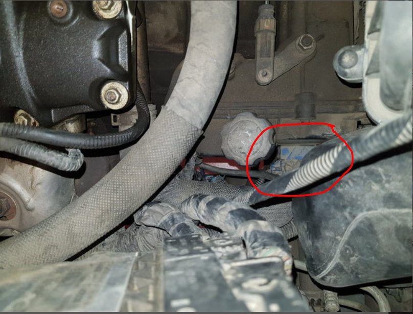

Where exactly?
Jan 27, 2020 at 1:58 AM
  • 110,190 POSTS
I copied one of your pictures and circled what I believe it the connector.

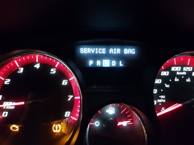

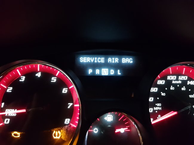

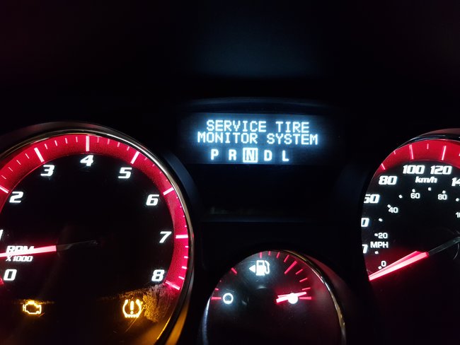

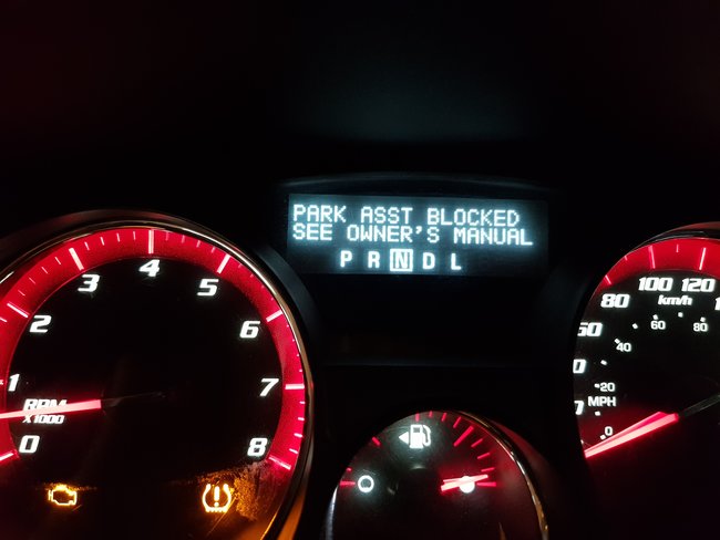

Hello Joe,
Since this is on and off situation. It's working fine for the last 4 days without any issues as mentioned. But still I am uploading the video of current wiring status. Plus the different messages showing on dashboard screen. Please advise for solutions.
Thanks for always best support.
Jan 29, 2020 at 12:34 AM
  • 110,190 POSTS
The indication lights/warning lights are all for different components. There are faults with the air bag, tire pressure system (which could be a low tire), I noted the check engine light is on, and the park assist is indicated.
I need to keep this thread specific to the original concern. The items in your pics require a different thread be started. We try to keep the threads specific to one topic so they are more helpful to others. I hate to ask, but could you please start new threads related to the things I mentioned in the pics?
Before you do start a new thread, I need you to have the computer scanned for diagnostic trouble codes. The check engine light staying on with the engine running indicates there are codes stored. These codes will be extremely helpful when diagnosing the cause.
I will keep my eyes open for the new threads. I hope you understand.

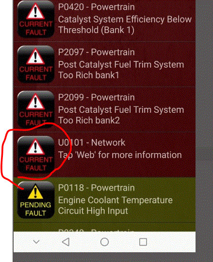

  • 110,190 POSTS

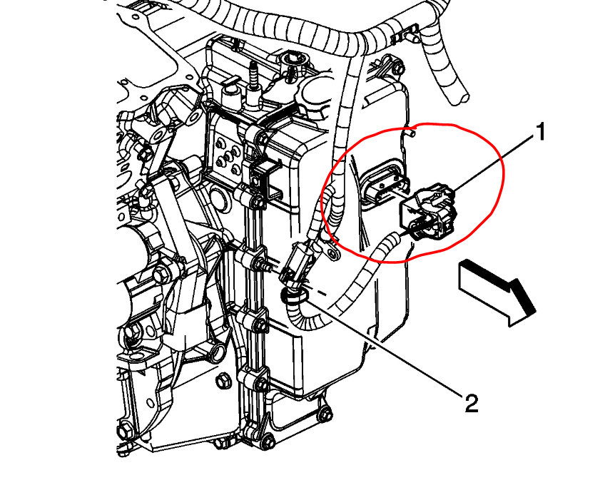

Okay, this is going to become somewhat involved. The newer vehicles have a can bus design. What the means is one wire receives signals from multiple modules / sensors. I read back through what we have already discussed. You indicated codes above and there is only one that I see that can be tying all of these together and that is the U0101. This code means that the transmission control module is not communicating with one or more modules that are connected with it through the CAN bus/controller area network system.
Here is what this means, the transmission control module isn't speaking with the power-train control module. I can see how this break down can cause the ABS, back up lights, rear camera and so on are all affected. Possible causes are a poor connection, broken or damaged wire, damaged connector, or even a failed TCM (transmission control module.
At this point, you need to have a professional level scanner to determine if it can communicate with the high speed GMLAN device on the vehicle. If there is no communication, either the TCM has failed or there are wires disconnected, damaged, or shorted.
I copied one of your pics from above and circled the code I'm referring to. If there is no communication with the TCM, the next step is to disconnect the battery and start checking wiring at connectors. The idea that you originally moved wiring leads me to believe it is a connection issue. However, the code is very vague and not specific other than there is no communication.

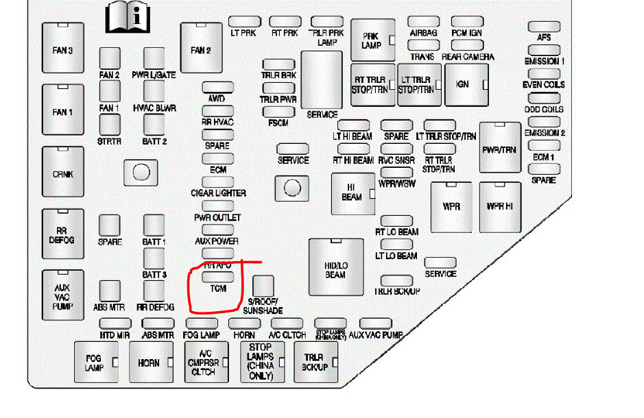

Now, the fuse box you didn't mention is located under the hood on the right side of the engine compartment (passenger side). There is a PCM fuse I would like you to check. See pic 2.
Also, I want you to remove the PCM fuse and check for power using a test light. Once the tester lights, wiggle wiring around to see if the light goes off.
