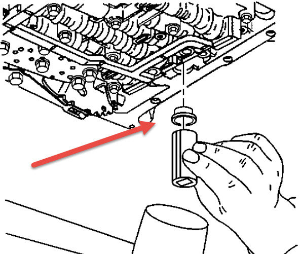

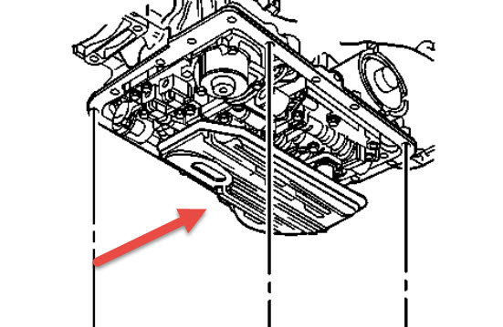

Changed transmission oil and filter now no fourth gear
2004 GMC ACADIA
257,000 MILES • 4.2L • 6 CYL • 2WD
MOHAMED FATHY
  • 7 POSTS
Can you please help?
I changed gear oil and filter in my 2004 Envoy and now no fourth gear. First, second and third are okay, just no fourth gear.
Can you guide me please?
Mar 18, 2017 at 1:46 PM
HMAC300
  • 48,601 POSTS
recheck your work you may not have put the seal for filter in right or filter and it is sucking air. See pictures.

thnx alot was very helpful
