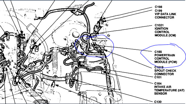

I recently purchased the truck listed above. I knew it was having some problems; the engine was not running right, and the automatic transmission only works by manually shifting, but it only had second and third (limp home mode?). The guy I bought it from told me the injectors were just dirty and that the transmission issue was easily solved by replacing the old filter. He had removed most of the smog equipment (and the heater hoses, and some vacuum lines for whatever reason) prior to my purchase. I put 10ohm resistors in the 3 plugs and got a plug for the EGR valve. My check engine light is on, but I don't get any codes from the EEC-IV port under the hood, either with my code reader, or the paperclip method. My map sensor doesn't seem to be getting any power. I am wondering if this is indicative of a bad computer, or if there may be another problem I haven't discovered yet. Any help would be much appreciated as I am at my wits end here.

Good afternoon,
The transmission is much more than a filter.
What model transmission do you have?
If you do not have the 5 volt reference signal to the ECM and you cannot communicate, then yes, it is a bad ECM.
Oct 6, 2019 at 6:06 AM
AL514
  • 5,700 POSTS
Hello just wanted to add, you should have a 5 volt signal on one of the map sensors 3 wires. If not, the ECM may have a bad power supply or bad ground. Low reference voltage (the 5 volts on the map sensor) can cause all kinds of issues since other sensors use this same 5v reference. If the ECM is not fully powered up, it can cause communication issues with scan tools as well. I would check the ECM powers and grounds before replacing the ECM.
