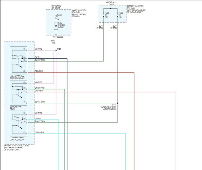

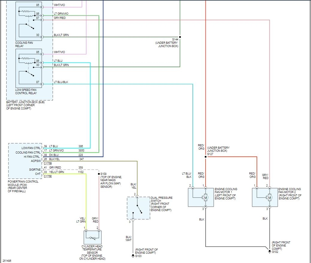

Where is located the engine coolant temperature sensor on the vehicle listed above? Fan only works when I turn on the A/C.
Wednesday, July 19th, 2017 AT 2:29 PM
22 Replies
HMAC300
  • 48,601 POSTS

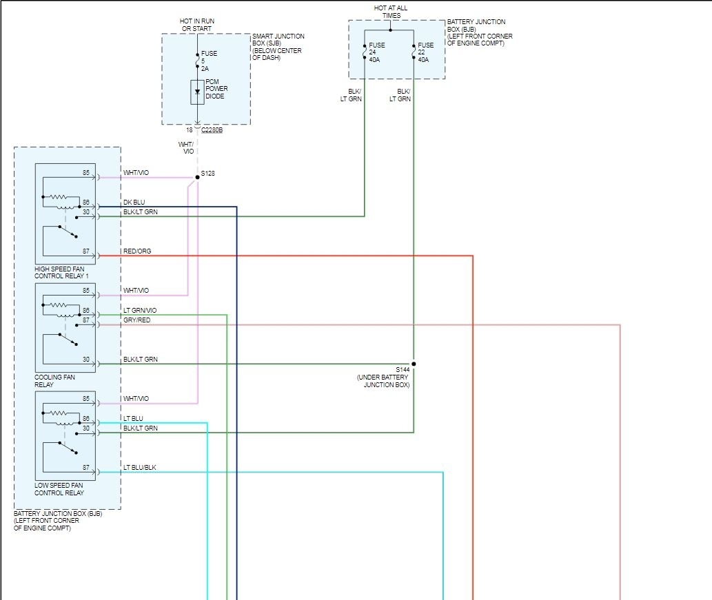

You do not have an ECT. you have a cylinder head temperature sensor. Check fuses in picture and relays as any of those can knock out the fans. See link as well.

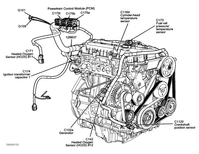

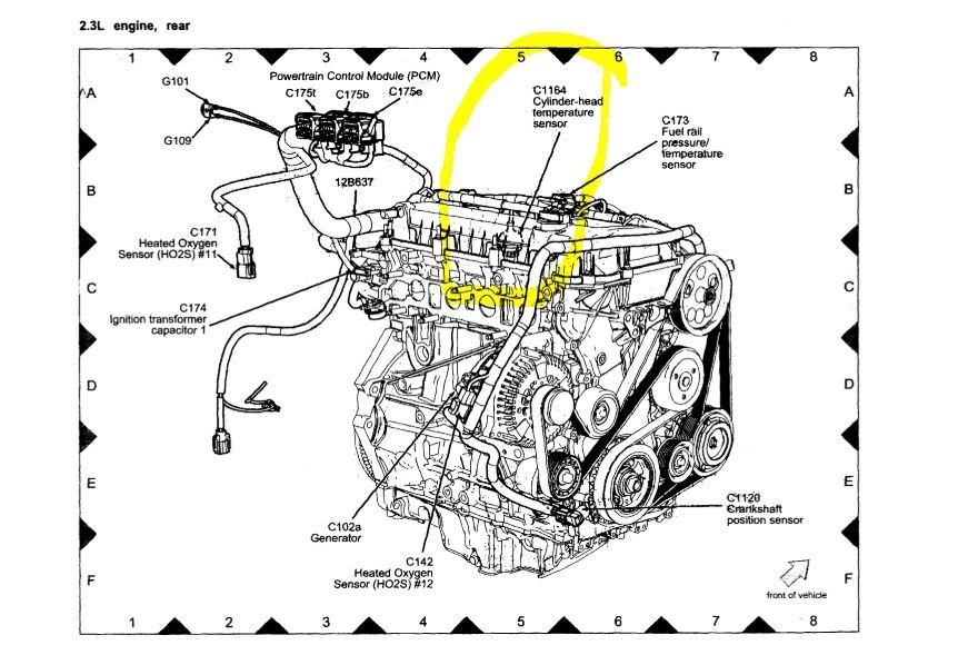

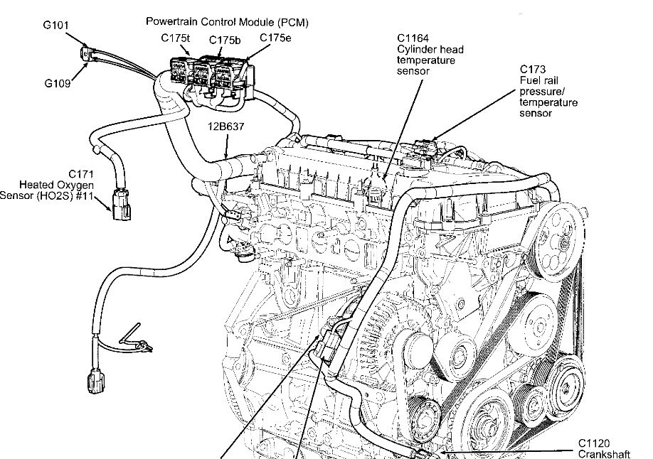

I am trying to locate the coolant temperature sensor. I am getting mixed information online and in the $20.00 manual I bought. In the manual it says that the 2006 four cylinder does not have an actual ECT. It is an CHT (cylinder head temperature sensor). I need to know where the sensor is located on the vehicle to verify if the guy at the auto parts store gave me the proper sensor or not. I cannot seem to find any good video or diagram online for the exact year and model of my vehicle. Can someone please help clear up this confusion for me?
Monday, July 5th, 2021 AT 11:44 AM (Merged)
CJ MEDEVAC
  • 11,005 POSTS
Looks like the Non-Hybrid 2.3L has the "CHT sensor"
The eighth digit in your VIN is "Z" (a hybrid would be "H").
This should be really easy to locate, I posted a diagram from "Prodemand" (listed at top middle of diagram).
The Medic

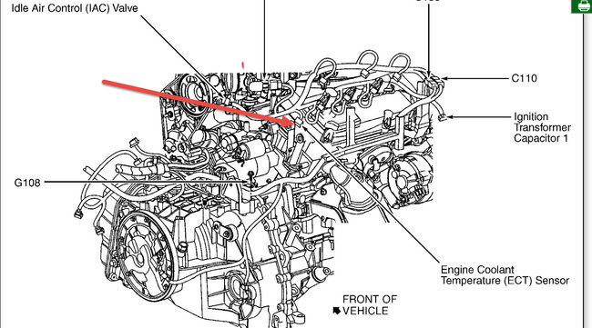

Need to locate the Coolant Temperature Sensor. Any chance someone can give me an idea of where to look? I need a diagram. Thanks!

Good evening,
I attached a picture of the location of the sensor for you. This is the best I could find.
What is the issue that leads you to replace this?

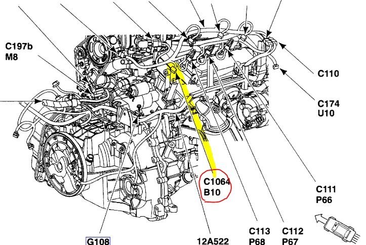

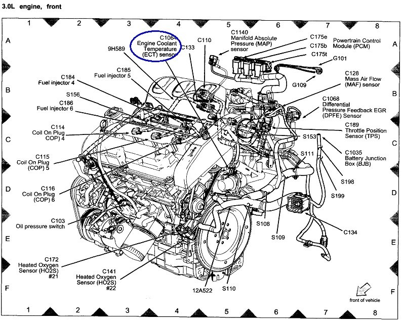

Can't locate any diagrams of the coolant temp sender that controls my inside gauge, it stays at halfway when I flip the key to on position after vehicle has been sitting a few days, and engine is cold.
Monday, July 5th, 2021 AT 11:45 AM (Merged)
HMAC300
  • 48,601 POSTS
On back of rh cylinder head see pic
+4

RICKY927
  • 11 POSTS
Thanks for the reply, but is this the temp "sender" or temp "sensor", they sell both for my vehicle and I changed the temp sensor already, which I believe is shown in the diagram you sent, but I can't locate this sender, does my vehicle not have it, cause I can't find it, I was told that the "sensor" is for the computer, and the " sender" controls the gauge.
+3

HMAC300
  • 48,601 POSTS
There is no sender the signal is received from the pcm which controls that gauge or it's run through what is called a can/bus system the only difference in parts is one is listed for a gauge and another isn't it mounts where the pic was
+3

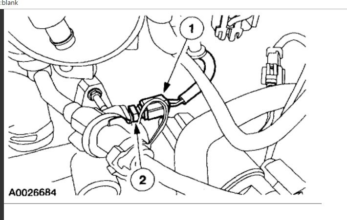

DIRTYRED724
  • 2001 FORD ESCAPE
  • 4WD
  • 209 MILES
My car with a V6 engine was overheating, I changed the water pump, thermostat and flush the radiator and checked the hose for leaks. After all that, it's still overheating for some reason. So I’m thinking it’s coolant sensor or heating sensor. Help please
  • 110,055 POSTS
If the engine is overheating, can you tell me if it does it at highway speeds as well as in town driving, or is it specific to one or the other?
Next, I attached a pic if sensor location. It is clipped into place and not bolted.
Let me know about the situations that cause it to overheat.
+1
