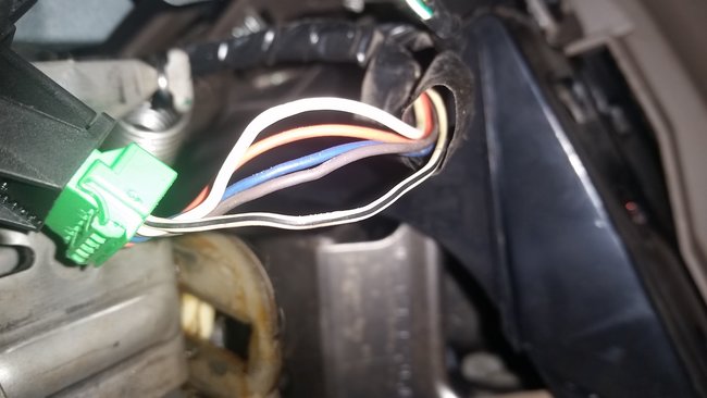

So I am having a problem with the ECM. there is no communication with it. I have a scanner and it does not let me communicate with the ECM either. the instrument panel does not turn on, the stereo does not either. The car turns but does not run. I replaced the ECM and the BCM, by turns the way the BCM is together with turns together the fuse box that goes under the dash, yet there is no communication with the ECM. I am struggling at this point and would really appreciate much help. thanks.

Does your cig port work because if that fuse is blown you cannot talk to you ECM etc. Also, if you replaced the ECM and BCM it wont start.You have to relearn the pass lock sensor. Also, did you put used BCM and ECM in it? What was wrong with you old ones?Because I highly doubt that they were both bad? Was the cluster working before you replaced them?

There are two fuses that mention the ecm, fuse 1:ECM/TCM and fuse 9:ECM/ETC only fuse number 1 is getting power, and fuse number 9 only gets power if I bridge relay 29:POWERTRAIN

Have you tried swaping the relay with a known good one?You could have damaged who knows what when you reversed jumped the car.Just had a car thru my shop that was reversed jumped that caught fire and the battery exploded .
Jan 6, 2017 at 5:02 AM
EDGAR ARMENTA
  • 27 POSTS
Already checked that.
When the computer is damaged, should the car still try starting?
And in the ignition switch, there is 5 cables, an orange (always has power) a blue cable and a grey one (get power when the key is open) a white one and a white/black cable (don't have any power, or ground to them, at any key position they don't get power, off, acc, I, or in the ignition. Could this be a problem to the car not starting?

Here's a picture of the cables.

Here's the problem the starting system goes thru computer's even to operate the starter.Do you have a scan tool that can read like the engine and body control module codes?I know you can't talk to the ecm and we don't know about if you can talk to the bcm?if the ecm isn't getting power it won't start regardless.If your getting power into the underhood fuse box itself and your not getting power to some of the fuses.Then your gonna have to starting looking at the wires going into the underhood fuse box.

My dad did the same thing to my Ion.. it wound up being a bad wire to the ignition switch..
