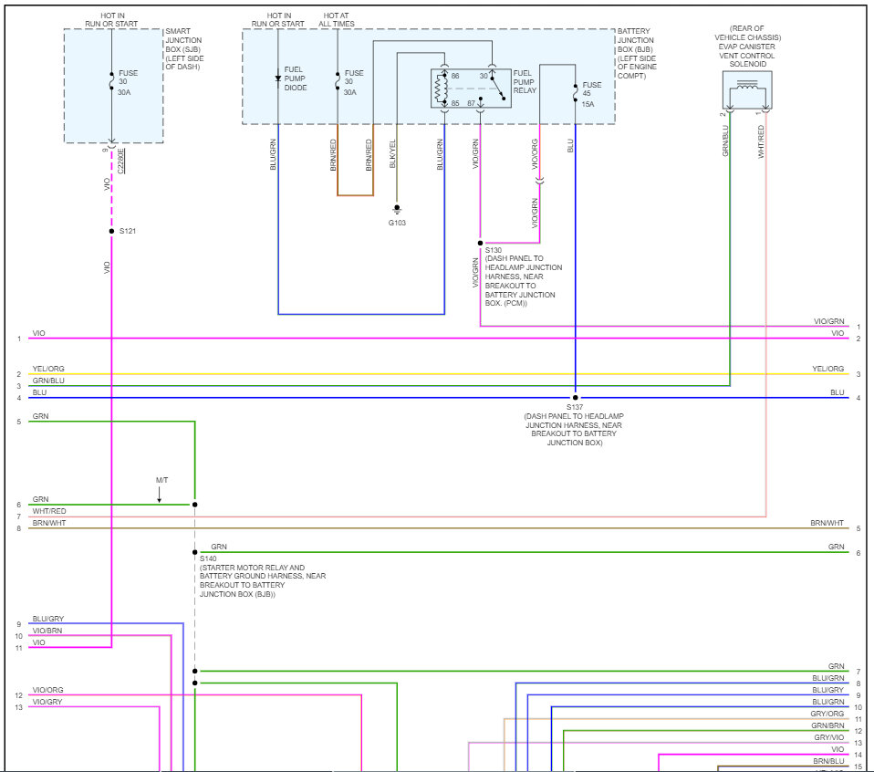

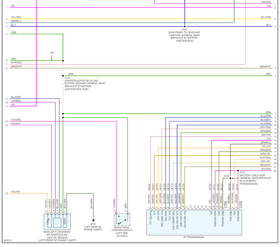

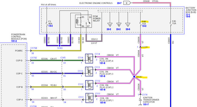

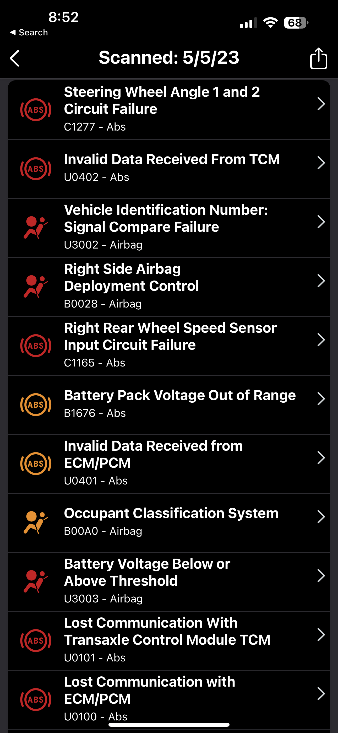

i just bought the car, it won’t start, there’s no spark, and it keeps throwing ECM/TCM/and PCM codes. i need the wiring diagrams for the PCM and fuse box connectors/pins so i can test all of them.
May 5, 2023 at 1:02 PM
  • 55,721 POSTS

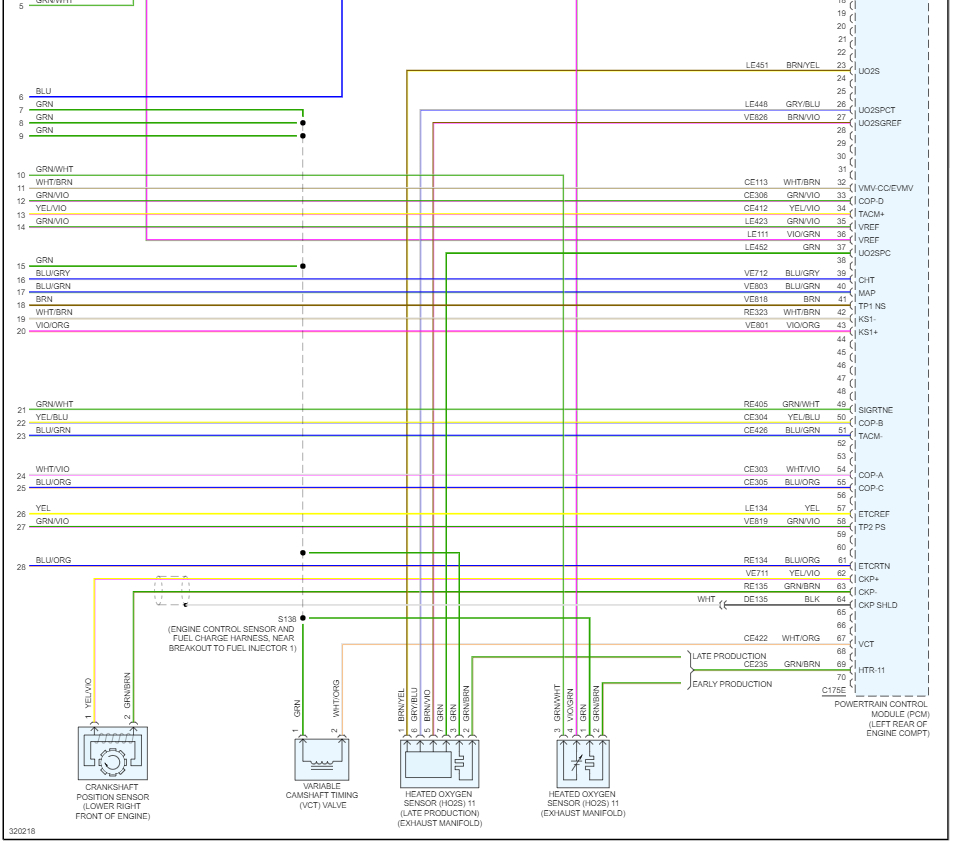

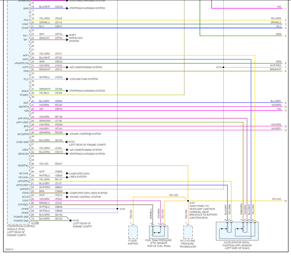

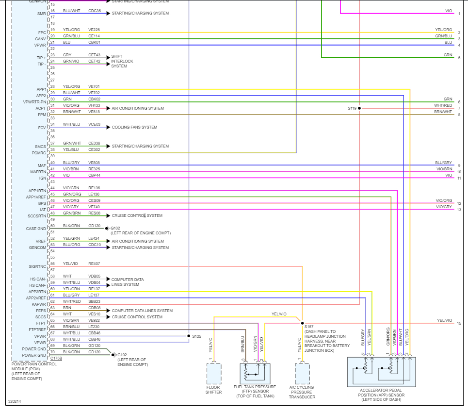

Sure, can I ask what the codes are? Here is a guide to help you check the connections and the engine and PCM wiring diagrams in the images below:

this is a screenshot of all of the codes that show up.
May 6, 2023 at 11:53 AM
  • 55,721 POSTS
Yep, those are some codes all right, please clear them and then without trying to start the engine turn the system on and run the codes again let me know what comes up.

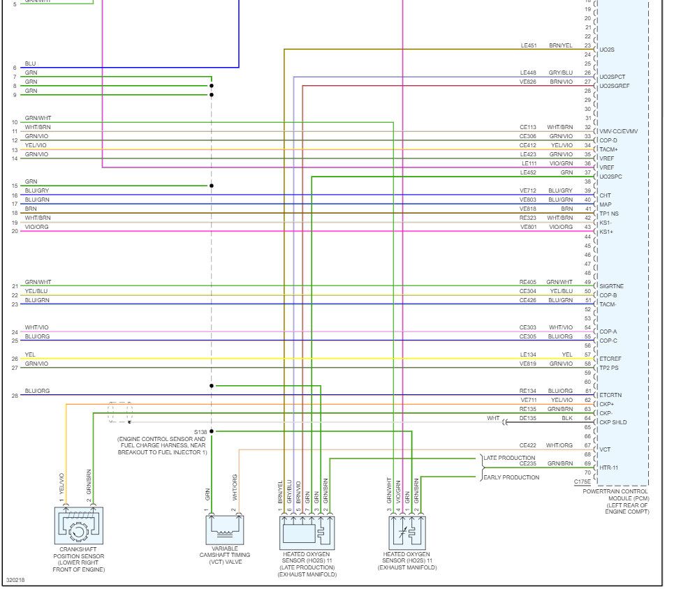

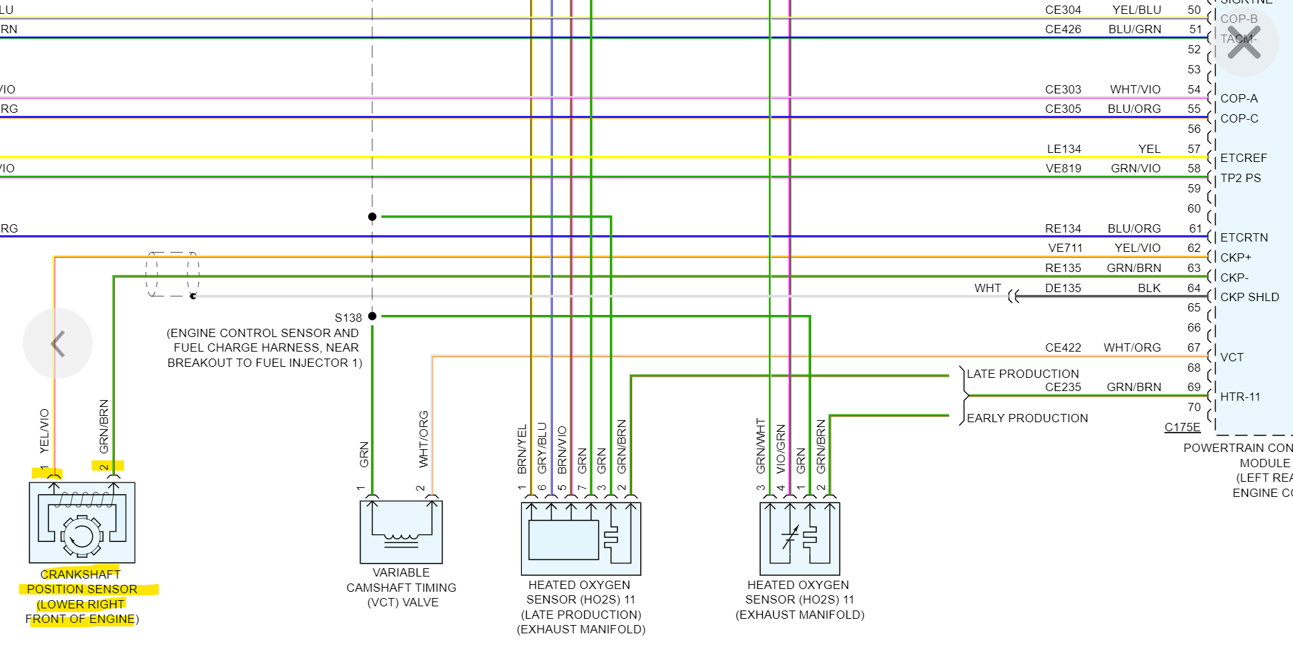

If this is not a Hybrid, we can pull up the ECM diagrams and check powers and grounds. If you turn the key to the on position, engine off the Check engine light should come on, if it doesn't the ECM is not being powered up,

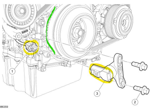

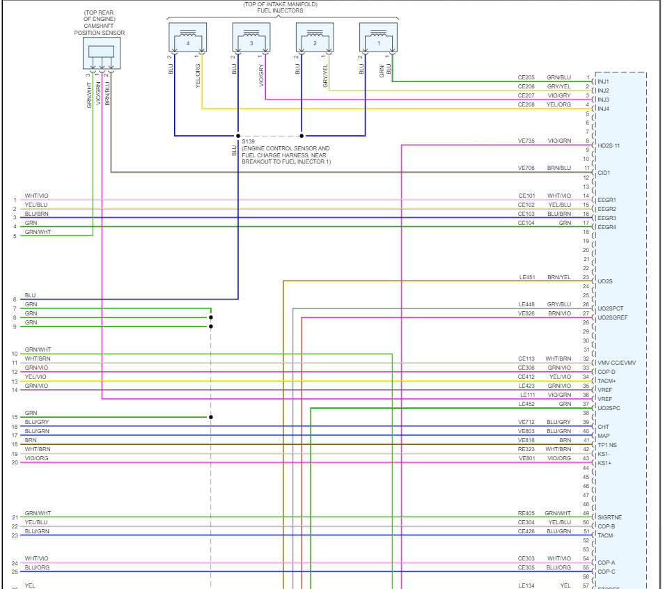

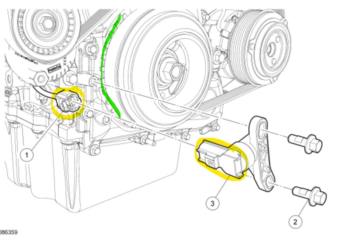

Here is the crank position sensor, it's a 2-wire sensor, a variable reluctance sensor that produces a sinewave signal to the ECM,
Here is its location, the green is the trigger wheel for the sensor, verify the wiring is good to it.
But I would verify power and ground to everything else first, there is quite the process for replacing the crank position sensor and then a crank relearn procedure as well.

It’s the SE and how would i check all of the power and grounds. also, i don’t know if i did it wrong or not but i back probed the wires for the CKP with my multimeter set to ohms and it kept reading 1.

i was thinking about back probing new wires from the PCM to the CKP just to see if the wires are the problem but i don’t know what wire i need. and i tried reading the resistance for the CKP from different connectors and it always read the same thing.

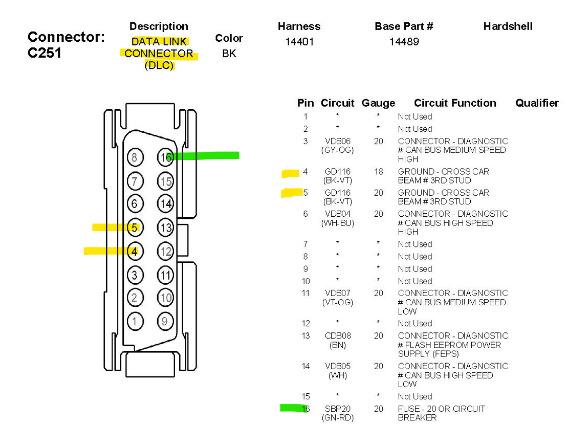

The resistance of the crank position sensor is going to be between 0.25k to 1.1k Ohms, 250 to 1100 Ohms. Be sure your meter is set on the correct Ohms setting. Unless you have an auto ranging type multimeter. post a picture of it if you're unsure. disconnect the sensor and with the key On, engine off you should also read a bias voltage on each of the 2 wire connector and battery negative of 1 to 3 volts. This bias is for checking the circuit back to the ECM, if you read anything higher than 3 volts or its missing, this indicates a circuit issue. But you did not have any codes for the crank position sensor, you had communication codes and low voltage codes, I don't think this is a crank sensor issue. If you have a scan tool that can read live data from the ECM, check for an RPM signal, or watch the Tachometer jump while cranking, then is your crank signal. I would rescan for codes after cranking and see if there are any U or B codes.
This is the Data link connector, with you multimeter, check for 12volts on pin 16 using pin 4 and then 5 as a ground. Don't jam the meter leads in the connector, just touch them lightly with the key on engine off. Let's see what there is for system voltage here.

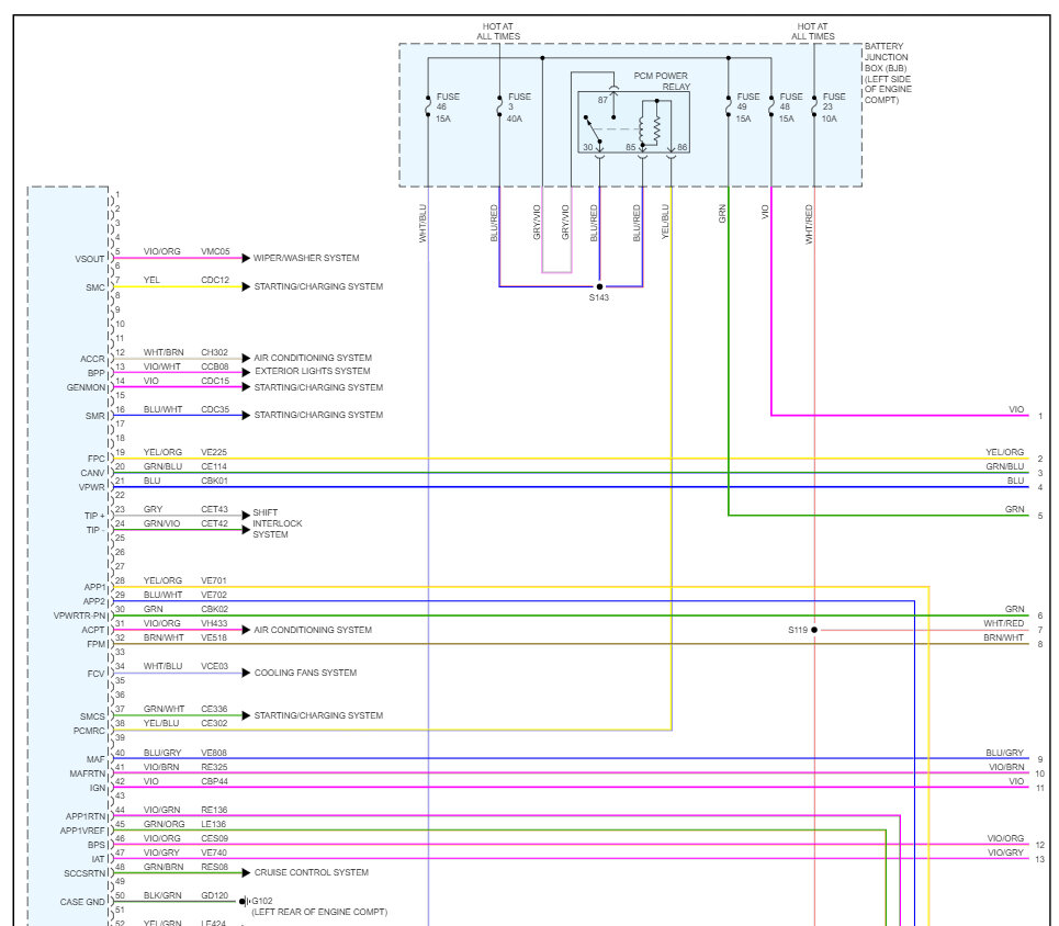

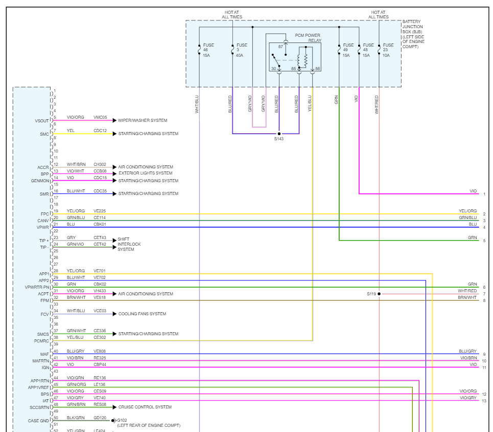

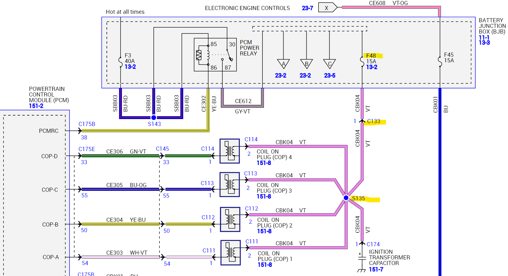

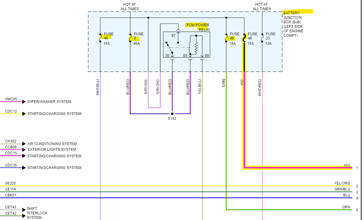

But as for your lack of power at the Ignition coils, this Fuse 48 15amp is the feed right to the coils, its powered up by the PCM Power relay, so I would check Fuse 46, 49, and Fuse 3 feeds the PCM Power relay. So, either the relay is not being turned on, or there's something else going on with the feed to it or the relay itself. But don't just swap that relay with another in the fuse panel, the days of doing that are gone. During a training class not too long ago that was something they were really specific about. I would see if there's power at 3 of the pins and then 86 should be pulled to Ground by the PCM. And that Fuse 3 should be hot all the time. So, if it's lacking power, we'll have to trace it back from there. If you're checking for Ground on pin 86 for the relay, use a LED test light. Those relays pull less than 200ma on the control side.
May 16, 2023 at 10:52 AM
BOSSEMNES915
  • 21 POSTS
Okay, thank you i will look into those. i just checked the fuses, 3, 46, 49, and 48 all have power. My multimeter leads were just too thick to test the new fuse i put on 48. i also tested the PCM relay and the holes for pins 30 and 85 have power with the key on. Then on the relay with it disconnected i powered pins 30 and 85, with ground to 86 and that made 87 have power. now i'm pretty sure it's not the fuses or relays so i checked the ignition coil connectors. The power wires only have around 0.2v, and the continuity between battery negative and the connector grounds was over 1400k ohms. i wasn't able to check for ground on 86 though because i don't have a test light but I'll get one tomorrow.
May 16, 2023 at 1:35 PM
AL514
  • 5,700 POSTS
So, with pin 87 powered up did you have power at your ignition coils?
The coil negative wires will have resistance because they are Ground side controlled. If you put power to pin 87 and it reached the coils, then the PCM is not switching on the PCM power relay for some reason. But if powering pin 87 didn't result in power to the coils then there is an open circuit or corroded connector.

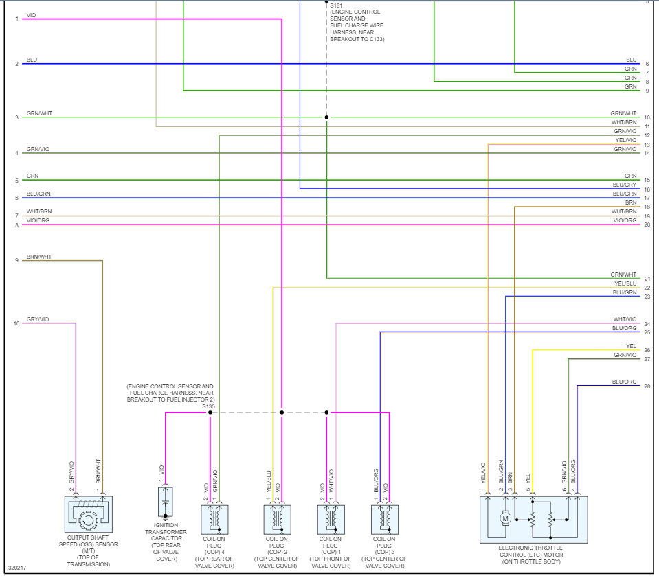

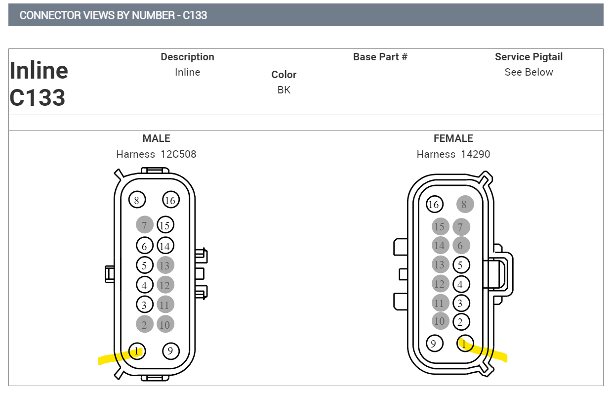

If fuses 46 (15amp), fuse 49(15amp) and fuse 48(15amp) had power then the relay is working, since power for those fuses comes through from pin 30 to 87 and then out to those fuses. So, it looks like there is a connector issue to the coils positive feed pins. I'll look through the OEM diagram for any connectors in series from the PCM power relay to the coils for you to check, With the key On, with one meter lead on Fuse 48 to the coil positive connector pin, you should have close to 0 voltage drop, there will be a little, in the millivolts, but if you're reading something like 10-volts, that means you're losing that much voltage on the positive side of the circuit, Thats voltage drop testing. And it's best to do with the circuit on (powered up) because it's semi loaded and has some current flow.

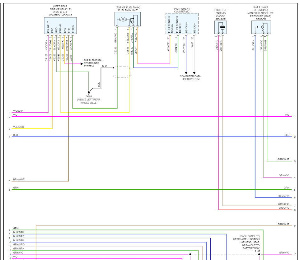

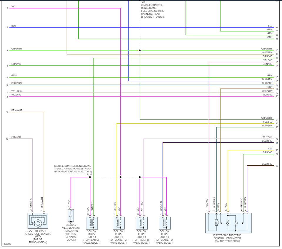

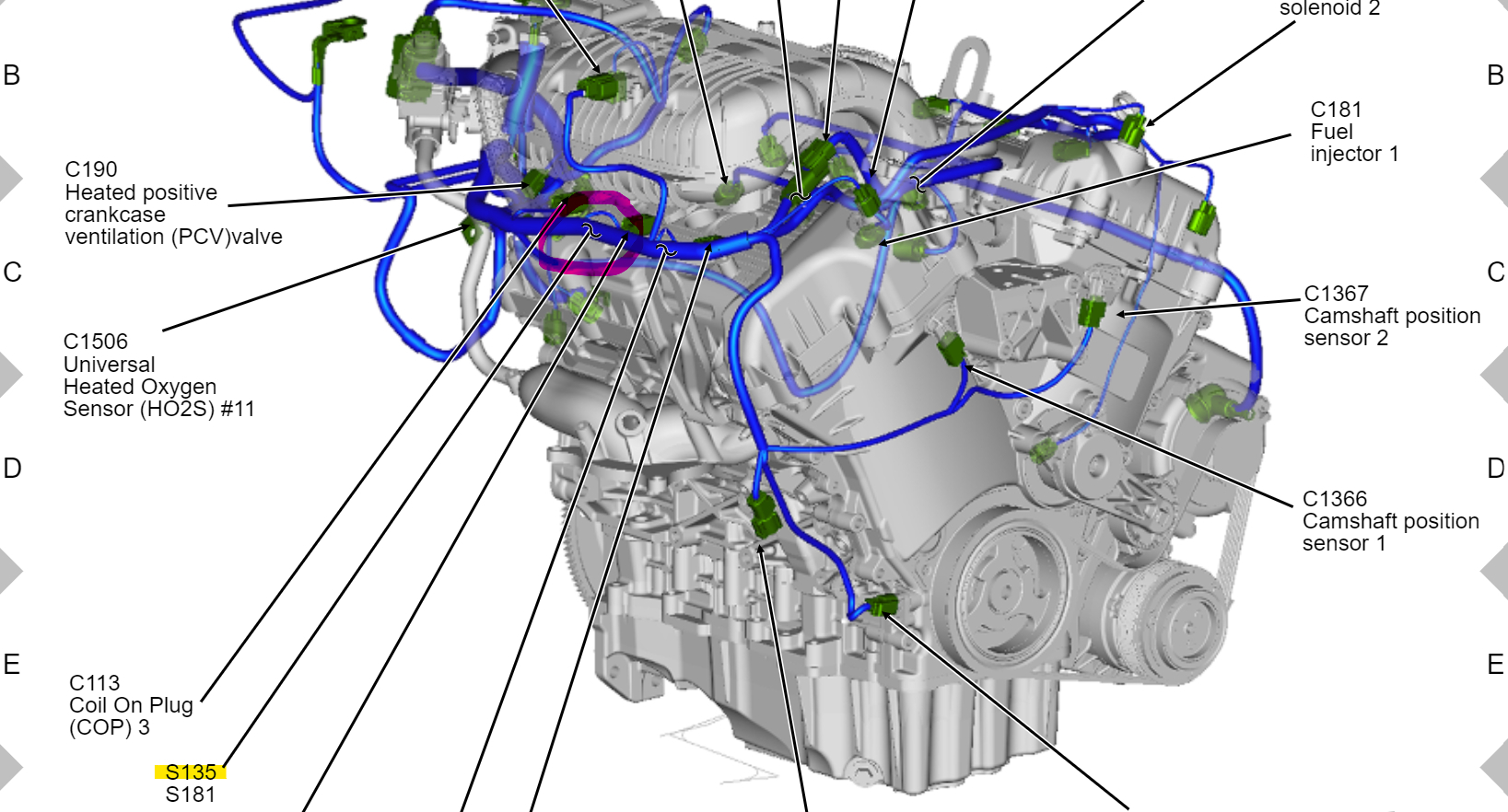

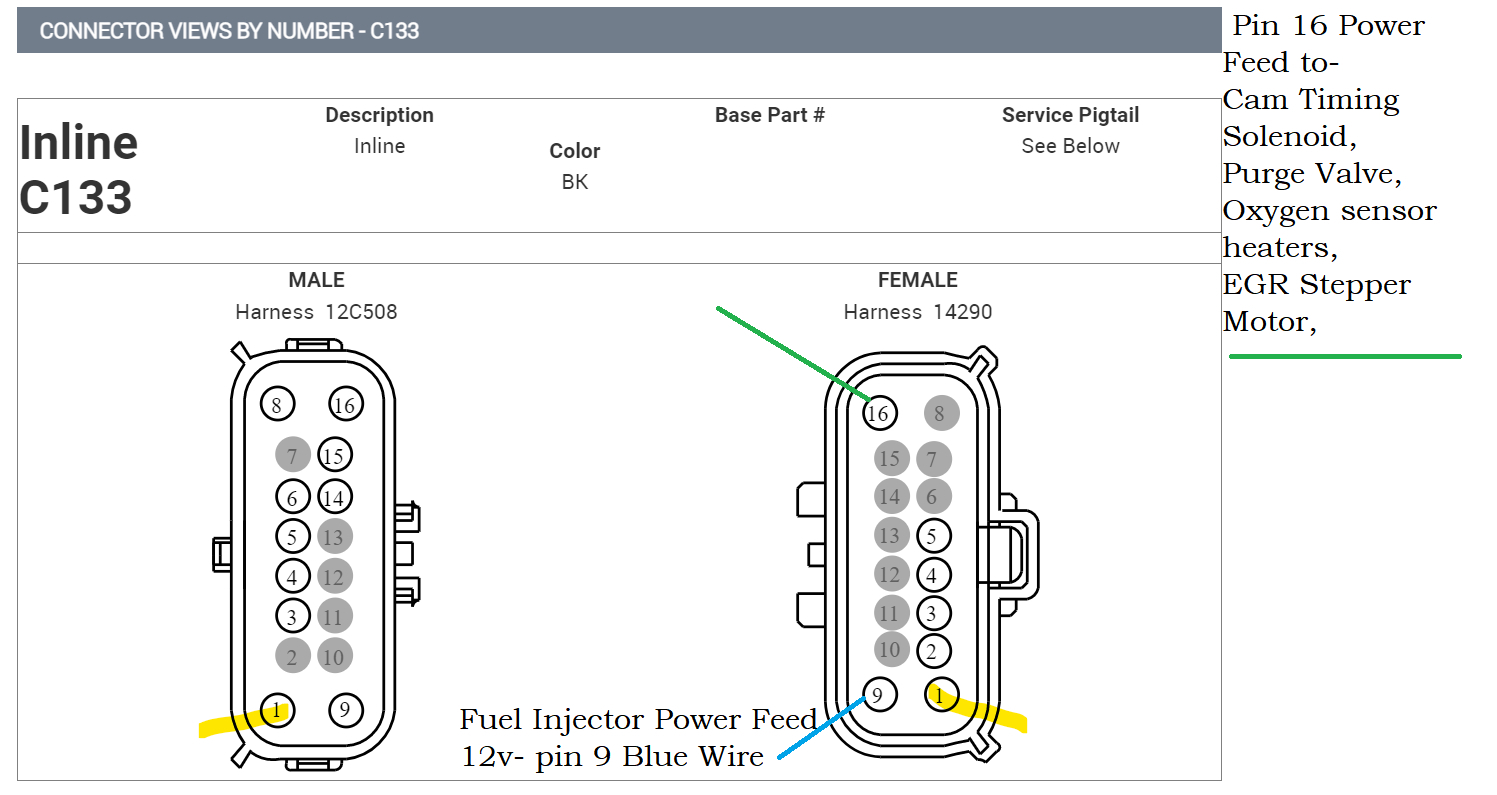

Okay, that was quick, there is a connector and a splice going to the ignition coils from fuse F48.
May 17, 2023 at 7:46 AM
BOSSEMNES915
  • 21 POSTS
okay, yeah, i was trying to do that but i don’t know what pins and wires i need to check.
May 17, 2023 at 7:49 AM
AL514
  • 5,700 POSTS

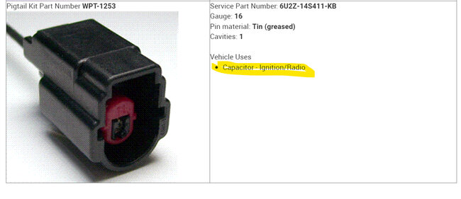

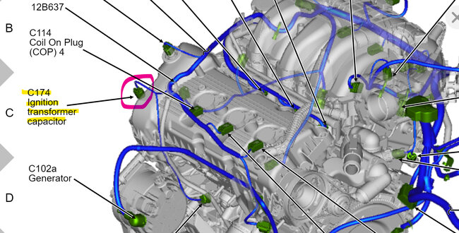

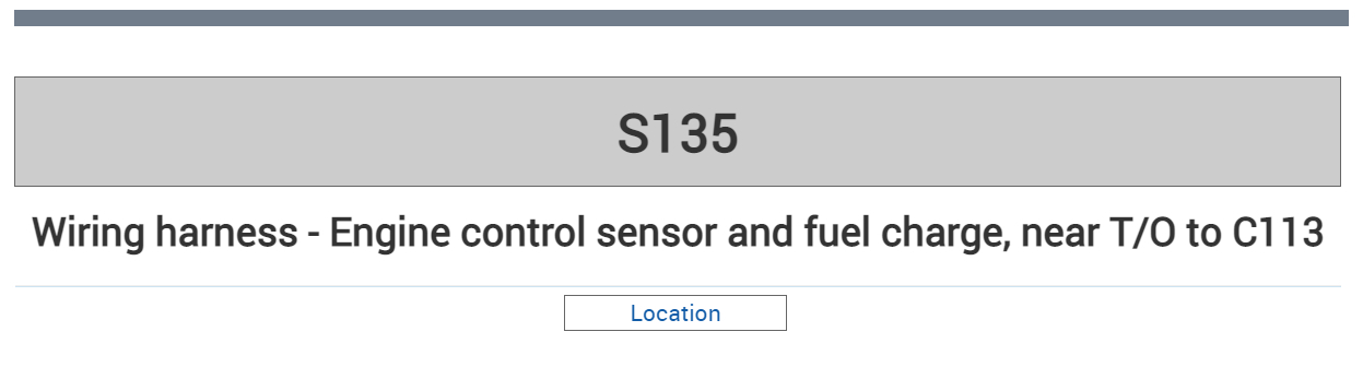

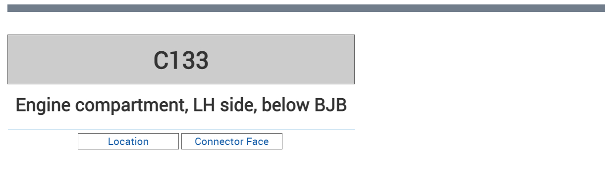

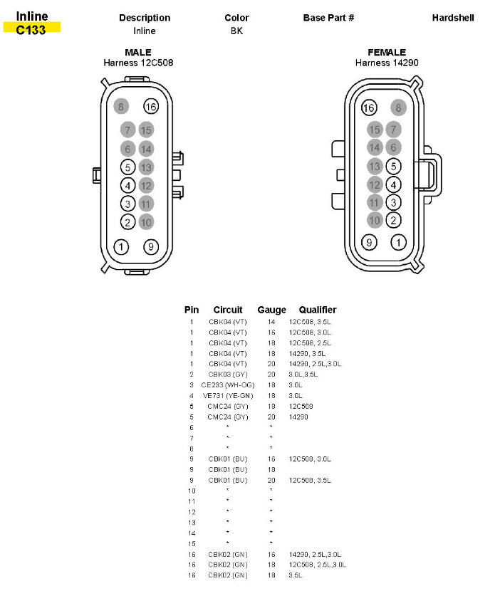

Here is everything on C133, they even show a picture of it, pin 1 violet wire, and Ill try to find that Splice next. Im impressed with Ford on this one, diagrams 6 and 7 are Splice S135

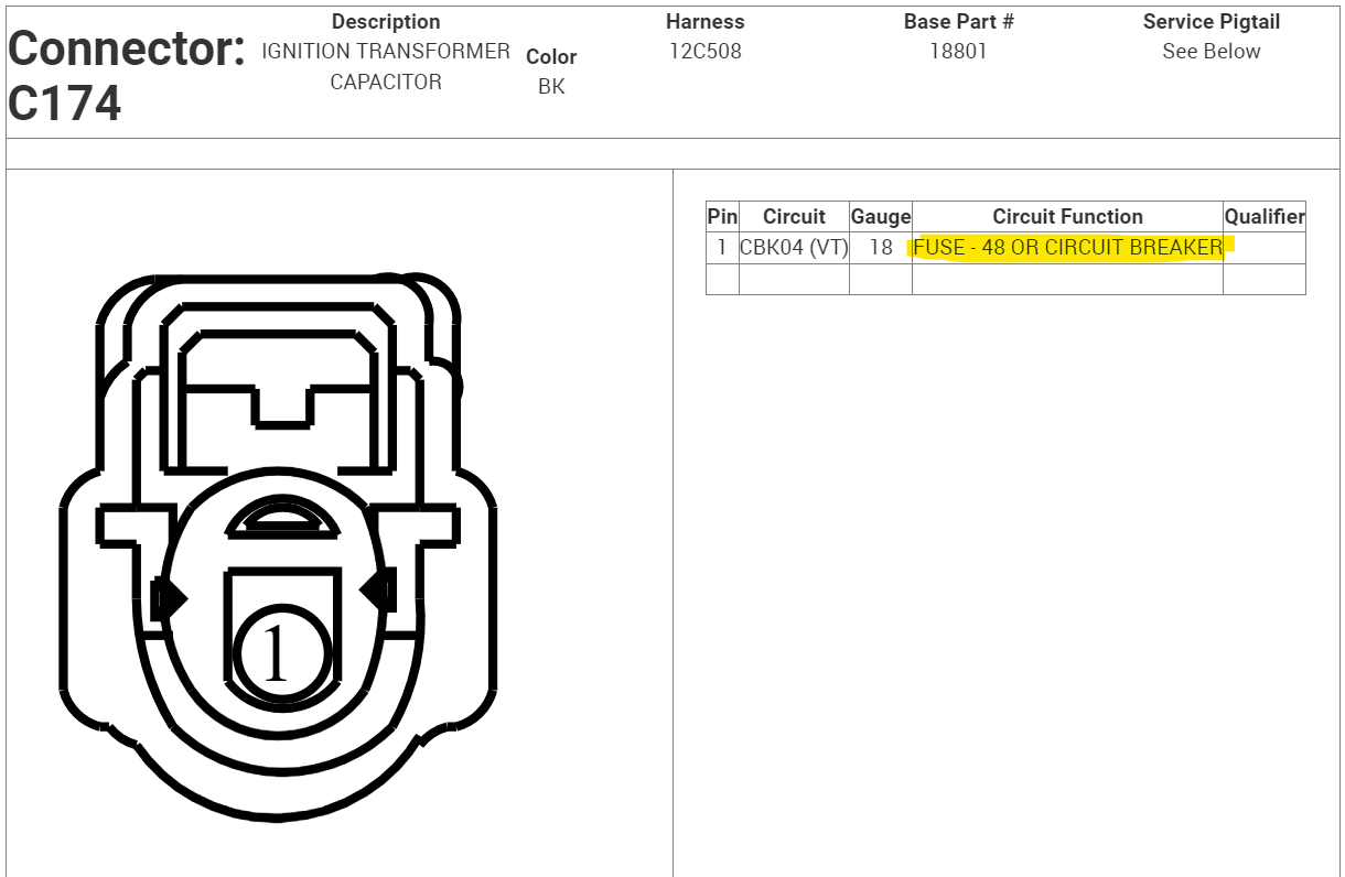

This C174 should also read ignition coil voltage, its the capacitor to keep voltage spikes suppressed from the coils. The one thing I noticed is it says Fuse F48 or circuit breaker, is Fuse 48 a circuit breaker? if it is and there is a short to ground, the circuit breaker is going to keep the circuit open until the short if fixed. So if you dont find any issues with the connector C133, try unplugging the coils one by one and then the capacitor and see if voltage returns.

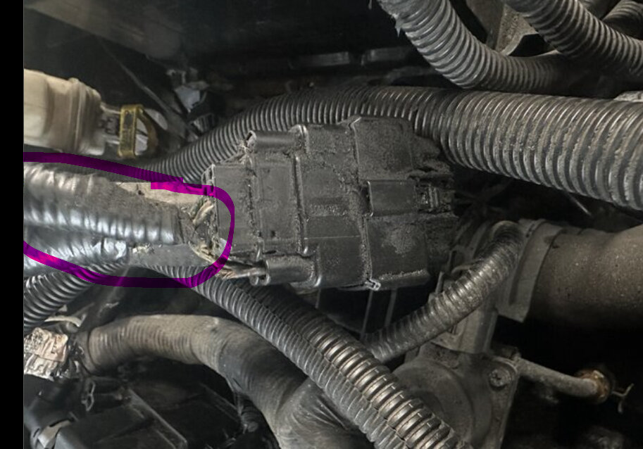

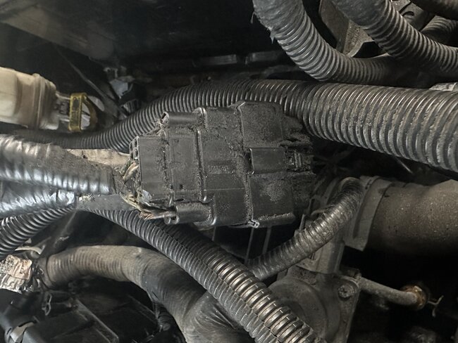

Okay yeah, i never saw connector c113. i’m pretty sure that’s the problem there’s a wire that’s broken and i’m pretty sure it’s the purple one, the whole connector is really dirty though so it’s hard to see but using the picture for reference i’m 99% sure it’s the right one.
May 17, 2023 at 8:16 AM

AL514
  • 5,700 POSTS

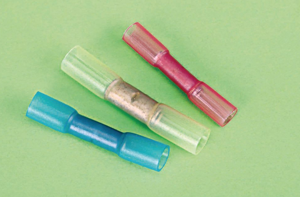

is the wire broken close to the connector? Can you take a picture? Since it's just a power feed, I usually use heat shrink crimp connectors to keep any moisture out in the future. These are what I use if there isn't room to solder a connection. You strip off about a 1/4in of insulation off the wire end, crimp the connector on, then heat the ends, it will shrink down on the wire. And the really good ones have a type of adhesive that seals the connector to the wire. I use a heat gun to shrink the connector down, but you can use a lighter just as long as you don't overheat the heat-shrink section. If the C133 connector is dirty inside, auto parts stores carry terminal cleaner, it's a spray you can use for inside the connectors that will evaporate, not leaving any harmful chemicals inside the bulk connector.
Take a picture of the connector so I can see how bad it is. I'm surprised you had any voltage reading at all.

here is a picture of it.
May 17, 2023 at 11:03 AM
AL514
  • 5,700 POSTS
Is that electrical tape all over that conduit? I'd take a look at the wiring under there, is that where the broken wire is? Looks in rough shape at the beginning of the connector.
May 17, 2023 at 11:14 AM
BOSSEMNES915
  • 21 POSTS
no, it’s the same material that’s on the rest of the wiring harness and yeah, it’s pretty bad there are some other wires that aren’t fully connected either.

When doing wiring repairs, and there's insulation that has been missing off the wire for a while, strip the insulation back to crimp a connector on make sure the wire hasn't gotten corroded inside the insulation further up. Even a small section of wire that's missing insulation can become corroded inside. The corrosion just grows up into the wiring, so be sure it's clean wire strains when doing the repair. I've had whole sections of wire corroded inside just from a pin hole in the insulation. Sometimes the wire is actually missing inside the insulation because the copper strains just disappeared. You want your repair to last so a in a couple months you don't run into the same issue again.

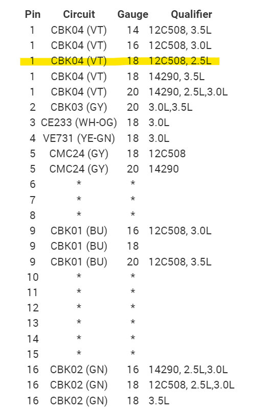

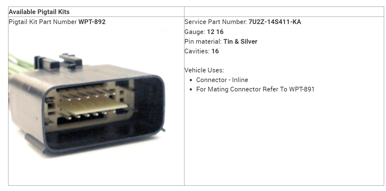

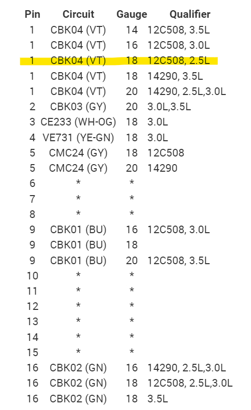

okay i’ll keep that in mind. some other wires pulled out of the connector too, how would i reconnect wires to the connector and could you find me a diagram showing what wire goes to what pin on the connector.
May 17, 2023 at 11:35 AM
AL514
  • 5,700 POSTS
This is the pinout for that bulk connector with the wire coloring. Taking apart connectors like this is really difficult. The easiest, faster way is to just bypass the connector with new wiring, If the pins are pulling out of that connector like that, I think someone else has tried to fix it before and messed it all up. It doesn't look like there are many wires actually used in the connector if you look at the pinout.

Should i just connect them around the connector with new wire and those heat shrink connectors then?
May 17, 2023 at 12:48 PM
AL514
  • 5,700 POSTS
Yes, to pull that connector apart and try to get all the pins tight again, and repair any wiring issues, you'll be at it for hours. Just match up the wiring, make sure you get the correct ones connected. Watch for corrosion inside. The other option is to try to get that connector from the dealership, If they even carry it.

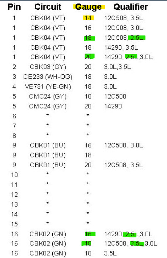

Okay, thank you for all the help. I'll go get all the wire and wire connectors tomorrow and then update you. What kind of wire do i need?

Just get a roll of wire from an auto parts store, 14-gauge wire will handle about 15-amps of current, so maybe go with 12-gauge to be safe. It will multi strand copper wire. 12-gauge will handle 20-amps. Sorry for the slow response, I just got on here.

it’s okay thank you, so the 12 gauge will work for all on the wires on that connector?
May 18, 2023 at 4:34 AM
AL514
  • 5,700 POSTS
Yeah, I don't think there is anything on that connector that carries more than 20amps, I'll see if I can ID each pin, but I'm sure you'll be safe with 12. Actually, on the connector pinout diagram it shows that 14 gauge is the biggest wire in the connector, Ill post that for you to see, so you can use 14 or 12, the fuse is a 15amp fuse if I remember correctly, but those ignition coils won't pull 15 amps.

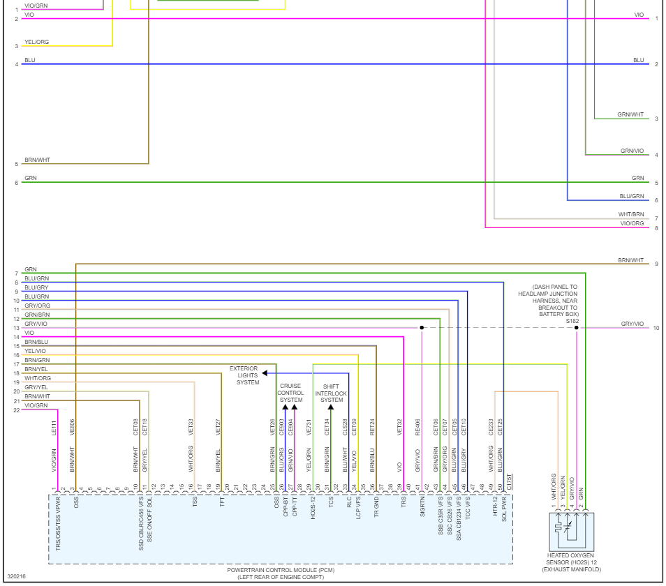

Okay, did you verify there's 12volts to each coil? And when you crimp those connectors, you have to make sure they are a solid connection. Did you do the entire connector of just the wires that has an issue?
Pin 9 is the fuel injector power feed, pin 16 powers the Cam Timing Solenoid, Purge Valve, Oxygen sensor heaters, EGR Motor,
Just need to figure out what pin 5 is for, but it sounds like there are other wiring issues going on. If that connector wiring was that bad, there has to be other wiring in the same condition. You've got 3 cylinder misfires, so if there is power to all the coils and injectors, then there has to be either wiring issues on the control side (ground) of those components, or the misfires are being caused by a vacuum leak, which is also causing the high idle.
