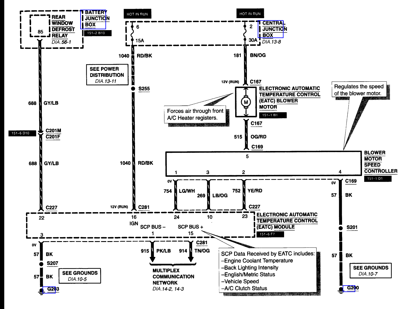

Is there a way to test the EATC before just replacing it? The unit will not do anything, nothing lights up and no display so self test is not an option, though I have tried. Disconnecting the battery for an hour did nothing (for the EATC) either. I have checked all the fuses can find and replaced several that were blown, again with no change to the EATC. I have searched everywhere I can think of to find a power relay or the like but not finding anything. The car is a daily driver for a family member who lives about fifty miles away so access is limited and I really need to have all the information I can get before jumping into this.

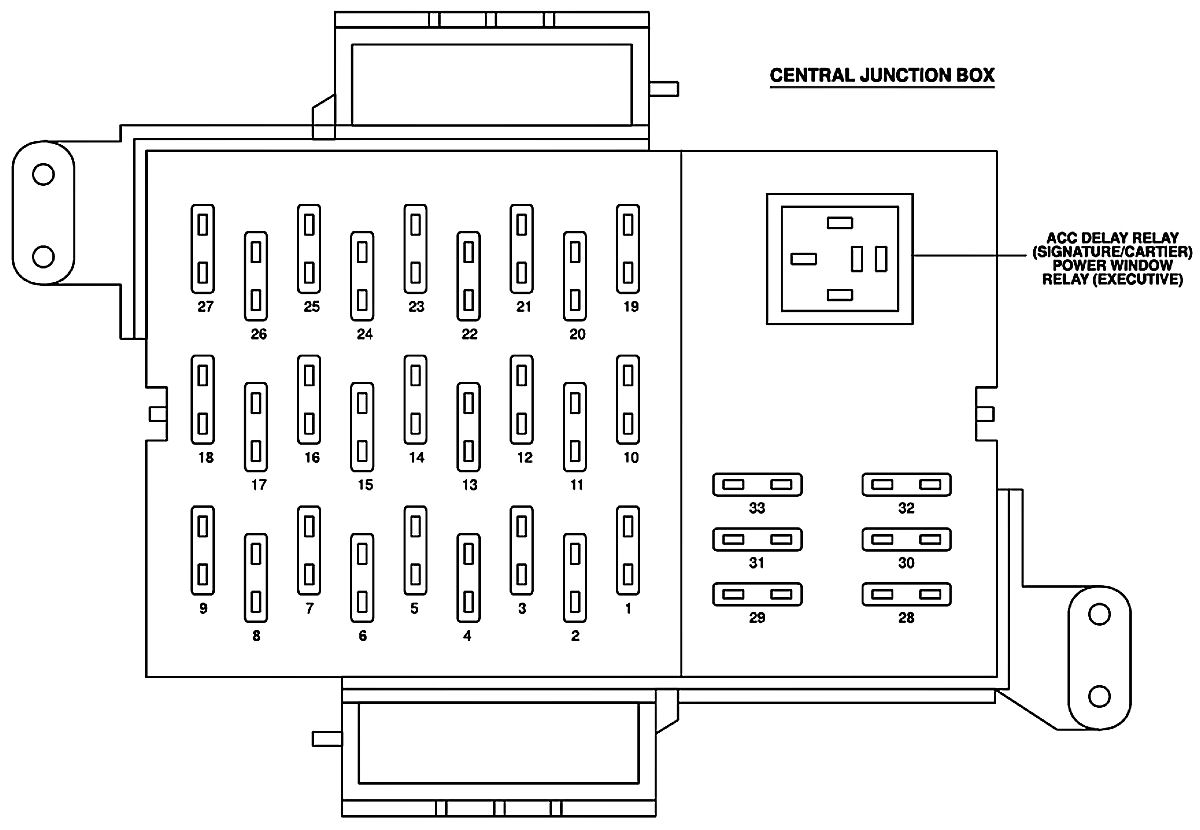

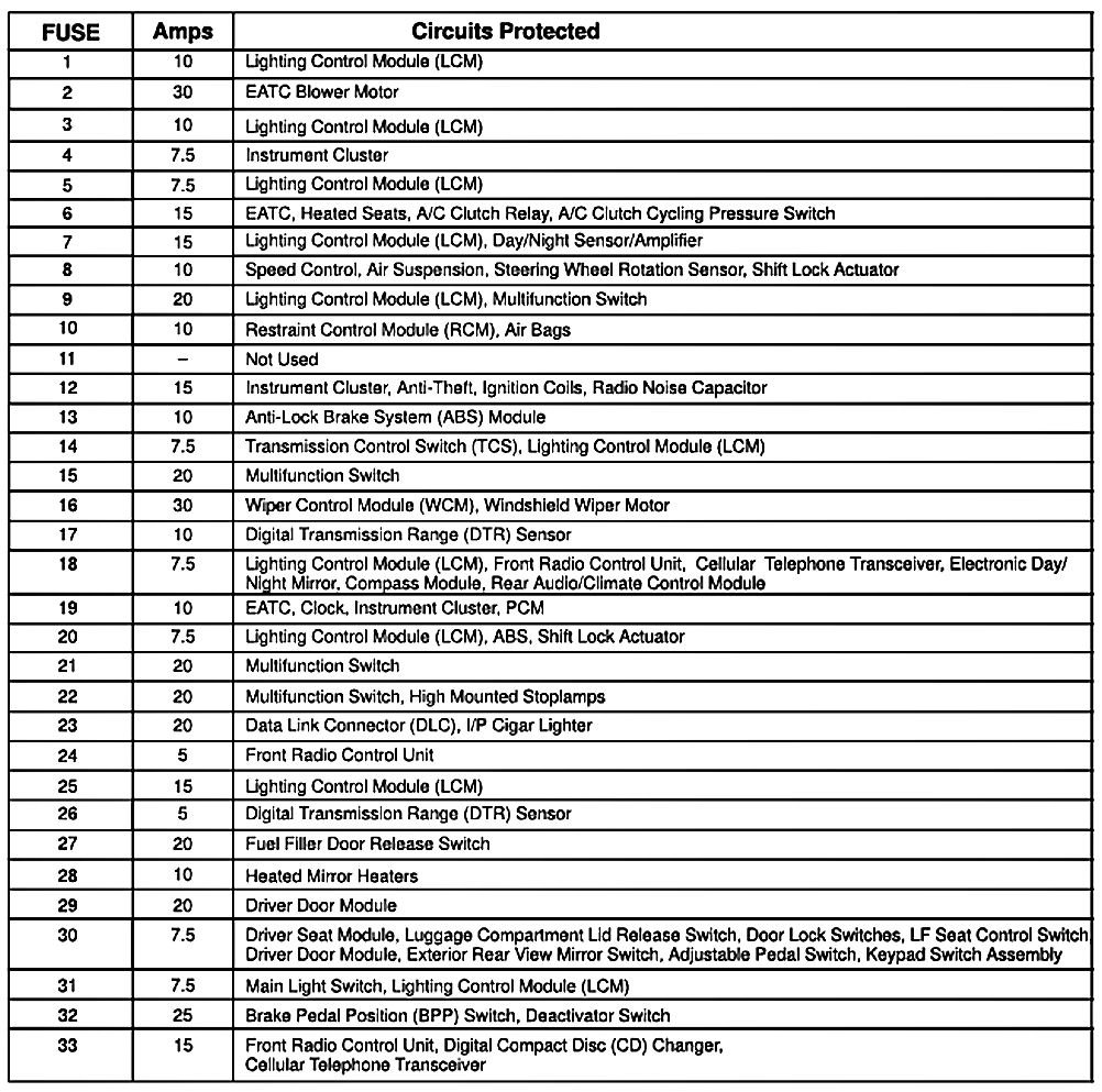

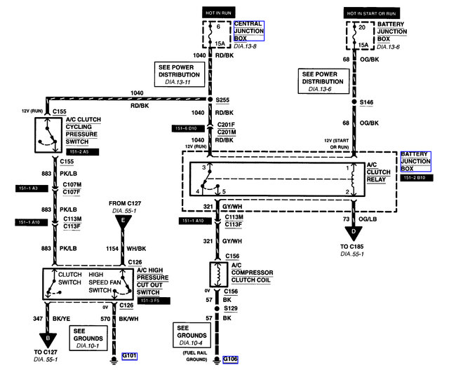

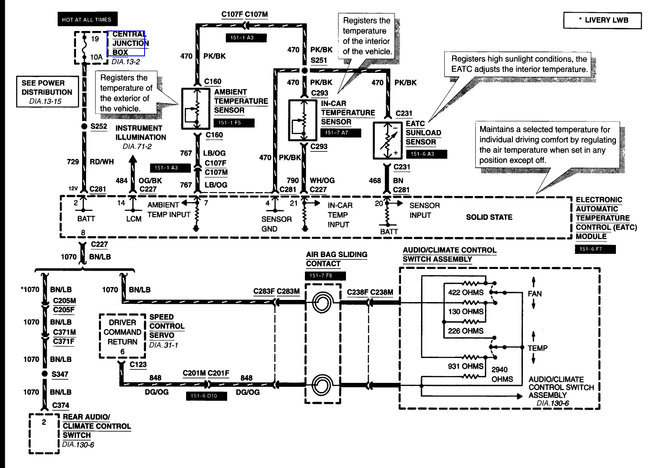

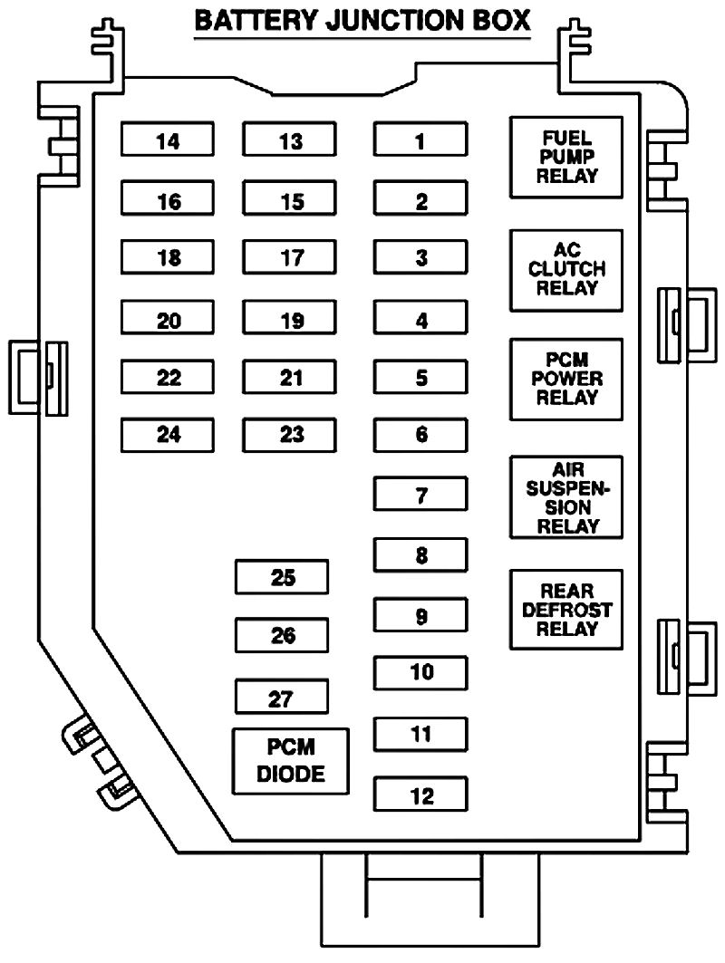

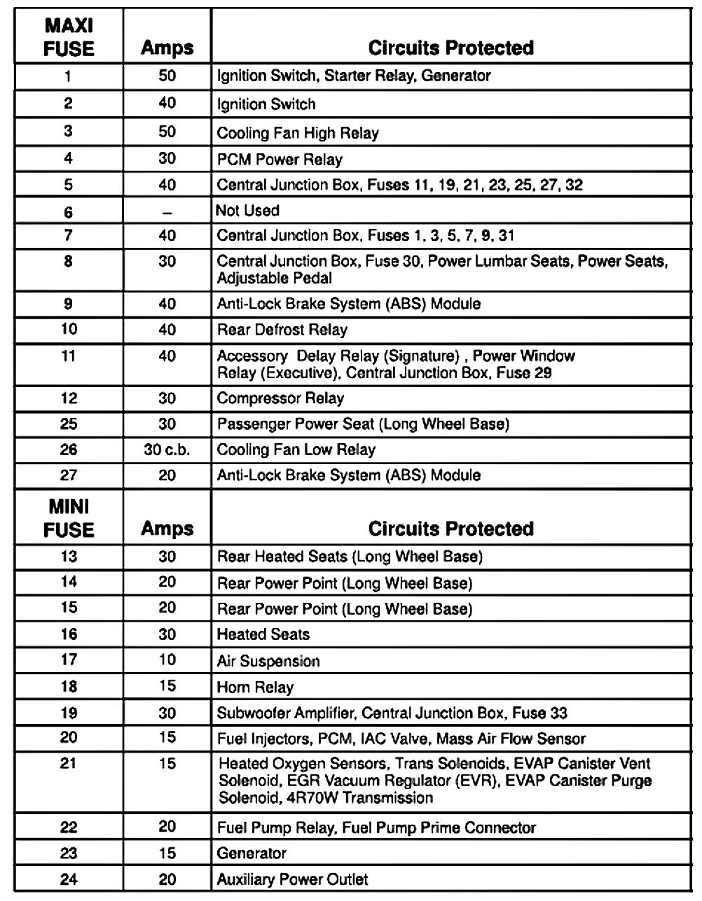

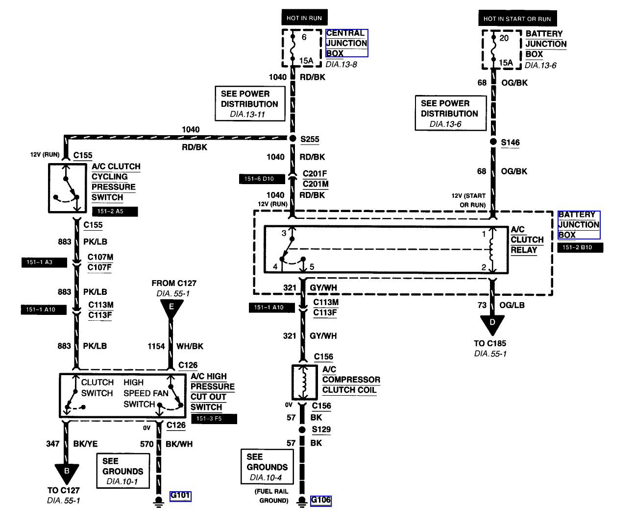

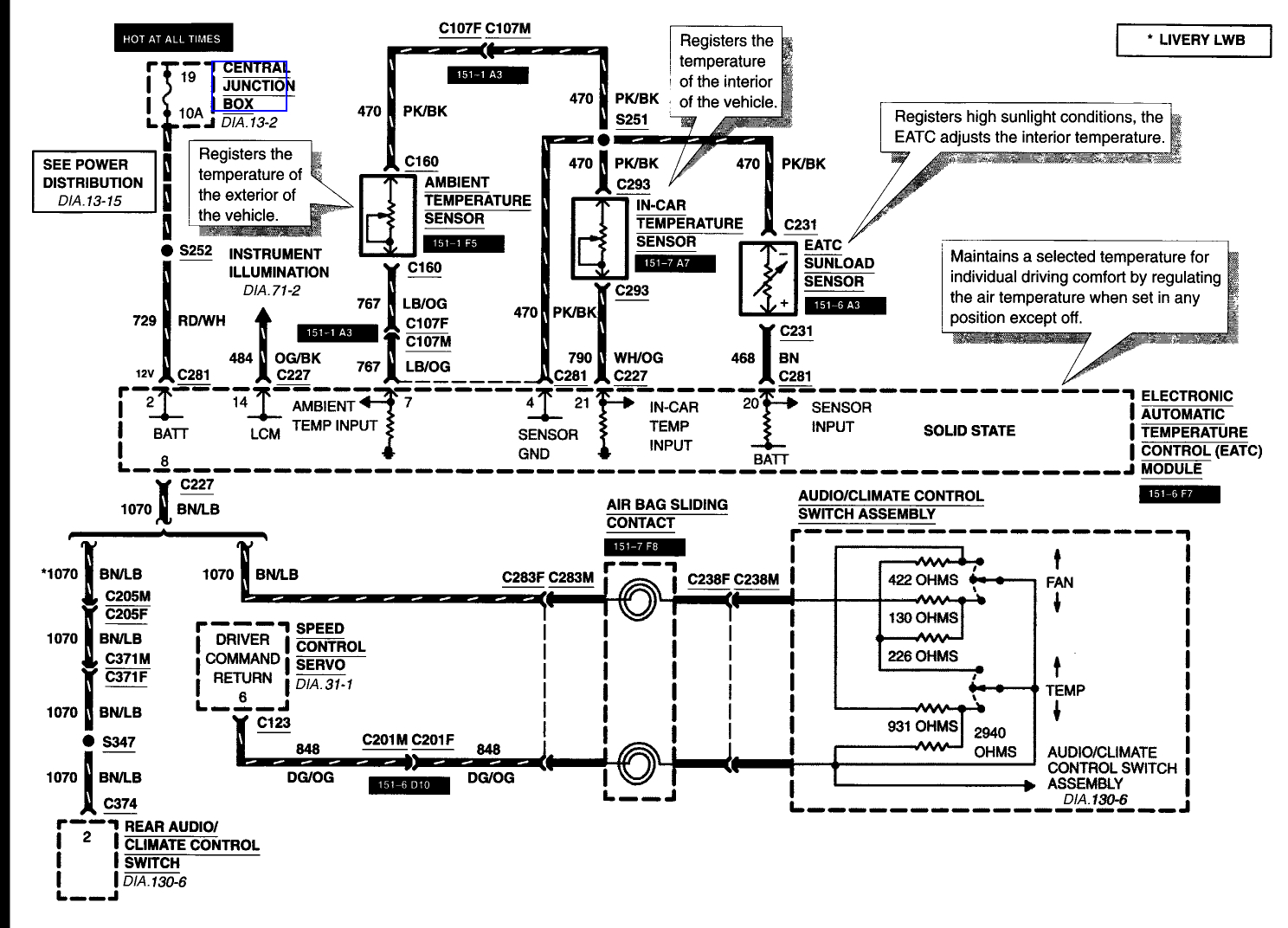

Here is the wiring for the system. Looking at it you have Fuses 6, 2, and 19 in the central junction/fuse box under the left side of the dash and Fuse 20 in the battery junction/fuse box under the hood.
If they all test good and you get nothing from the control head it is very likely bad.
