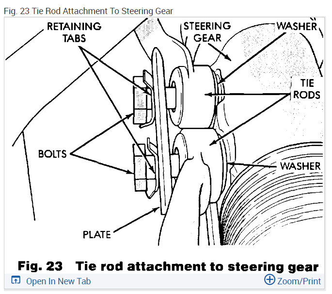

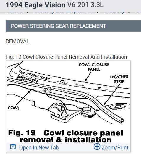

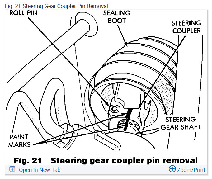

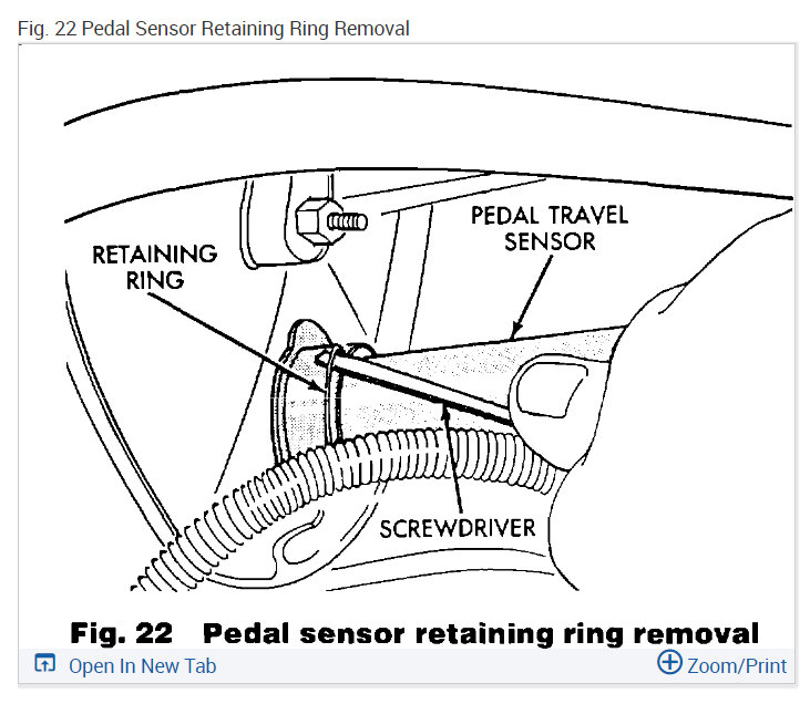

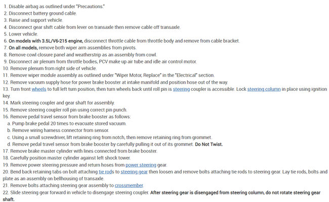

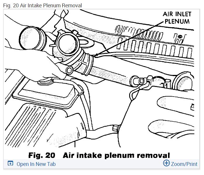

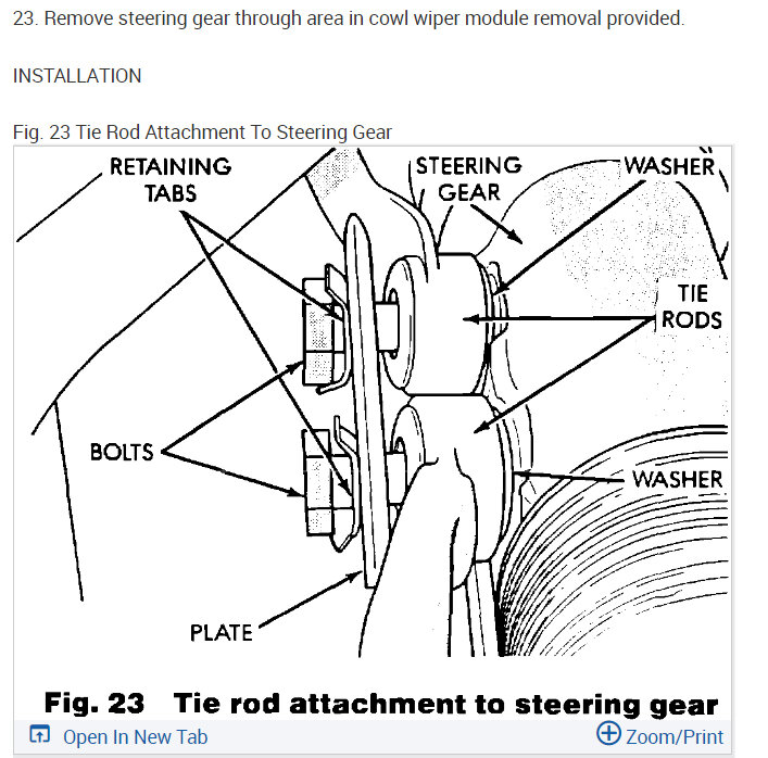

power steering works when turn right but not when turn left any ideas?
Feb 11, 2006 at 9:13 AM
2CARPRO BOB
  • 45 POSTS
Your symptoms suggest that your power steering rack is faulty. Here is how to change the steering rack out so you can fix the problem. Check out the images (below). Let us know if you need anything else.
