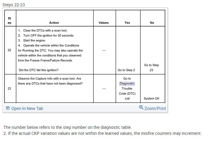

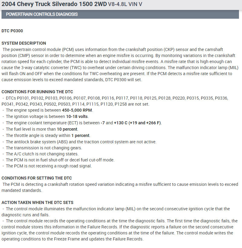

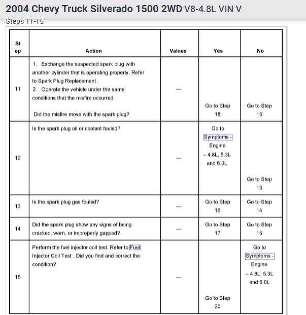

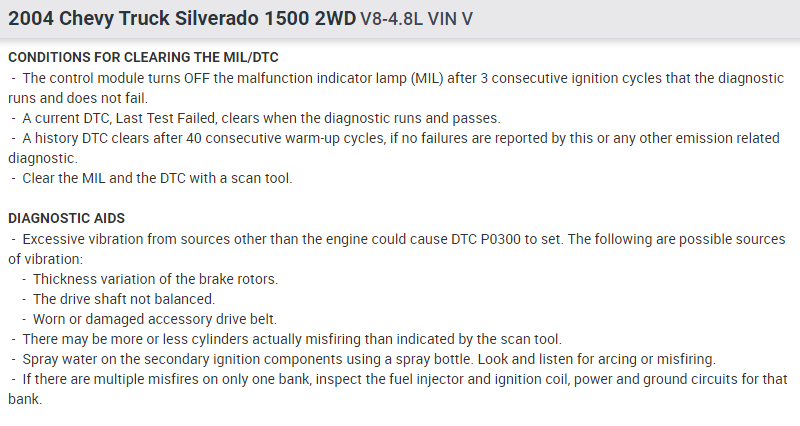

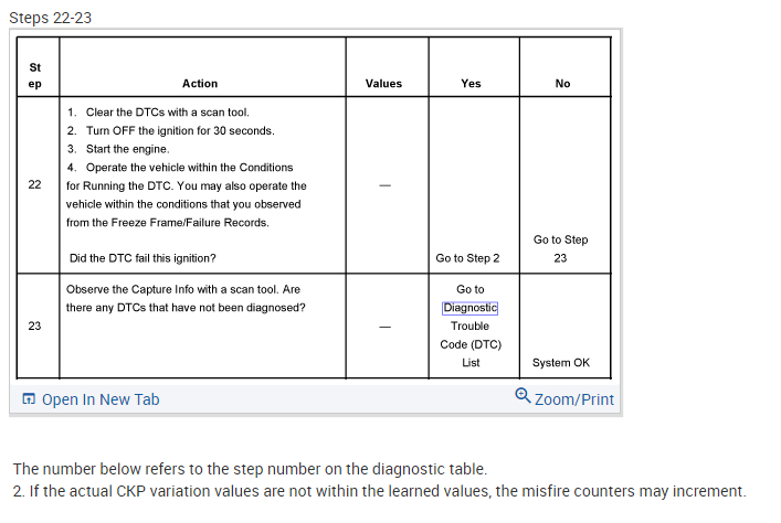

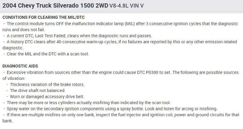

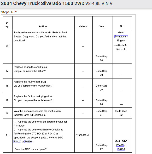

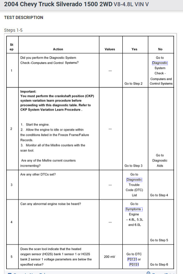

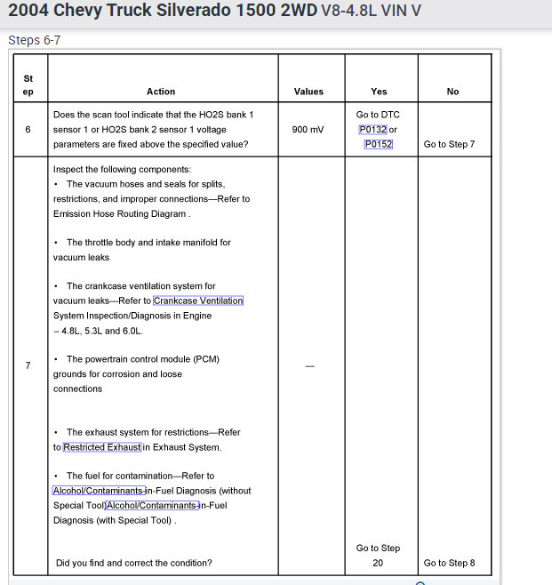

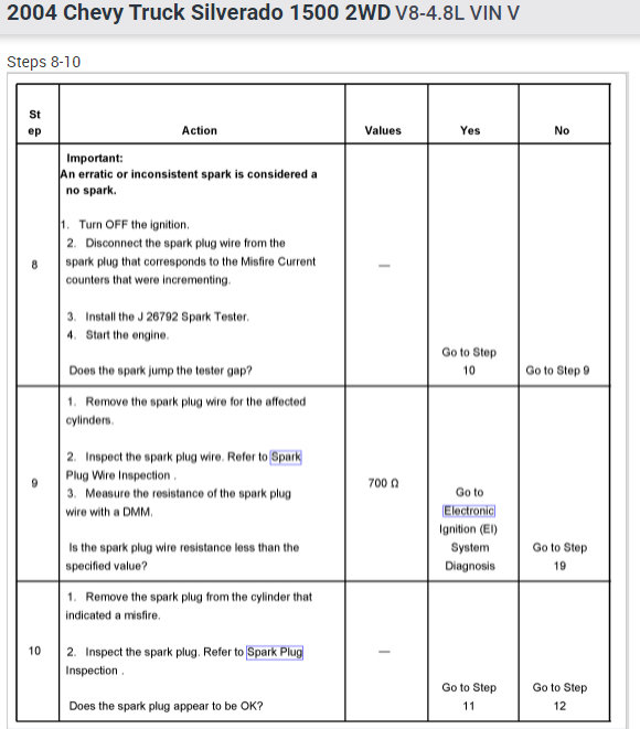

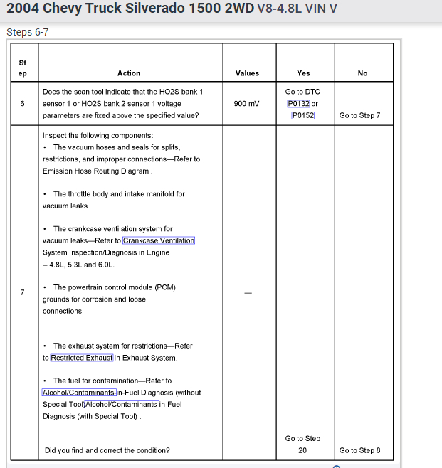

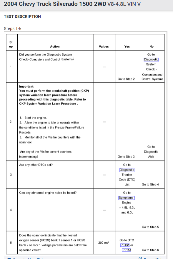

The code P0300 typically means that the on board diagnostics is unbale to connect with the powertrain control module.
Many times that code is related to the crank positing sensor not providing correct data to the PCM.
I have attached the step by step diagnostics for the P0300 code.

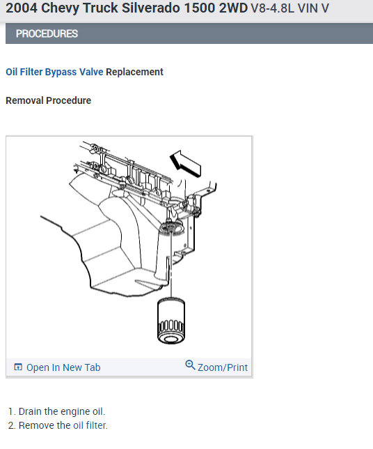

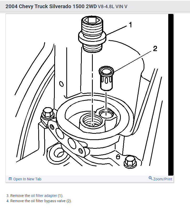

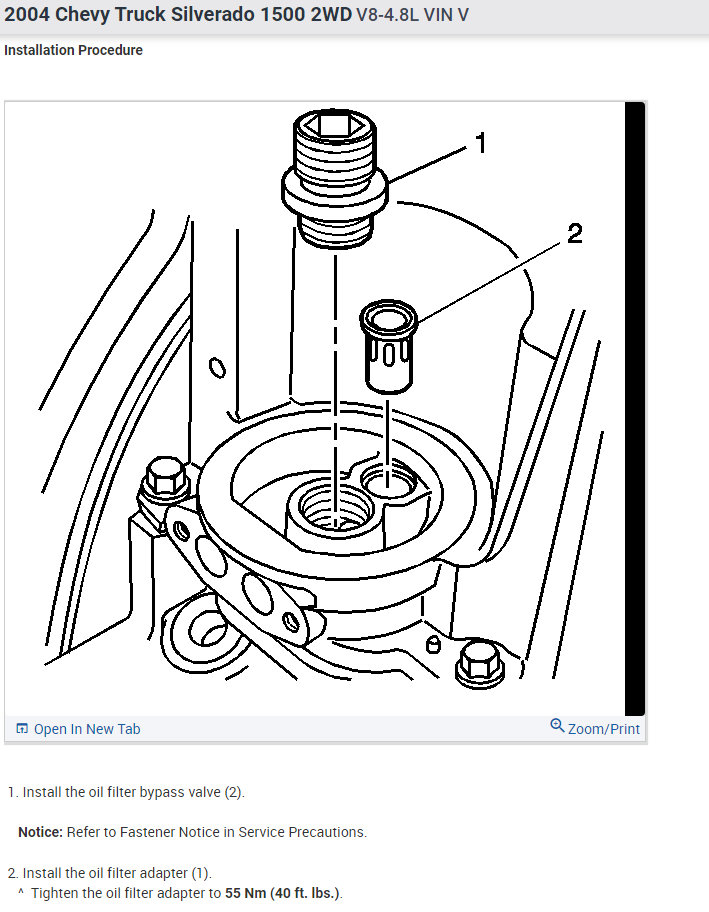

There is a oil pressure regulator valve, if it gets clogged it can impact the oil pressure and could trigger the noise. That valve is located inside the oil filter housing (see below diagrams of the valve)
