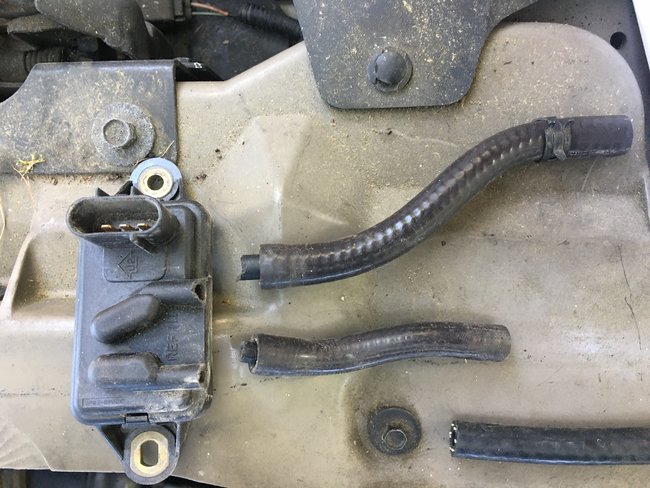

No I did not. I was under the impression that there were two different PTFE sensors and one had to have replacement hoses and one did not. And thinking I had the one that didn’t require new hoses, I didn’t replace them. So I guess I should try to find replacement hose for this? And will I need another new PTFE sensor? Or will this fairly new one still be usable?
Sep 11, 2019 at 8:18 AM
Yes, replace hoses. They are special hoses and different sizes.

Okay so I’ve replaced both hoses on the DPFE sensor. After starting engine, check engine light illuminates. I turn off the engine and extract 3 TDC codes: P0102- Mass Air Flow sensor circuit low, P0113- Intake Air Temp. sensor, and P0191- Fuel Rail Pressure sensor. From what angle should I tackle these codes?
Sep 22, 2019 at 6:57 AM
DOCTORD453
  • 46 POSTS
Oh I also replaced the DPFE sensor with a new one.
Sep 22, 2019 at 6:59 AM
DOCTORD453
  • 46 POSTS
A picture of the old DPFE sensor and the hoses with the sensor tips broken off in the ends of the hoses.
Sep 22, 2019 at 7:01 AM
