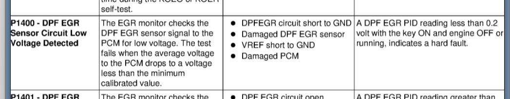

My Taurus has very low miles 41000, Out of no where the check engine light came on. I have an obII tester and got the code p1400. The car runs fine, no noticeable problems. I researched and saw there is a TSB bulletin regarding this trouble code. I can't seem to find a solution to this problem.

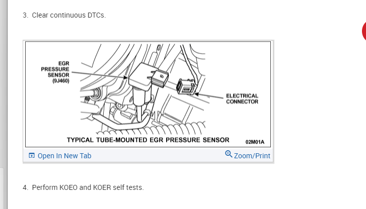

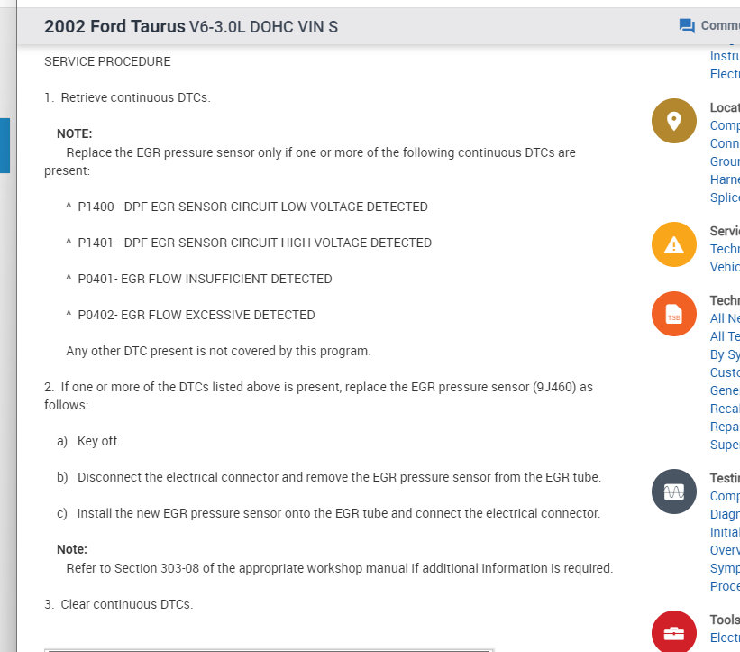

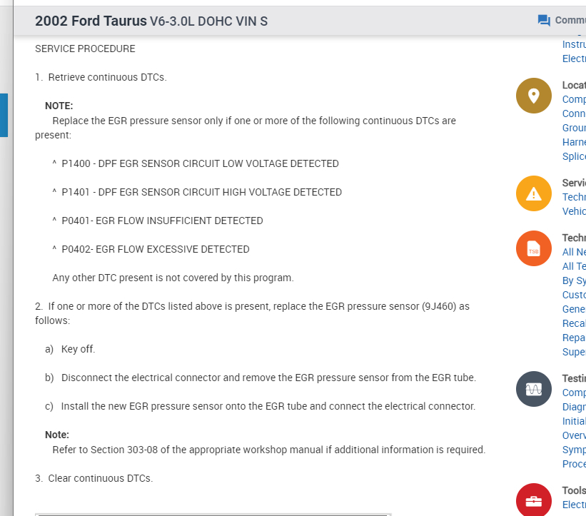

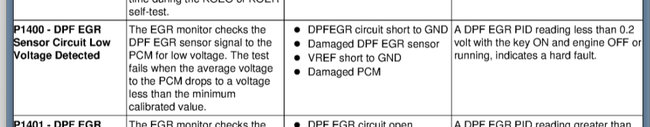

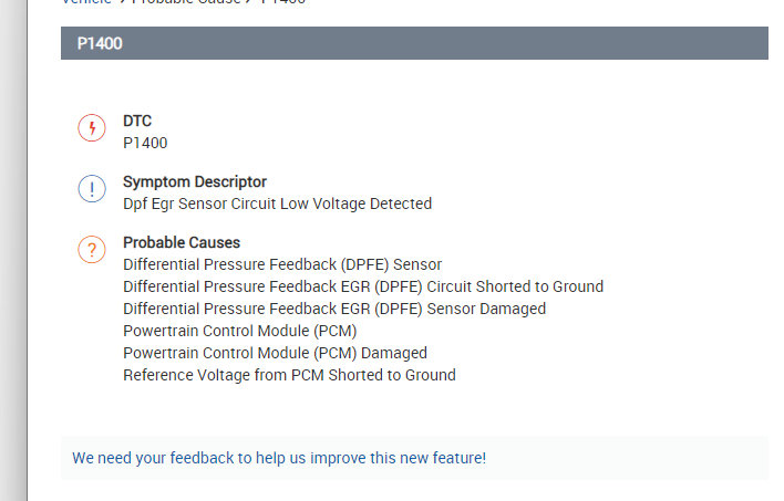

You are correct that there is a TSB and there is actually an extended warranty for this issue.
The extended warranty has run out on this part by now, but the repair is still the same.
So, I would suggest following the info attached and replace this pressure sensor.
Please run through the attached info and let me know what questions you have, and we can go from there.
Thanks
