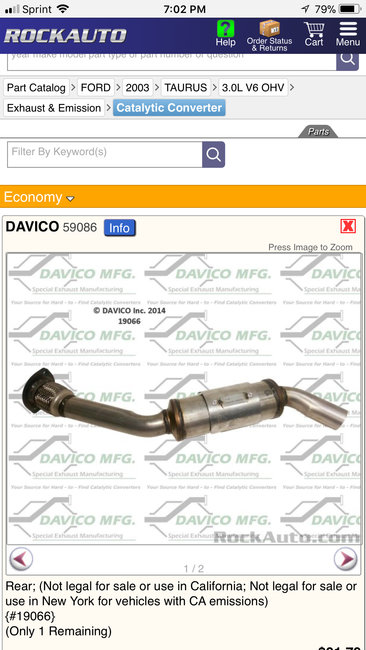

Thanks. Attached is the converter assembly from rock auto. You should replace with this assembly. there are several available but walker is the best brand to buy.
https://www.rockauto.com/en/catalog/ford,2003,taurus,3.0l+v6+ohv,1415214,exhaust+&+emission,catalytic+converter,5808

Now I am confused. Trying to locate exact catalytic converter. They have front driver side converters, front passenger side converters, center converters, rear converters, and y pipe converters. It appears the y pipe converters are for DOHC engines. Which I believe mine is an OHV and not a DOHC. So eliminating the y pipe converters leaves me with a front driver side, front passenger side, center, and rear to choose from. And the prices for these converters seems outrageous to me. Some of them are priced more than the car is worth. $2200 at one place. Would I be better off to buy a universal fit and take the car to have I welded on? Wouldn’t I come out cheaper this way?
Mar 13, 2018 at 11:16 AM
If you got the one from rock auto as I sent you and you took it to a shop and had them change it you would be looking at around 500
Mar 13, 2018 at 9:14 PM
DOCTORD453
  • 46 POSTS
That link to Rock Auto directed me to a page starting with Ford asking me for the year of car. Then it proceedes to ask for model, sub model, engine type, then the category or parts. Where I have to direct it to the page with catalytic converters. There are probably 15 or more different converters on this page starting with a rear converter, then a front y type converter, then a right converter. These are followed with several other converters including rear main converters as well as center converters. Knowing the engine group being 3FMXV03.OVF4 it still isn’t clear to me which of these converters I need. I apologize for the confusion. I am fairly knowledgeable about most vehicle trouble shooting and repair. But this is an area I have never encountered and therefore am not very familiar with. I thank you for your patience I in dealing with my issues.
Mar 14, 2018 at 4:44 AM
No worries. you said your 6 th digit was a U. This is the converter you need
Mar 14, 2018 at 4:48 AM
DOCTORD453
  • 46 POSTS
So just to clarify,
this Davidco, part #59086, rear converter for $91 is the right one?
Mar 17, 2018 at 9:09 AM
no, the 59071. the one you are looking at is a warm up converter. that is not the failure. it is the front 2 converters.
Mar 17, 2018 at 9:16 AM

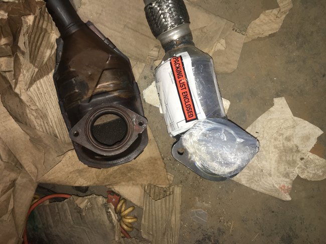

Well I finally got the old converter off. But the new one doesn’t have threaded holes in the flange gasket on one end like the old one did. And the holes on the other end of the old flange gasket holes had grooves in it where the splined studs fit into. Where the new one is drilled smooth. Can I just use heat resistant bolts to replace the old studs? Or does it need to be threaded and splined like the old one was?
Apr 5, 2018 at 6:50 AM
Can you post a picture of what you have
Apr 5, 2018 at 6:53 AM

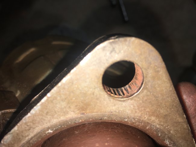

In this picture the old flange gasket bolt holes are threaded. Where the stud bolt passes through the other half of the flange and then threads into the converter side of the flange. Where the new one isn’t threaded and would need a nut on it to tighten down.
Apr 5, 2018 at 7:35 AM
DOCTORD453
  • 46 POSTS
This picture shows the old flange stud holes with grooves in it that the splined head of the stud goes into to hold the stud from turning when you put the nit on the other side of the flange.

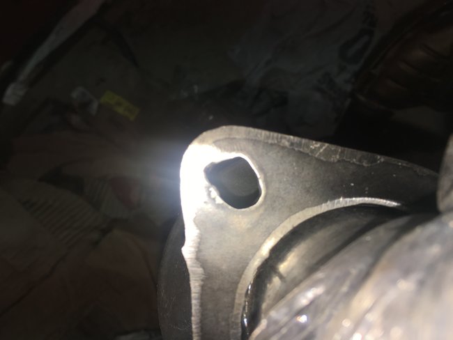

This picture shows the new flange bolt holes drilled smooth without grooves for the splined head stud to hammer into.
Apr 5, 2018 at 7:39 AM
nuts and bolts are good to use.

only the factory OEM would have all the studs pressed in. thats why it would run around 1200 for the part.
