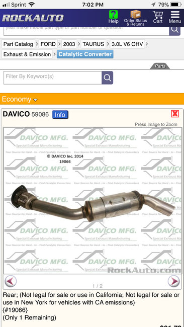

Thanks. Attached is the converter assembly from rock auto. You should replace with this assembly. there are several available but walker is the best brand to buy.
https://www.rockauto.com/en/catalog/ford,2003,taurus,3.0l+v6+ohv,1415214,exhaust+&+emission,catalytic+converter,5808
Mar 9, 2018 at 9:40 PM

So just to clarify,
this Davidco, part #59086, rear converter for $91 is the right one?
Mar 17, 2018 at 9:09 AM
no, the 59071. the one you are looking at is a warm up converter. that is not the failure. it is the front 2 converters.
Mar 17, 2018 at 9:16 AM

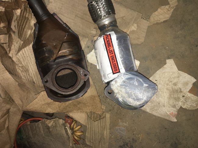

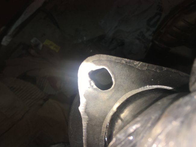

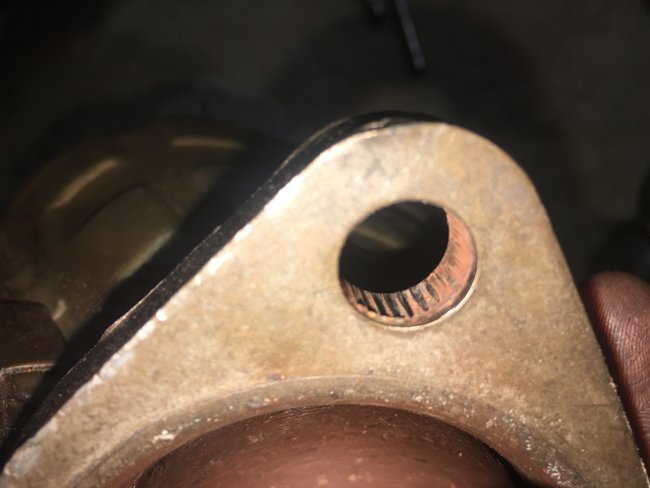

Well I finally got the old converter off. But the new one doesn’t have threaded holes in the flange gasket on one end like the old one did. And the holes on the other end of the old flange gasket holes had grooves in it where the splined studs fit into. Where the new one is drilled smooth. Can I just use heat resistant bolts to replace the old studs? Or does it need to be threaded and splined like the old one was?
Apr 5, 2018 at 6:50 AM
Can you post a picture of what you have
Apr 5, 2018 at 6:53 AM

In this picture the old flange gasket bolt holes are threaded. Where the stud bolt passes through the other half of the flange and then threads into the converter side of the flange. Where the new one isn’t threaded and would need a nut on it to tighten down.
Apr 5, 2018 at 7:35 AM

This picture shows the old flange stud holes with grooves in it that the splined head of the stud goes into to hold the stud from turning when you put the nit on the other side of the flange.
Apr 5, 2018 at 7:37 AM

This picture shows the new flange bolt holes drilled smooth without grooves for the splined head stud to hammer into.
Apr 5, 2018 at 7:39 AM
nuts and bolts are good to use.
Apr 5, 2018 at 7:40 AM

only the factory OEM would have all the studs pressed in. thats why it would run around 1200 for the part.
