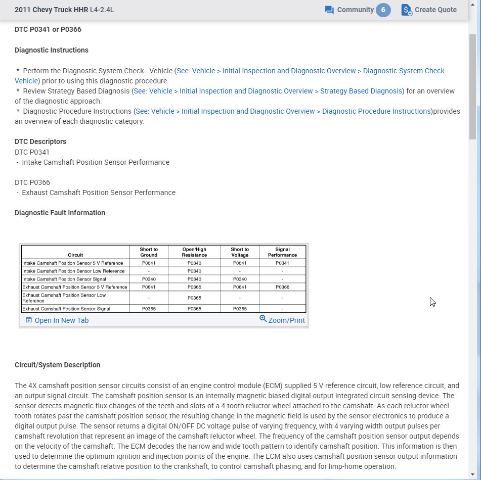

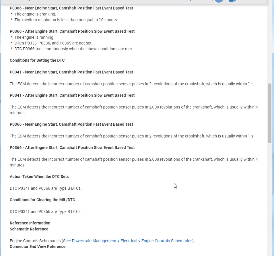

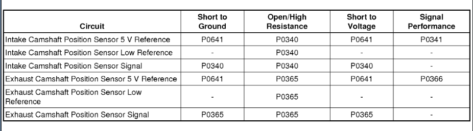

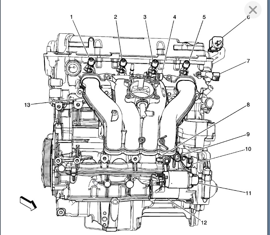

This is the code that came up on my vehicle. So do you have any pictures as to the location of these sensors? Thank you
Mar 20, 2020 at 10:27 AM

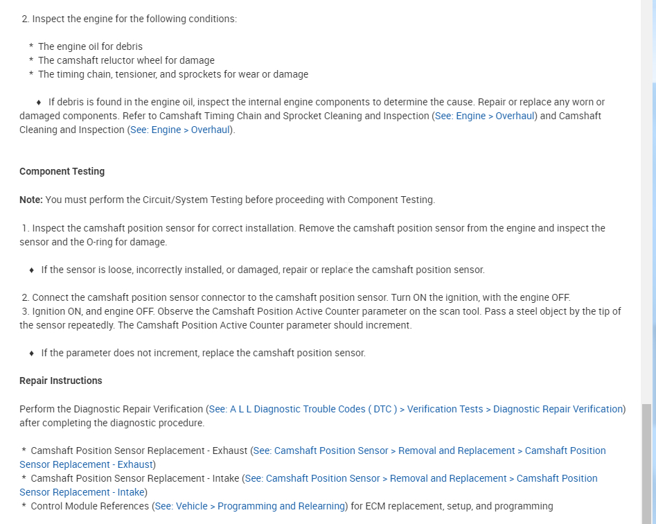

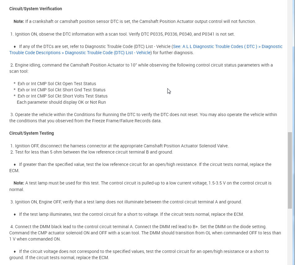

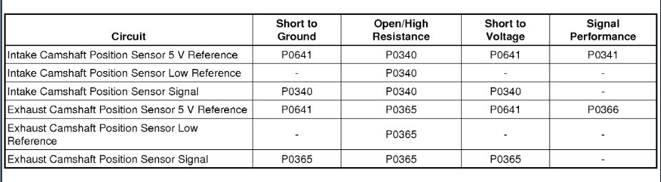

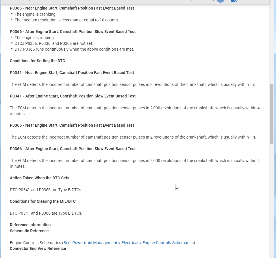

Here are the locations but also the testing for this code.
P0366 Camshaft Position Sensor B Circuit Range
Run through this and let us know if you have questions. Thanks.
Mar 20, 2020 at 10:40 AM

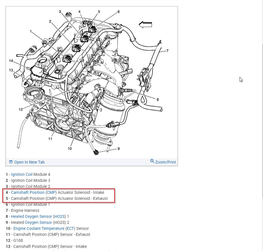

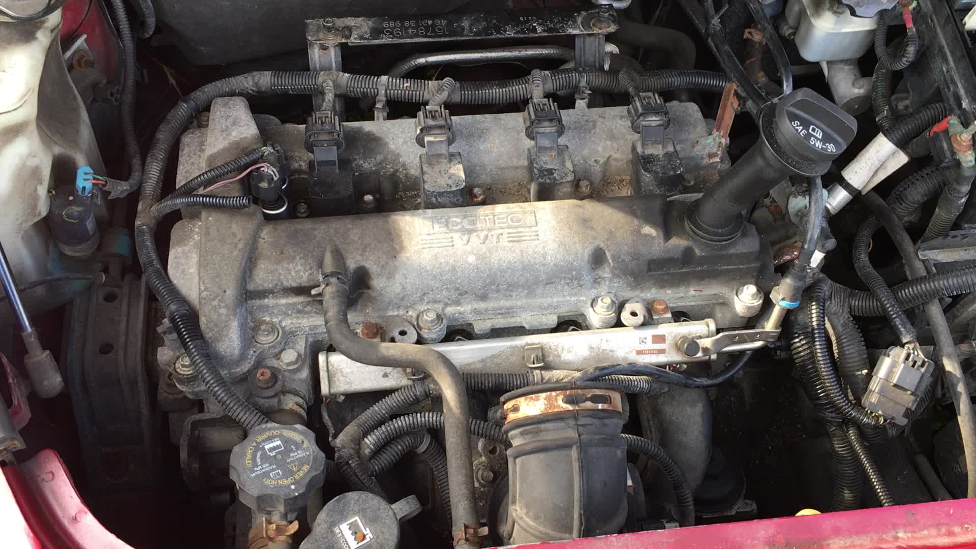

Back to the HHR problem after taking a break. I have ruled out the timing issue because the code reader is pointing to the sensor. If you recall in an earlier reply I replaced the wrong sensors. The two on the very top of the engine I thought was the correct sensor. Turns out they weren't. Is there a sensor A and a Sensor B? Also if I reset the code, would the engine restart if just for a short time for a diagnostics? Thanks
Apr 23, 2020 at 11:26 PM

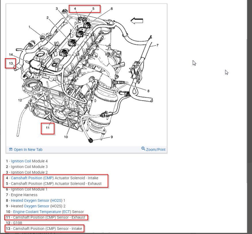

You don't have a sensor A and B you have an intake and exhaust sensor. They can be referred to as A or B but that is a little misleading. The code you had was for the exhaust sensor. Is that the one you replaced? Refer to the attachments. Number 5 was what the code P0366 is talking about. However, please refer to the testing I attached previously because there are other causes then just the sensor that can cause this and we need to go through the testing to find out what that is.
Apr 24, 2020 at 2:48 AM

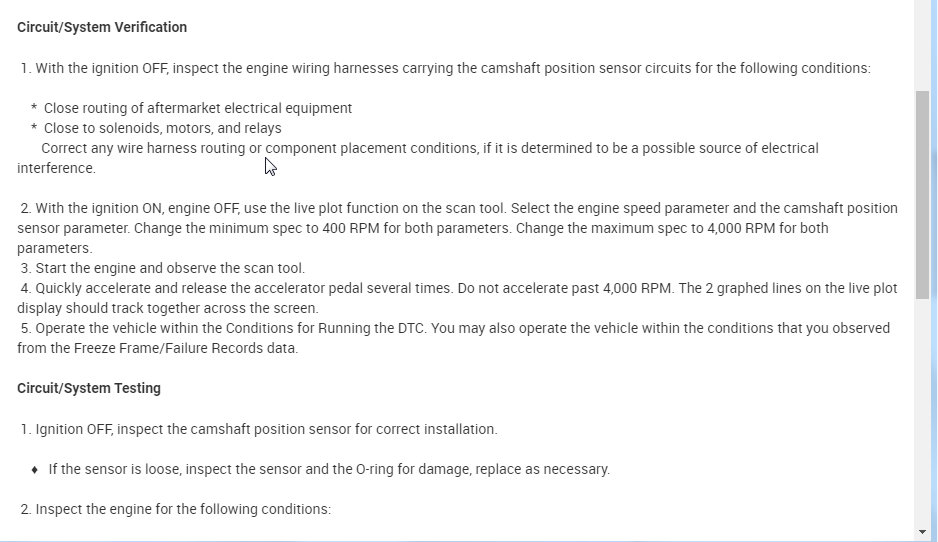

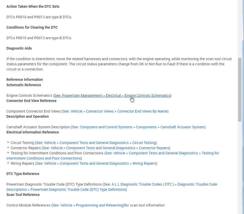

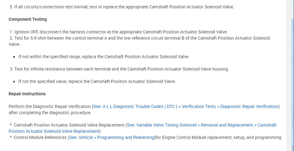

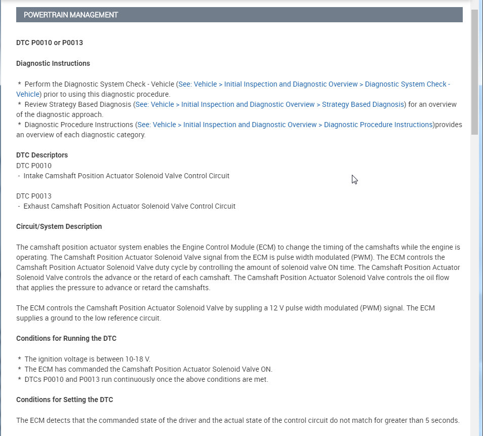

P0010 open circuit is the code I get now.
Apr 24, 2020 at 3:10 AM

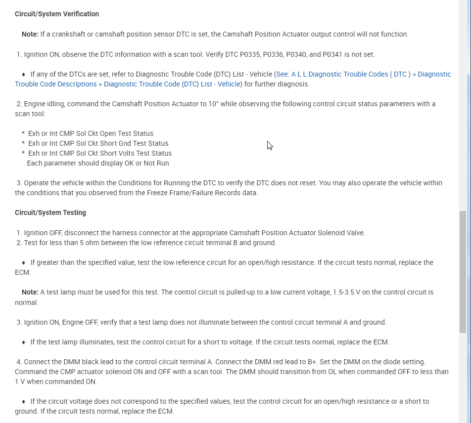

P0010 - Intake Cam position solenoid control circuit
Okay. Here is the testing for this code. Basically it is saying that the ECM has an open circuit to the intake cam sensor in this case. Again, we need to follow the testing to find the issue but most likely it is a wiring or connection issue.
Let me know if you have questions about this testing.

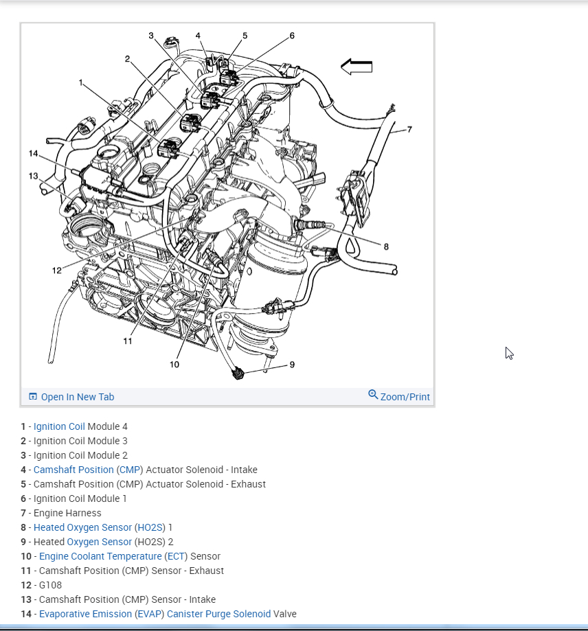

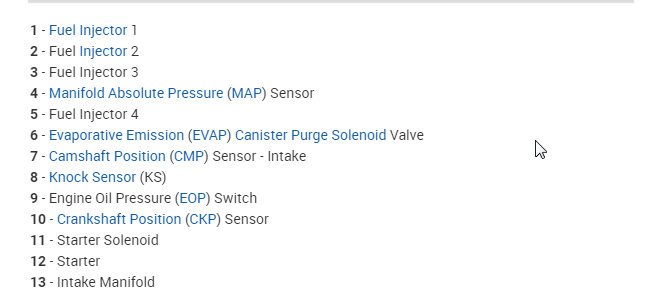

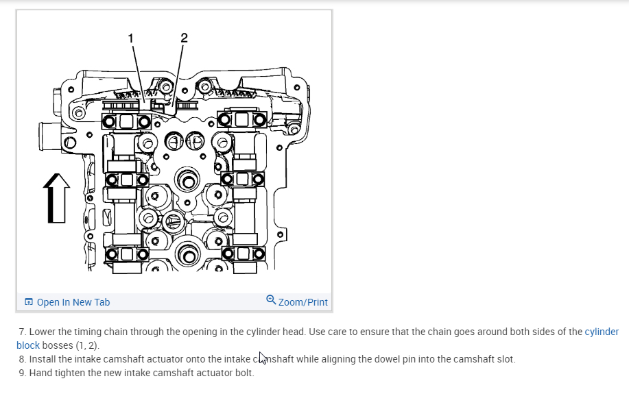

Still trying to resolve the HHR issue. I replaced the camshaft position sensor that is in the back top right hand side as I am looking at the engine. It was not hard to get to, but I can't seem to find the second location.
May 5, 2020 at 2:11 AM
The cam sensors are on the same side of the engine. Take a look at the diagram. Looks like you got number 11 and now need to get number 13. I thought prior that you were talking about the actuators which are on the other side of the engine. The diagram shows each of them for you to find them.

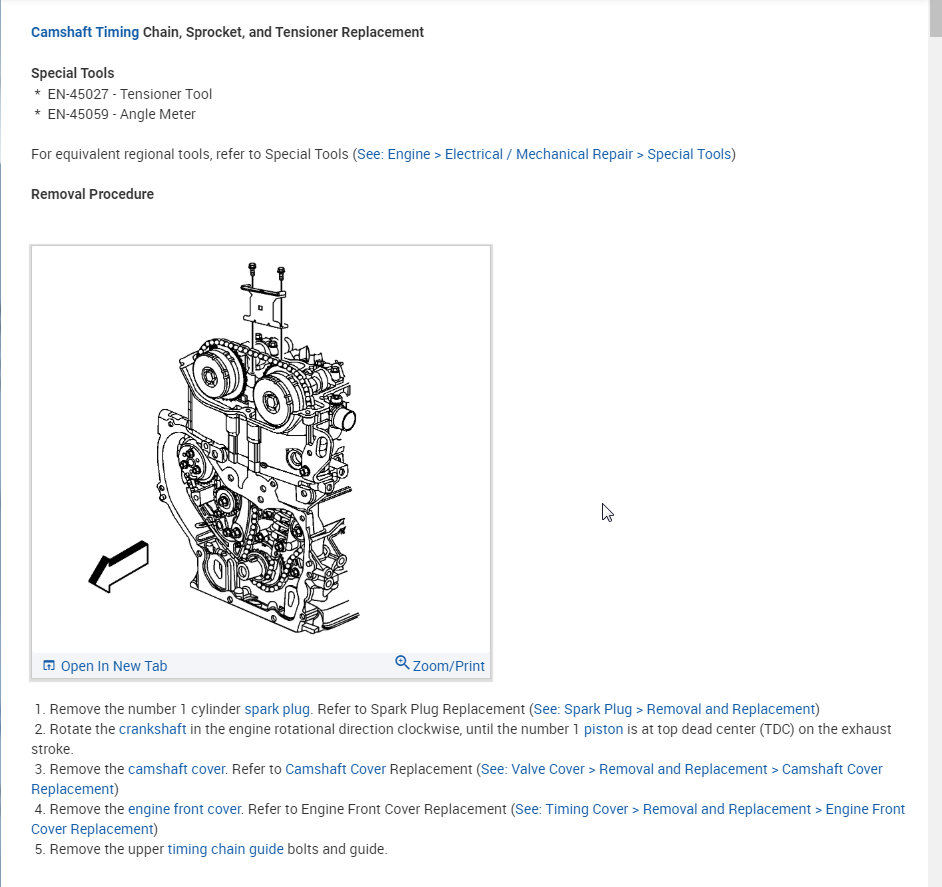

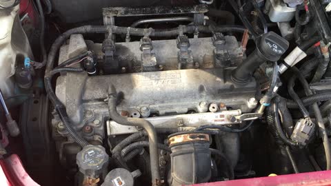

I was able to locate the last sensor I needed to replace which was actually almost in plain site. Issue still the same although I hear what appears to be trying ti fire. Question, if I remove the valve cover, can I detect any issue with the chain before resorting to tearing it down?Before this all happened, my son told me that he heard noises coming from the chain case area. Thanks, Mark

Well, the sensors never worked. It does sound like it wants to fire now but my greatest fear is the timing chain because I have replaced everything else. The scanner tool still reads camshaft sensor Bank 1. For some reason my scanner does not want to erase the code.

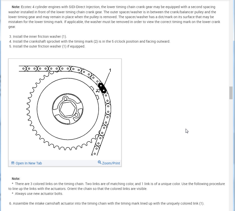

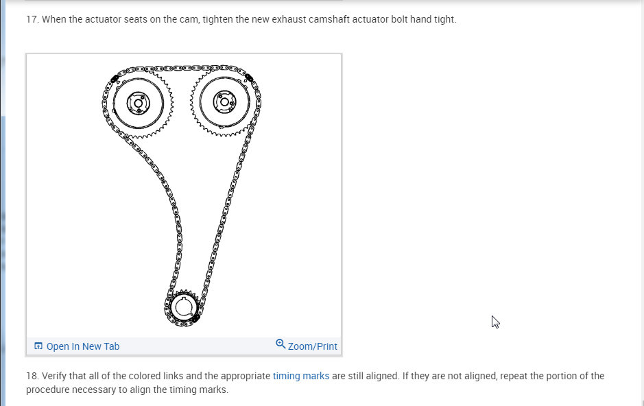

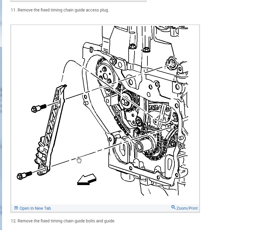

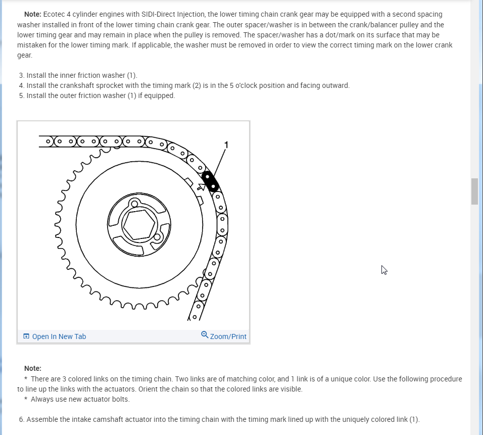

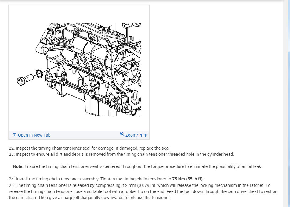

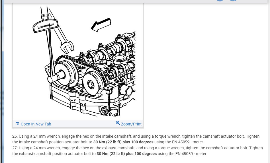

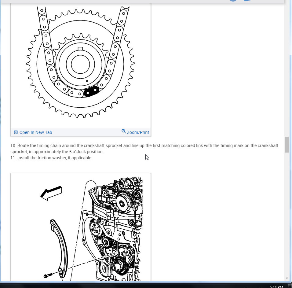

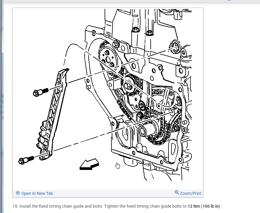

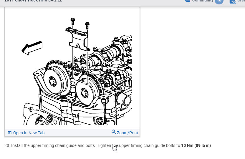

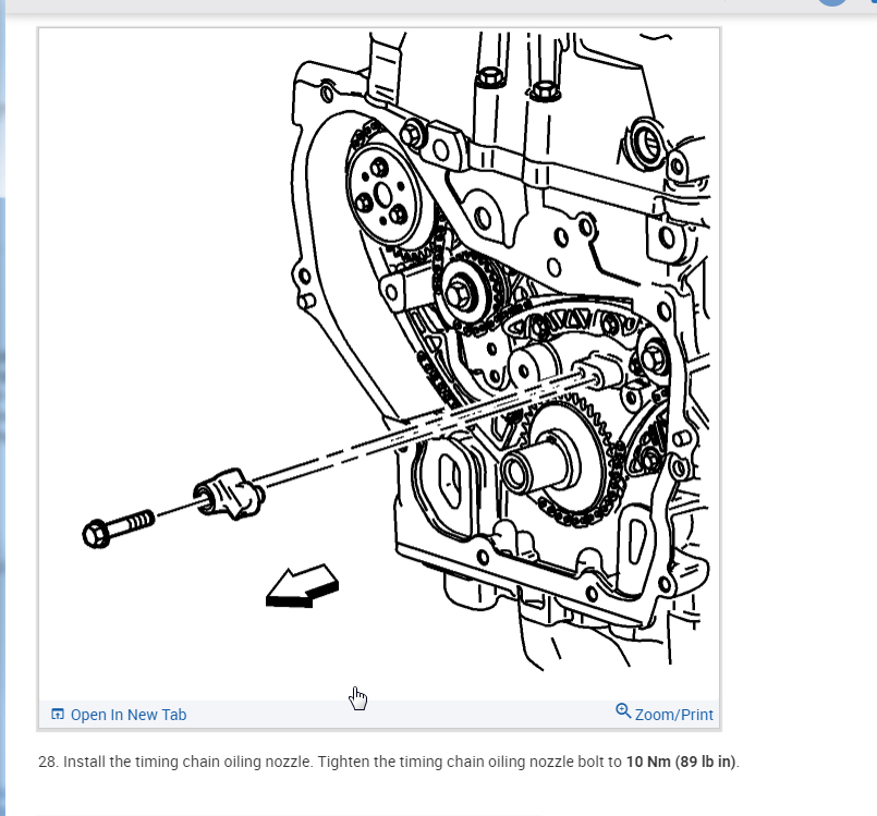

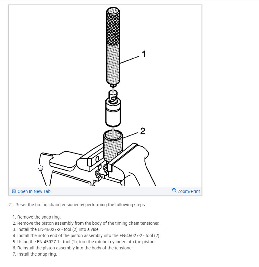

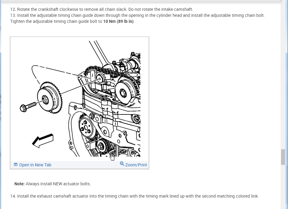

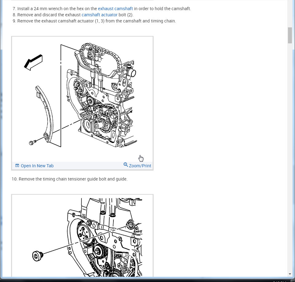

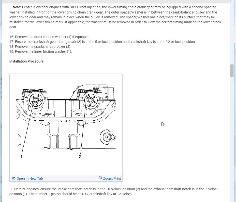

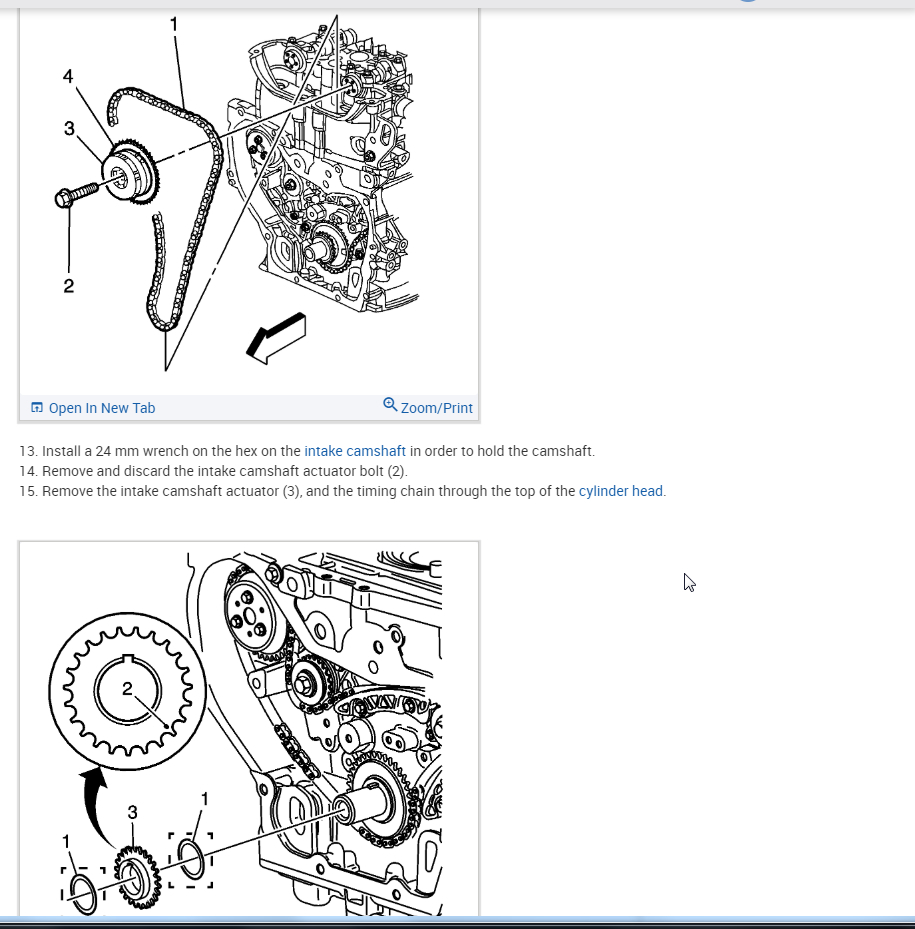

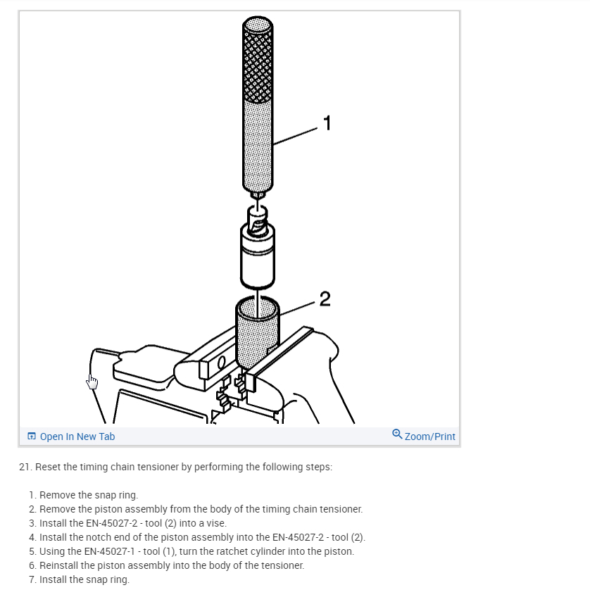

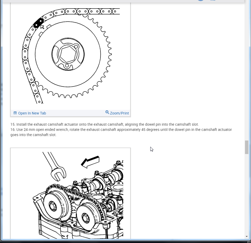

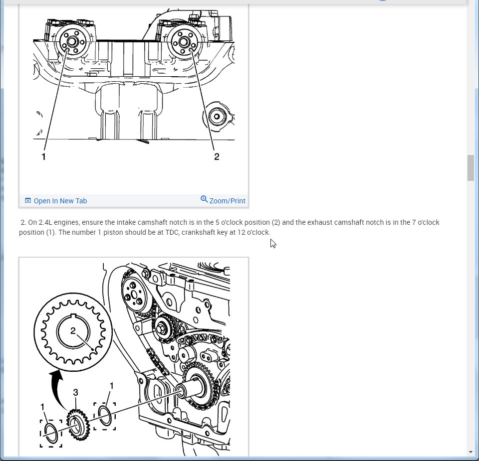

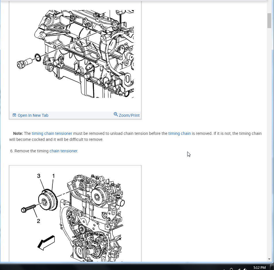

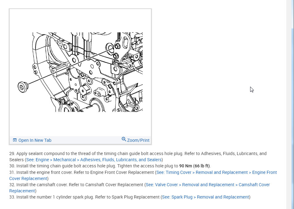

I hate to say it but your fears may be accurate. That is what an engine that is out of time sounds like.
I included the entire process for the timing chains. Let us know what you find. Thanks
May 8, 2020 at 7:19 AM
