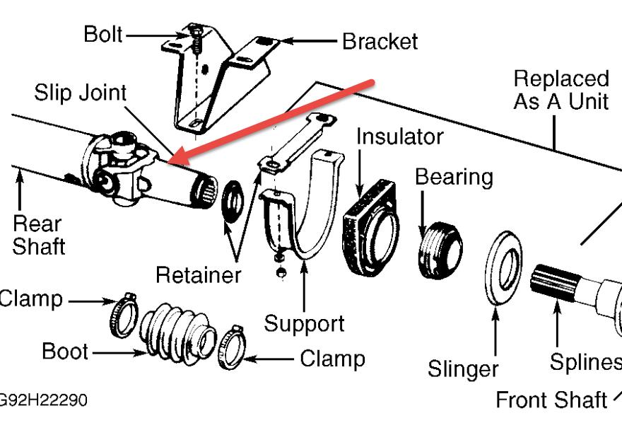

My rear driveshaft came off yesterday, both u-joints broken. I also lost the part that goes into the rear of the transmission and connects to the driveshaft. I do not know what this part is or called but it connects the drive shaft to the transmission.
Nov 23, 2014 at 2:00 AM
HMAC300
  • 48,601 POSTS
it's called a yoke and you need the one that goes to trans. it will be similar to the one in pic. Try a junkyard or a driveshaft rebuilder if you have one in your area.
Nov 23, 2014 at 3:42 AM
RONSHAWN
Thank You, that is what is missing.
