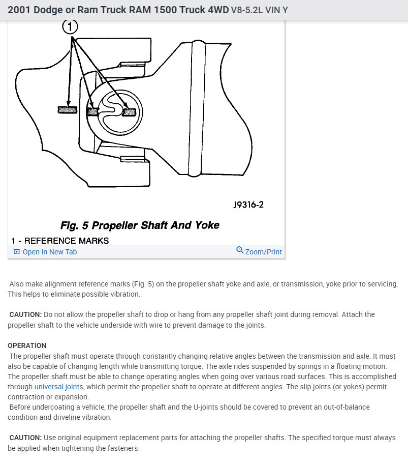

I was wondering aprox. price to have a new u-joint installed?
Dec 2, 2008 at 2:33 AM
SQM
  • 6,383 POSTS

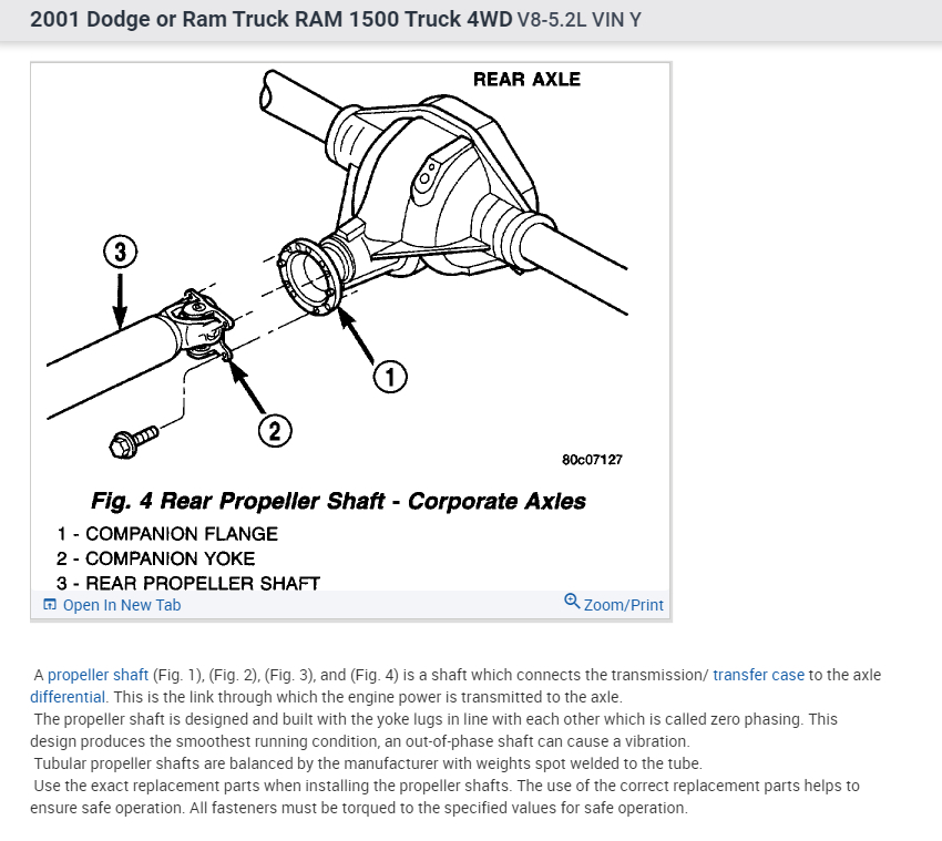

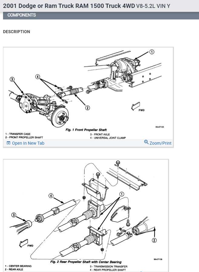

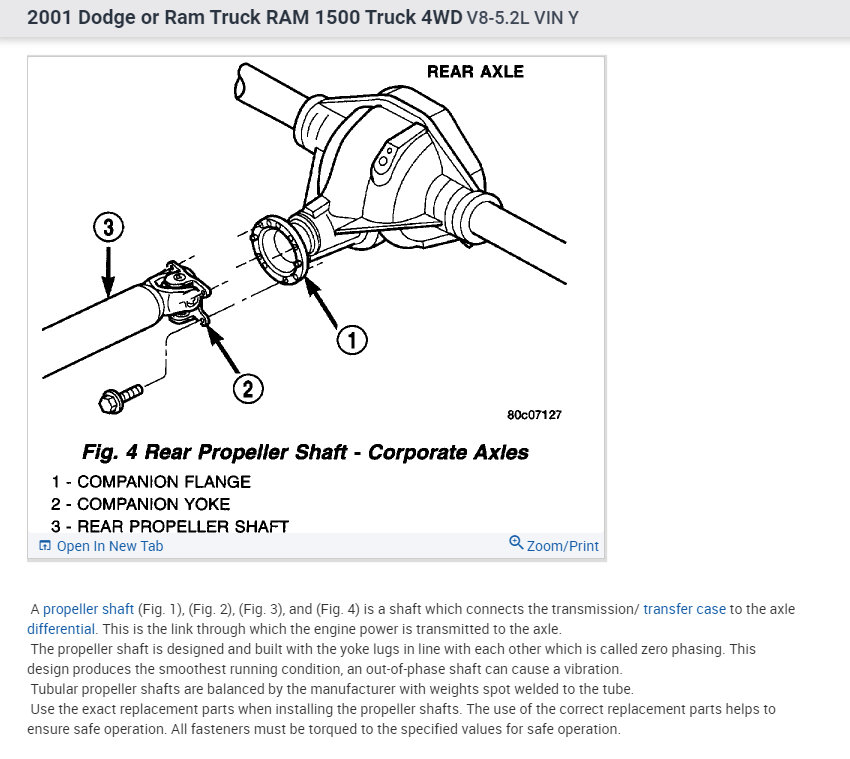

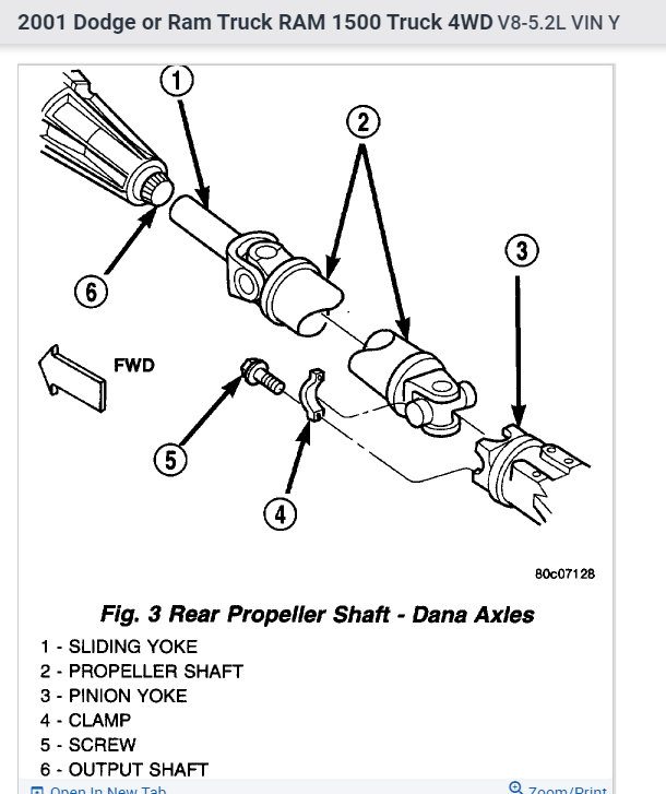

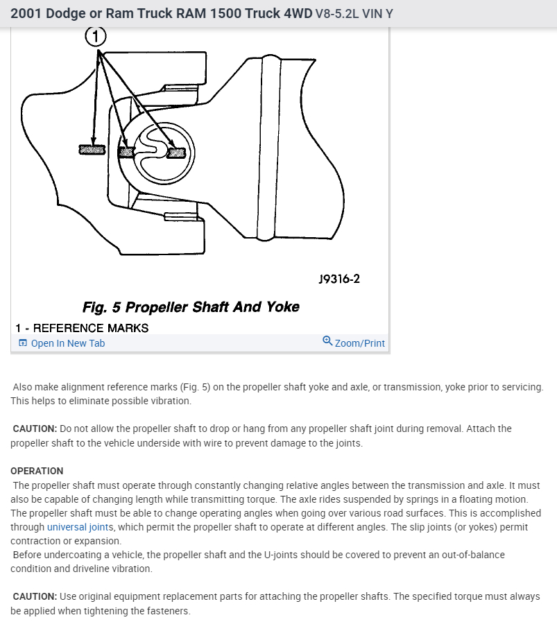

The U joints can be replaced using can be done using most basic hand tools. It will be helpful to have a large C clamp to help with the new joint installation.
Typically, a U joint will cost between $15.00 to $25.00.
Please note that labor rate for U joint installation will vary depending on the shop. As they all have different labor rate.
Here is a helpful guide:
https://www.2carpros.com/articles/how-u-joints-work
