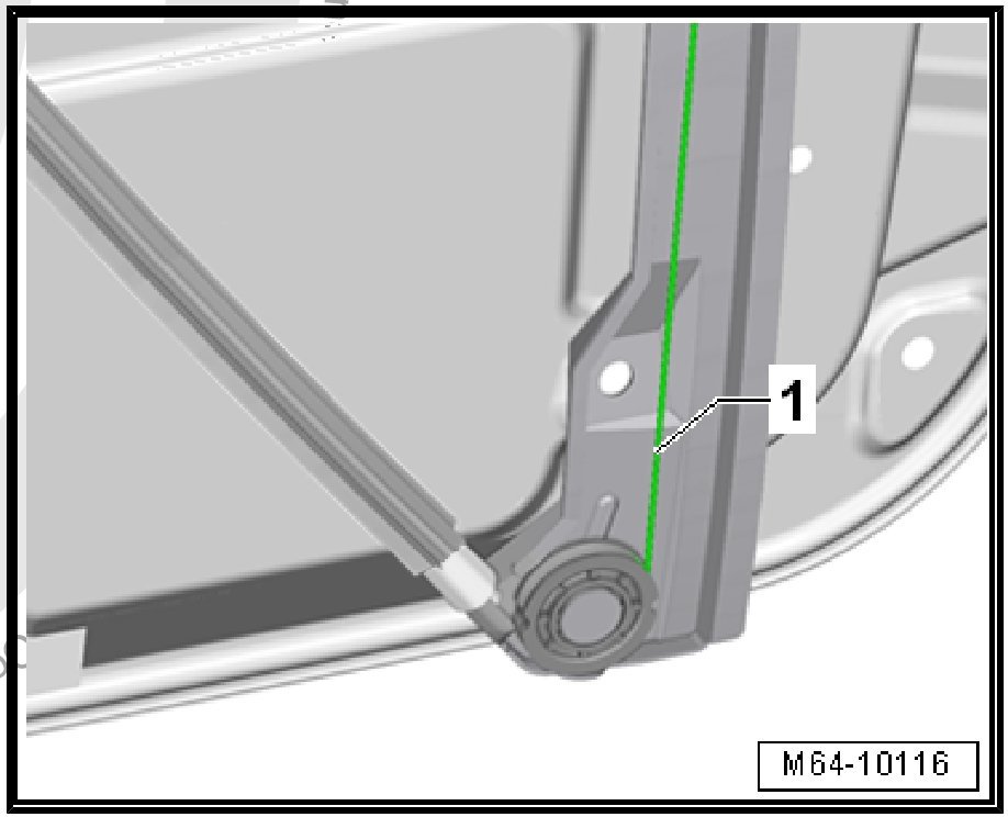

Took both door panels off as window rolled up 3/4 of the way. was checking regulators when the cable wiring harness fell off and i have no idea how to reinstall it correctly.

I don't have anything specific to just the cable. However, when replacing the regulator, the cables are involved. Here are the directions for removal of the regulator and cables. The directions show removal, but for install, it says it's the reverse of removal. So, you will need to follow the directions in reverse order. The attached pictures correlate with the directions.
I hope this helps.

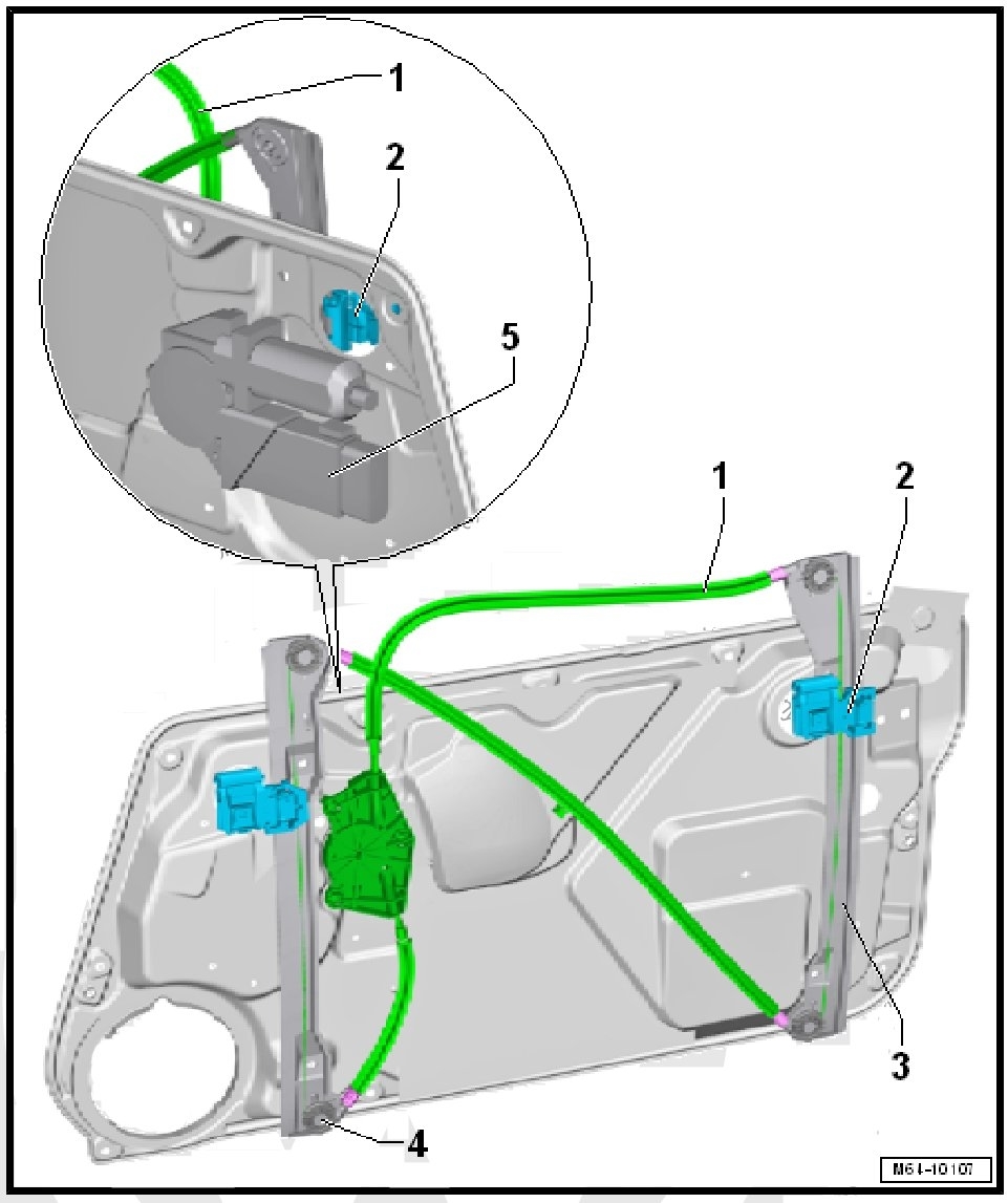

1 Tension wire with cable guide housing
2 Sliding show - replace as a pair
3 Window regulator with carrier plate
4 Guide roller
5 Window regulator motor

Note: The reference point for installing the tension wire is the guide roller with position -4- at the bottom left.
- Route the tension wire -1- for the left lower roller and secure.

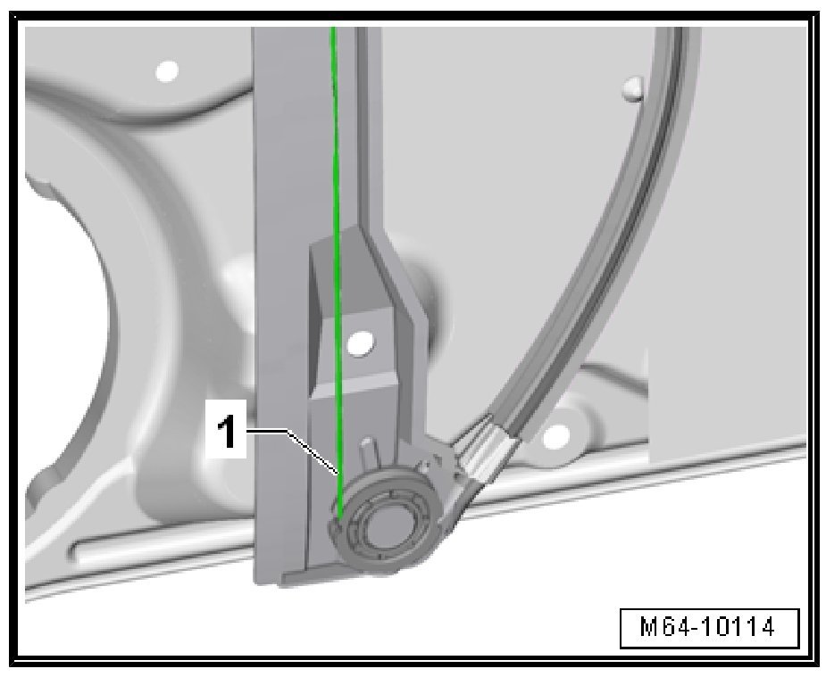

pic 2
- Engage the tension wire on the sliding shoe -2-.
- Route the tension wire -1- to the left upper roller and secure.
- Re-install the sliding shoe.

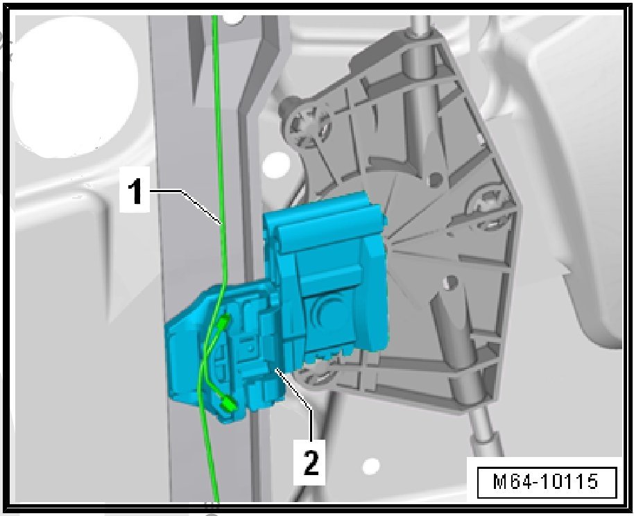

- Secure the tension wire in the lower right roller according to the illustration and engage in the sliding shoe.
pic 3
- Install the sliding shoe.

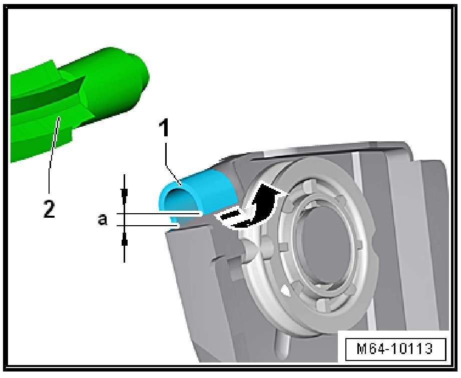

pic 4
- Widen the tab from the upper roller -1- in the area -a- with a suitable tool (pliers) from 5 mm to 8 mm.
- Secure the tension wire -2- on the roller and then engage in the tab.
- Careful shape the tab back to the dimension 5mm.
- Remove the fastener mechanism from the cable guide housing.
- Apply Guide Rail with Lubricating Grease - G000045003-.
- Check the routing of the new tension wire again.
pic 5
- Remove window regulator motor -5- from window regulator.
- Remove plugs -3-.
- Remove combination nut -2-.
- Unclip window recess cable.
- Move window regulator to center of door and remove.
Installing
- Installation is performed in the reverse order of removal.
