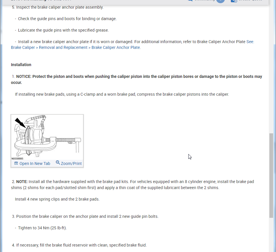

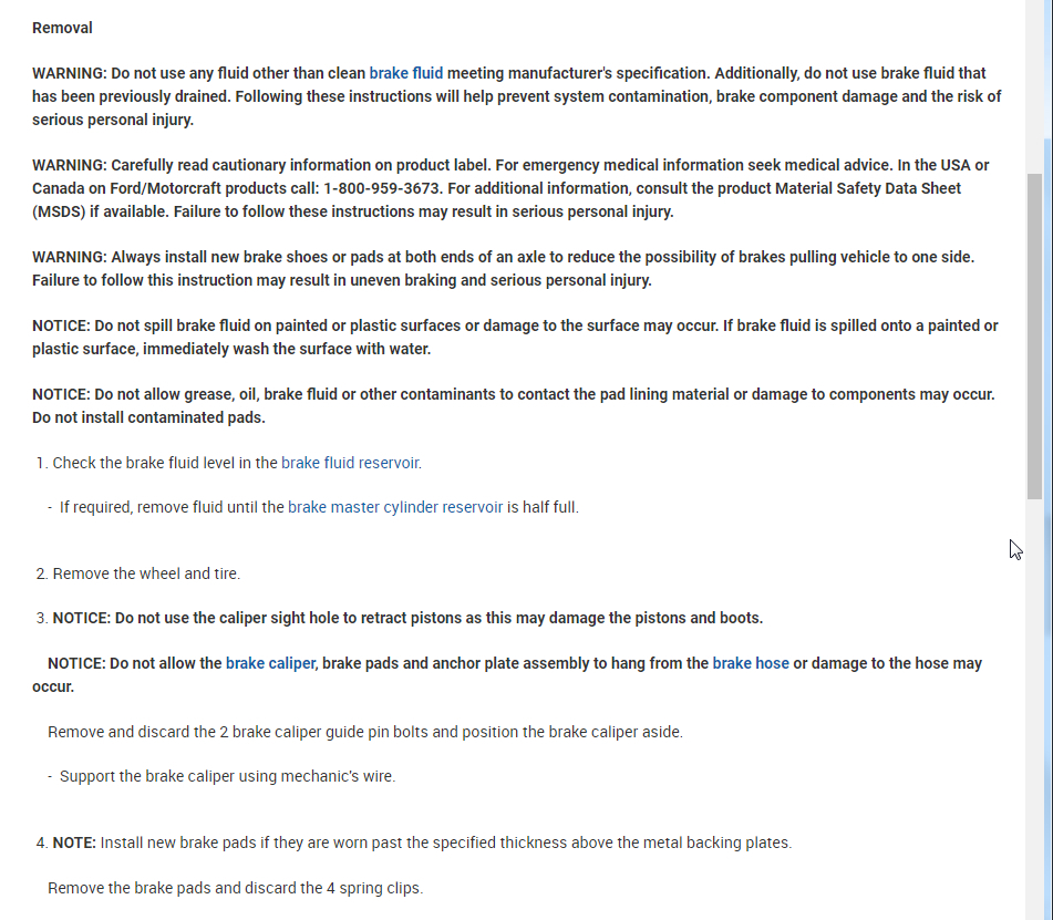

Sounds like the caliper is not releasing. The easy way to confirm this is to get the wheel jacked up and spin it to feel the resistance and then crack the bleeder on that caliper and spin the wheel. If the resistance is less or gone then the caliper is dragging and needs replaced.
Either way you are going to have to bleed the brakes after this. However, here is a guide that will help with this:
https://www.2carpros.com/articles/how-to-bleed-or-flush-a-car-brake-system
Also, here are some guides that will help with replacing the caliper and brakes again:
https://www.2carpros.com/articles/brake-caliper-replacement

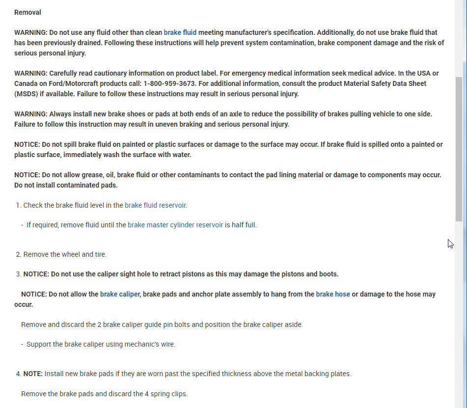

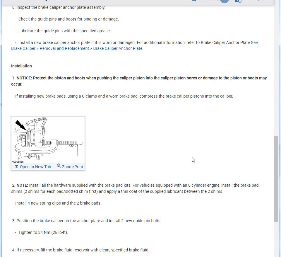

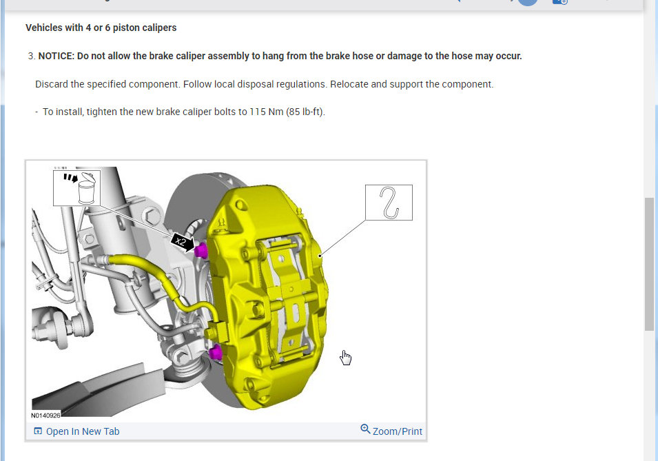

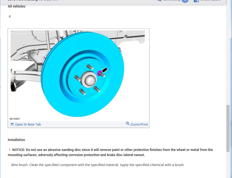

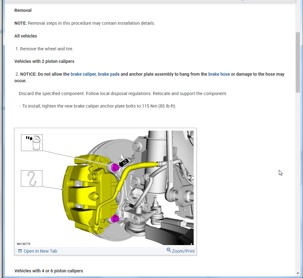

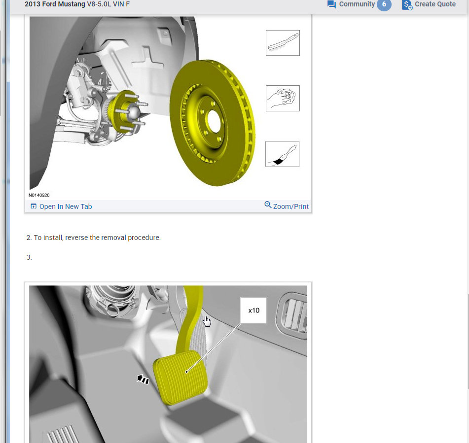

Lastly you will find below the process on how to replace them from the manual if you need this as well. Thanks
