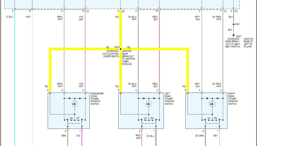

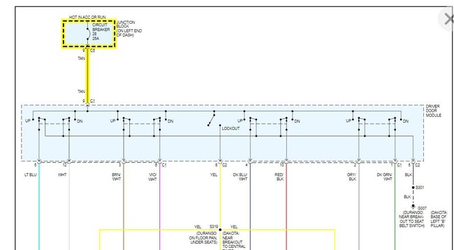

Every other window works fine. There is no power to the connector plug. I ran a hot wire to the regulator to make sure that is not the issue, it works just fine. Also passenger front door window only works from the switch on the driver's door. Not too sure where to go from here minus rerouting wires all the way through the door. Any advice or positive/helpful input is appreciated!!
May 20, 2020 at 9:18 PM
Good morning,
Check the tan wire at the drivers switch for power. That comes from the circuit breaker for power for the system.
Check the yellow wire as well as that is the output for the other switches for operation.
I attached wire diagrams for you to view.

Okay, thank you. I only have a test light, do not have access to a voltage meter. Did not show power to the regulator on the corresponding colored wires, if that makes sense. One being solid white and the other a solid sky blue. I will check the wires you indicated with the diagrams. I appreciate the in put!
