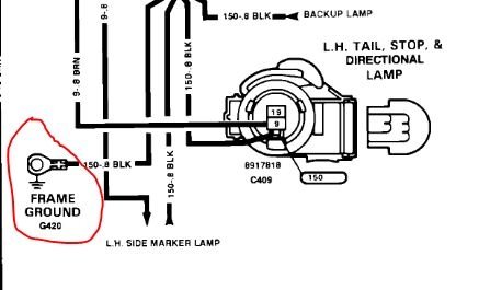

My driver side turn signals do not come on or flash all the time. Sometimes they work during the day, but never when I turn my headlights on. I've replaced the relay switch and the bulbs. My driver side brake light just stopped working as well.

Based on the model year, the first thing that comes to mind is a weak ground. The ground for the left brake light and signal are the same. Take a look at the picture I attached. It shows the wiring and ground (which I circled). The ground is on the frame of the vehicle. It will be bolted on. What I suggest is to first check the ground to make sure it is clean and tight, free of corrosion. Also, when the signal isn't working, move it around to see if it makes it work.
If you are confident that the ground is good, then check the light socket itself. Check for the same things, corrosion, pushed in pins, loose connections, damaged connectors and so on. Also, when the light isn't working (brake or signal) check the socket to see if there is power to it. Use a test light and connect it to a known good ground.

I have to be honest, I suspect it is related to a bad ground, but the only way to be sure is to check. The ground may be weak enough that when the lights are on, you lose the signal and brake lights.
