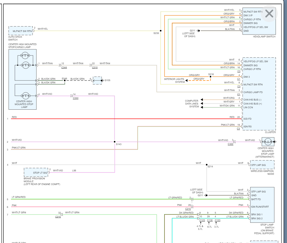

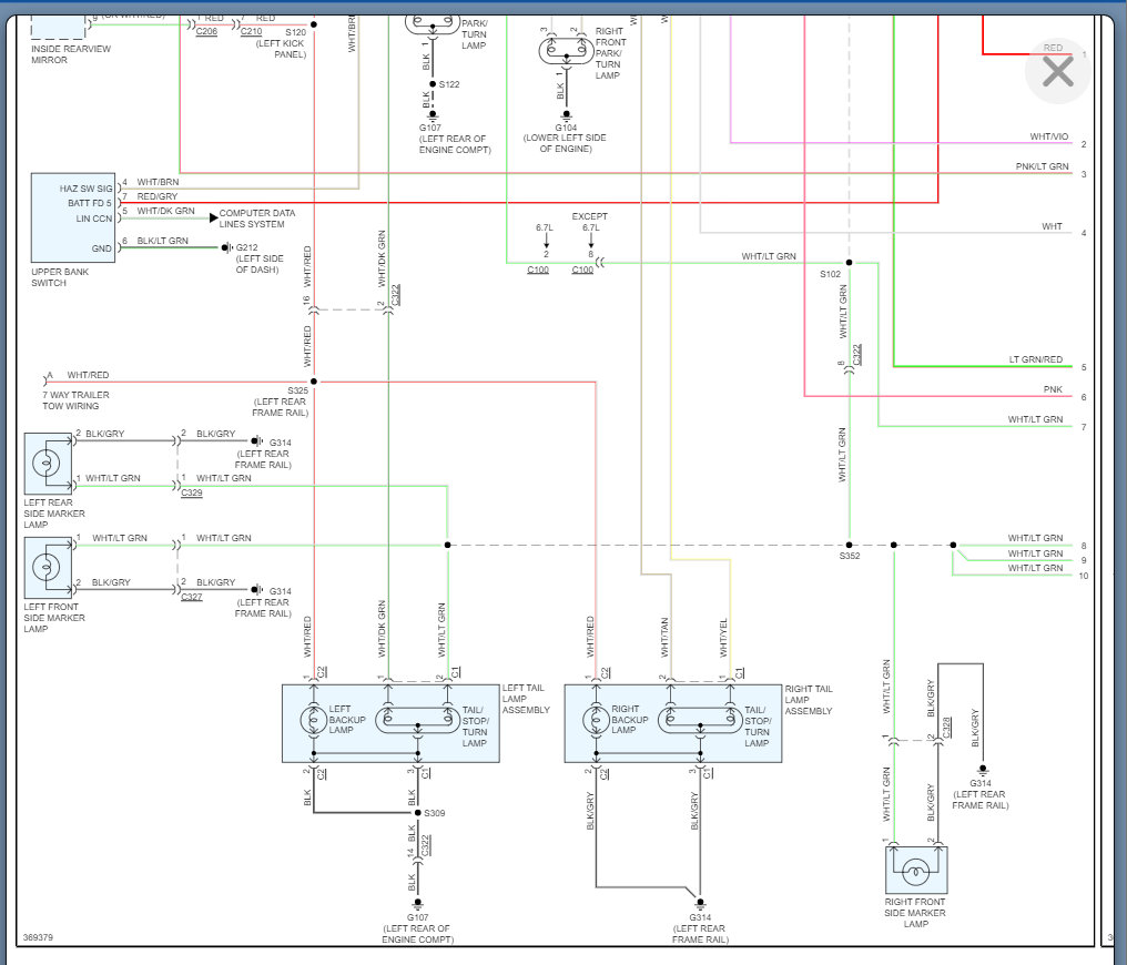

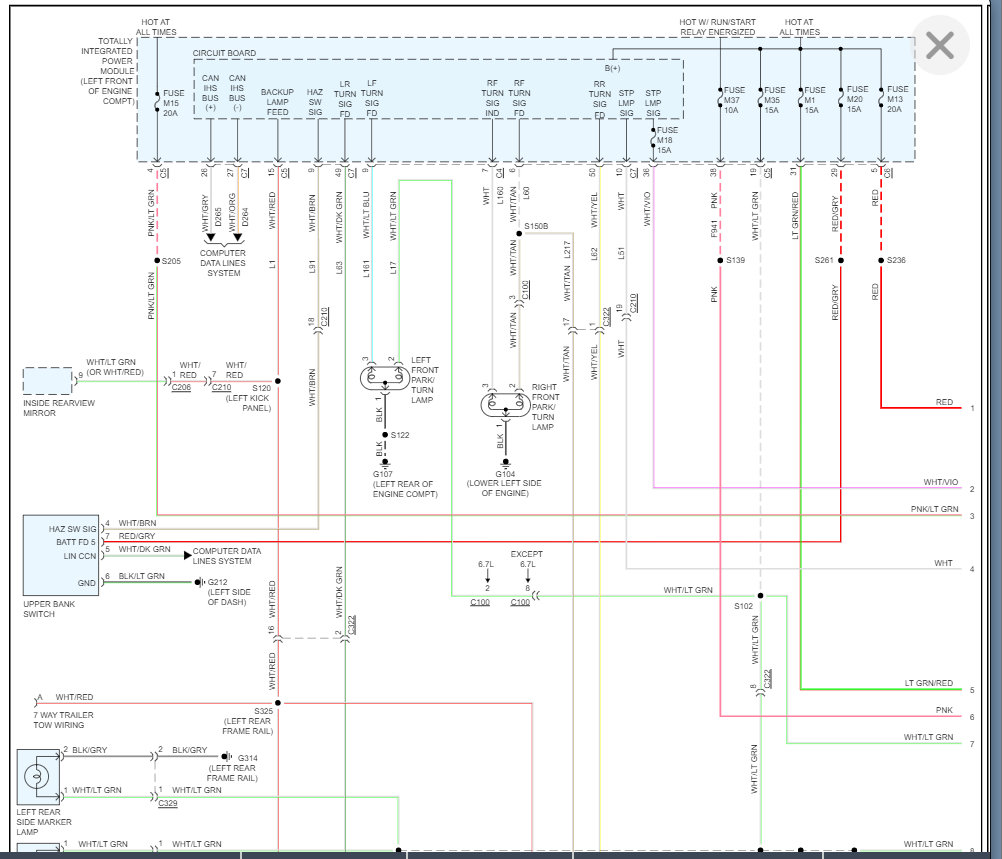

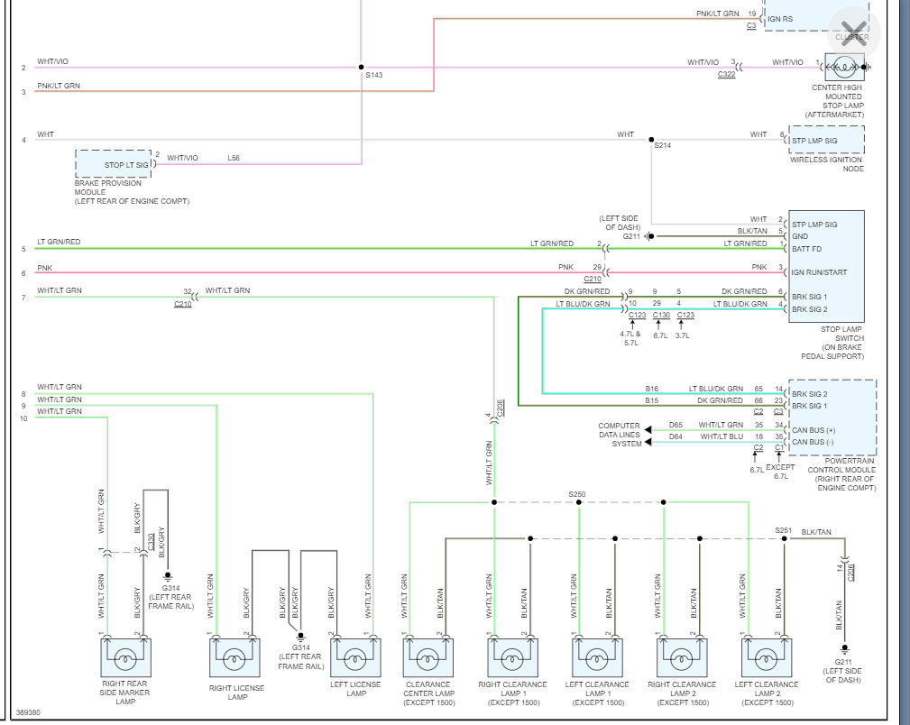

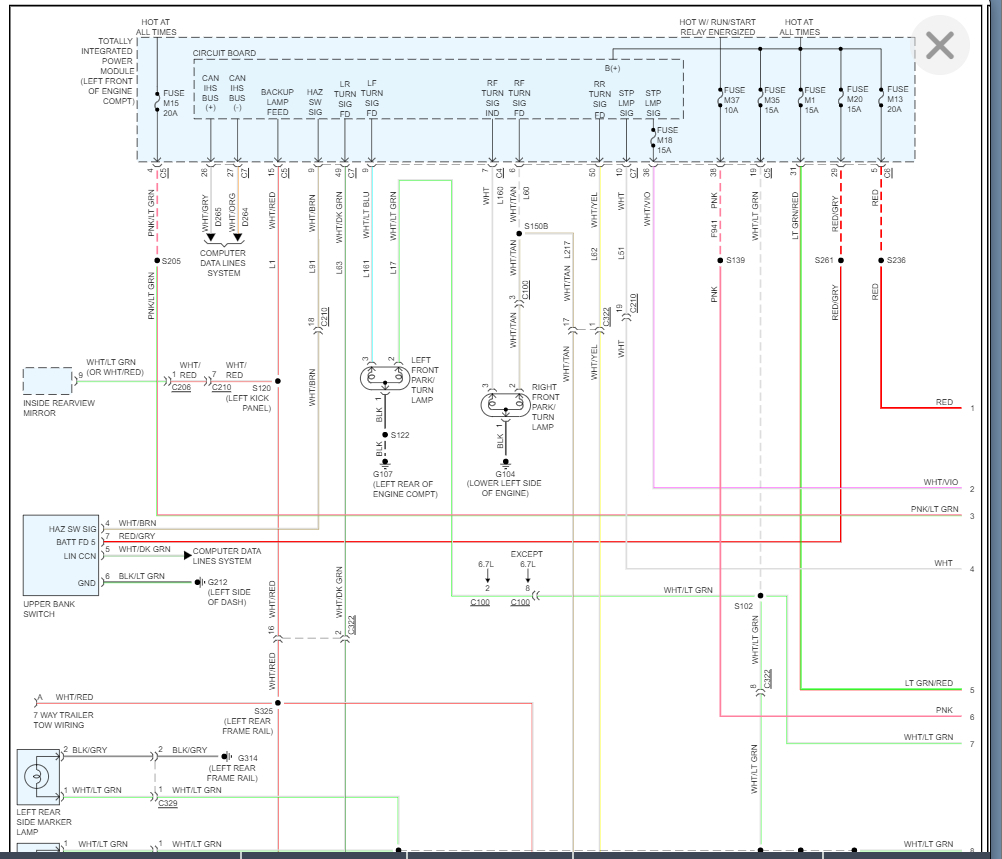

With the lights off the left turn front, mirror light and rear blink fast. When turn head lights on the front blinker stays lit and does not blink, the mirror blinks fast and the rear blinks fast but lit is a lot dimmer. Any ideas would help.
Apr 12, 2022 at 10:59 AM
There are a number of things that can cause this but if the bulb lights just don't flash or operate correctly then the likely cause is the TIPM.
Basically, this is the brains of the electrical system including the lighting, so we need to confirm this by checking the voltage coming out of the circuit board of the TIPM.
Below you will find the wiring diagrams that will help with doing this testing. Please run through this and let us know what questions you have.
