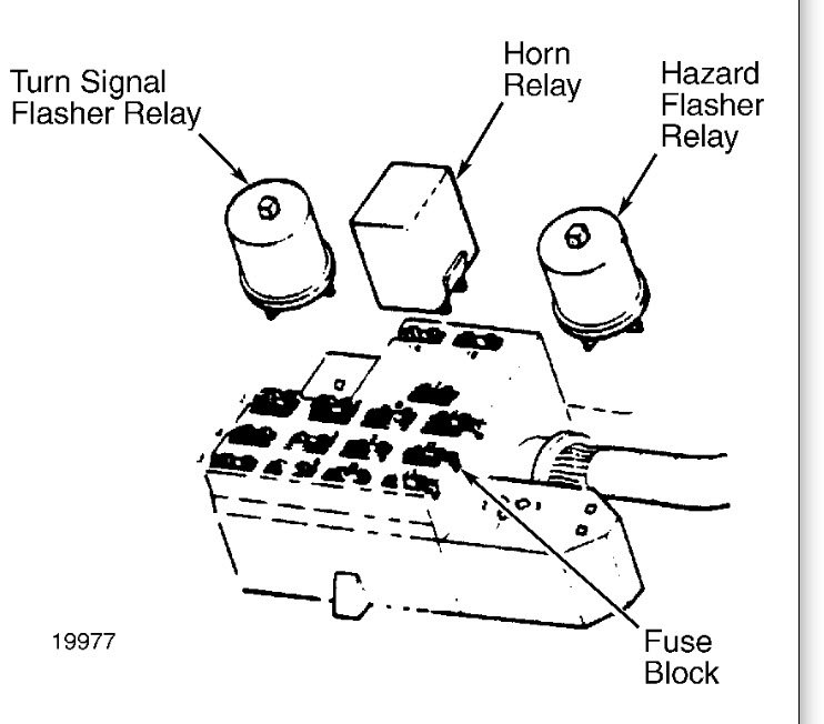

all my lights work except for my blinker lights. The relay is good on the fuse box and the insert for the relay is getting voltage. When I switch my lever for the blinkers the green arrows do not even light up. Anybody know what is up?

check turn signal flashers they will either be under dash, in fuse box or near steering column under dash.

I have checked them and they work.

see if hazards work if they do then check yellow and light/green wire coming from turn signal switch if you get power there it is a broken wire or ground wire problem. white is ground wire for lights in rear of truck probably on frame in back. picture shows location of flasher you may have changed wrong one.
