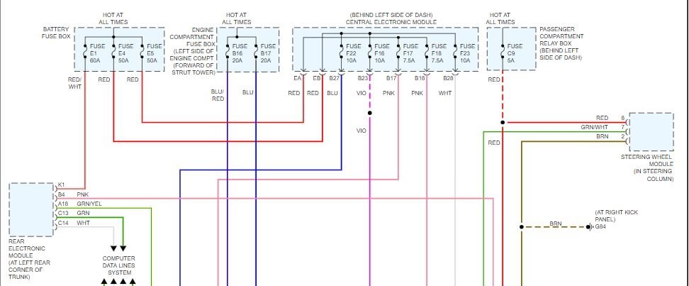

Driver side high or low beam headlight and fog light won't turn on.

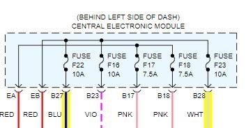

First, check fuse 22 under the dash on the left side. There are two separate fuses. One is for the left lighting and one for the right. See picture 1.

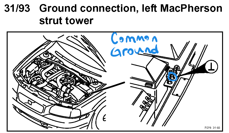

If the fuse is good, then I suggest checking the ground. There is one common ground for the left lights. See picture 2.

Thank you so much for the quick response. Yes, I checked the fuses already and they are are good. I didn't think that all the fuses would have blown since neither the high beam or low beam or the fog light works. Hopefully it's the ground like you suggested that sounds very logical and I will check that next and update you. Once again thanks for the input.

You are very welcome. I mentioned the fuse since there is a different fuse for each side. Let me know what you find. Also, if you can, check to see if there is power to the light sockets using a test light. With a test light, you provide a ground, so if there is power, then you know most likely the vehicle's ground is the problem.

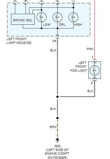

Just to help out a bit. The ground for both the light and fog lamp is located on the driver side fender. Attached image. Remove bolt and make sure it is clean and free of paint if it has been in an accident and was painted over. Hope image helps.

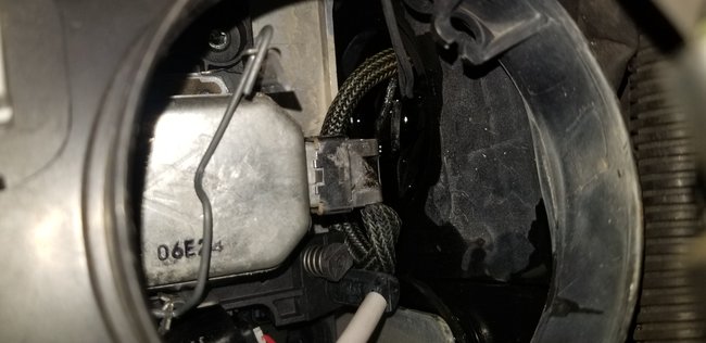

Thanks for the image of the ground location I appreciate it. just to give you an update I found a crack in the headlight lens and there was water inside the unit. This is my son's car and he has the xeon lights, and they are very expensive what it 1 through eBay cost me $300 when I received it it was broken I was wondering if it was possible for me to switch out the assembly unit for regular halogen lights would that work?

The vehicle came factory with H11 hid bulbs. I don't know if anything was modified. Mechanically, I can work my way through just about anything; however, an expert on different bulb requirements, I'm not. Normally, I never make any recommendations for the purchase of parts. However, from my own personal experience (owning an A8 with similar concerns), there is a website that you can get these bulbs from much cheaper. The site has nothing to do with 2carpros.com or me personally, so again, I am not trying to sell anything and this site isn't associated with them. I would recommend you check the site (hidnation.com) and see what they say. There is an toll free number to call (888) 559-5846. They offer lights at reduced costs and guarantee them. Also, they are extremely knowledgeable when it comes to the interchange of different bulb designs and what is needed.
Now, if the headlight assembly itself is cracked and allowing water to enter, that is a totally different issue.

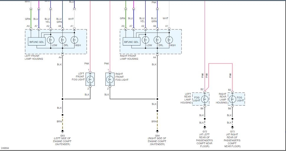

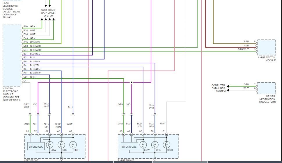

Lower voltage can be the result of a corroded connection, damaged wire, ballast, central electronic module connector, and so on. In this case, I would trace the wire back to see where the power loss occurs. As far as the .022 vs the .028, most likely that is added resistance from the jumper wire.
I attached a picture of the headlamp wiring schematic for you to review. I had to break it into three parts so you could read it. I did overlap the pics in order so you can follow them.
Let me know if it helps.

Thanks for your feedback I kind of figured I was getting resistance from the jumper wire because of voltage wasn't that much off. And I'm kind of leaning towards the c e m being the problem, could it be possible that one part of the cem is damaged allowing everything else connected to it to work except for that one headlight? The auto adjusting headlight mechanism works and the turn signal works. No high beam or low beam.
Apr 15, 2019 at 11:58 PM
  • 110,240 POSTS
Welcome back:
I would say it could be the problem, but I would check for power there and not at the light socket. It honestly could be a bad connection at the CEM. I would inspect the connector and make sure there isn't a problem there.
From past experience, I have found the pins in the connectors corrode and in some cases break. The result is not enough or no power where it needs to go. I don't recommend arbitrarily replacing the CEM without confirming an issue. Also, if you plan to inspect the CEM, I do recommend disconnecting the battery prior to disconnecting it. Also, don't reconnect the battery until the plug is reconnected to the CEM.
