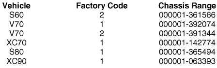

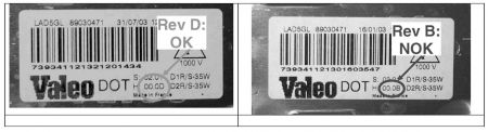

There was an old tech net note about a faulty ballast. Here you go. NO: 35-14 DATE: 3-8-2004 MODEL: S60 / V70 / XC70 / S80 / XC90 M. YEAR: MY 2003-2004 CHASSIS: See below SUBJECT: Bi-Xenon Headlamp Ballast REFERENCE: VADIS DESCRIPTION: Under certain conditions, ballasts in vehicles equipped with Bi-Xenon headlamps may not function. The ballast functions as the voltage regulator and generates alternate current. It transforms the vehicles current from 12V to 1,000V during start-up. Once the bulbs are lit, it then reduces the voltage to 100V. Its main tasks are to light the bulbs and to control the light during operation.
https://images.2carpros.com/forum/automotive_pictures/337695_113654313_1.gif
A new improved ballast has been introduced into production from the chassis break shown. SERVICE: When a vehicle with Bi-Xenon headlamp is not functioning properly and it is below the chassis break listed above
https://images.2carpros.com/forum/automotive_pictures/337695_113654314_1.jpg
First check the ballast in the vehicle to be sure that it is Rev D as shown in the photos. If it is not a Rev D ballast, replace it with the new spare part, P/N 30674786. So check the last six digits of your VIN and compare to the list above for the S-60 If you are withing that chassis break then this applies to you. You will need to remove the headlight assembly to access the ballast. The ballast is under the headlight assembly. To remove the hadlight you will need to remove the bumper skin. Once you have removed the headlight from the vehicle, check the ballast tag. If it says REV B then it is faulty and you will need to replace. If it says REV D then the updated one is already intall but does not mean it is still good? You can swap the ballast with the other side and see if it follows the problem. If it does then the ballast is faulty. Let me know what you find.
