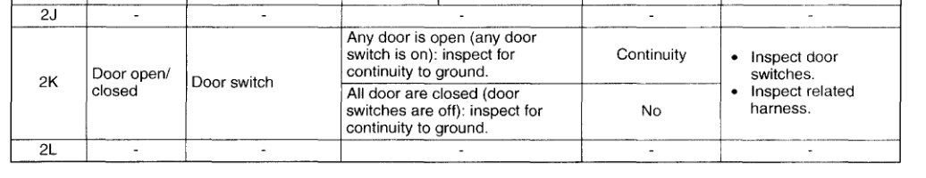

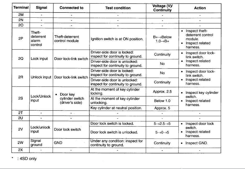

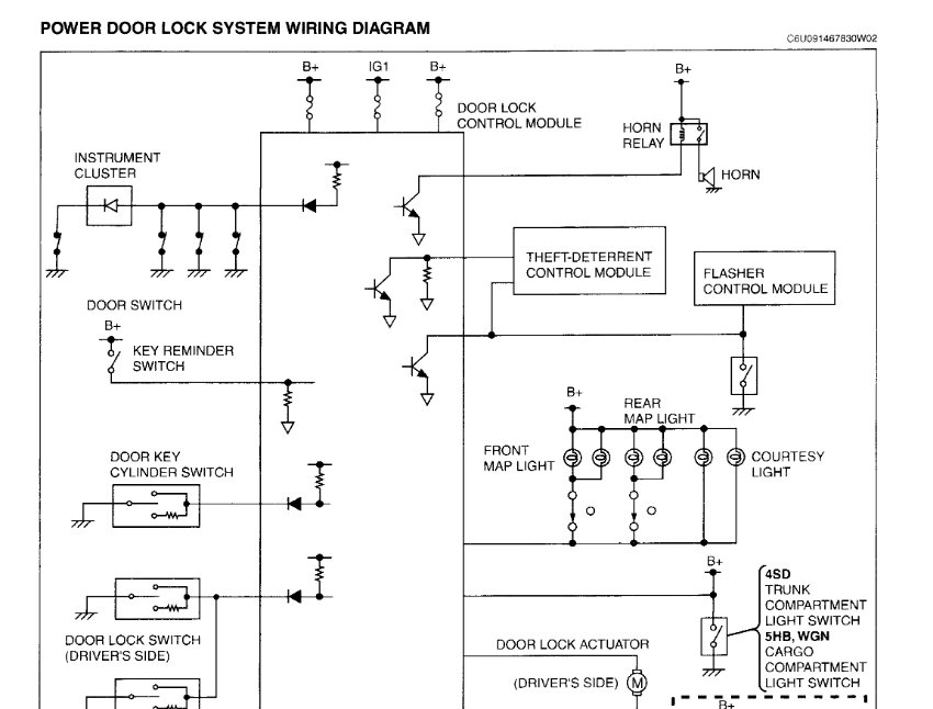

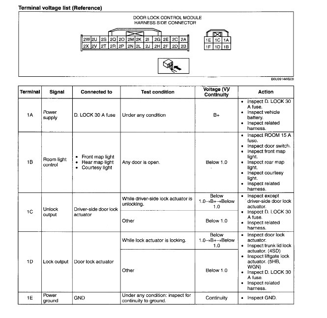

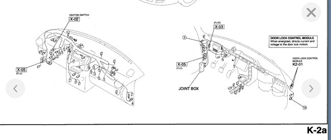

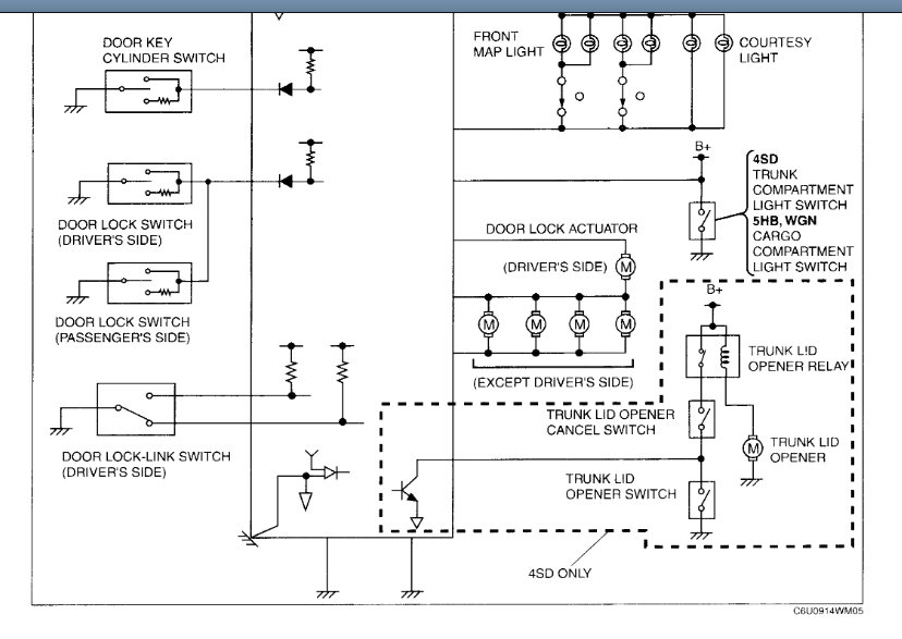

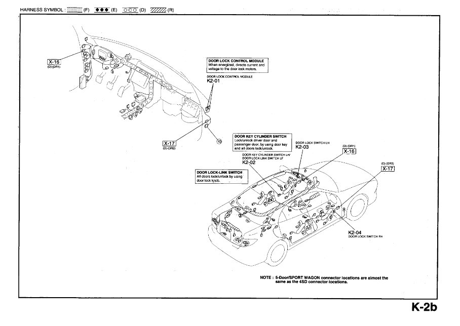

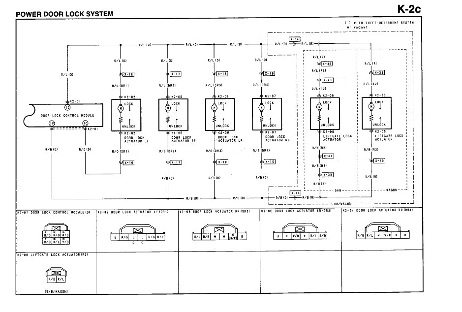

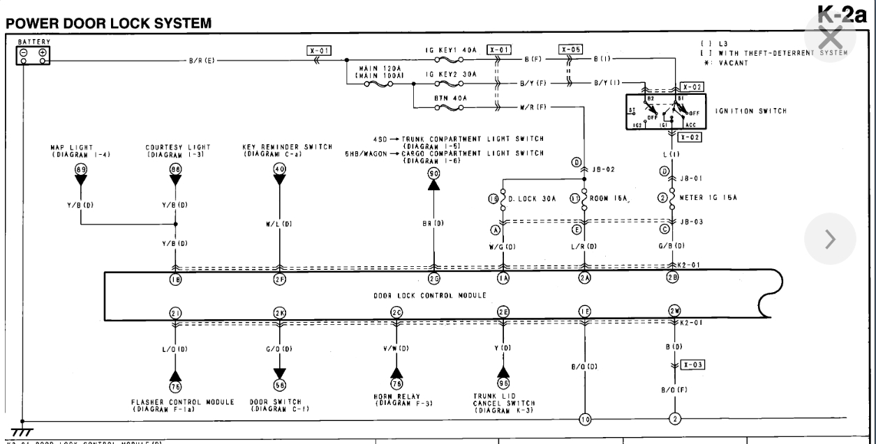

Hi, we are currently at a rest area in Alabama and my boyfriend went to unlock my car and the driver door will not unlock. Luckily the passenger door was unlocked for us to get in, but even from the inside the driver door will not budge. The lock switch acts like it is stuck and even pulling the handle and pushing the door it will not open at all. How would we go about fixing it? Please help.
Oct 9, 2019 at 6:34 PM
SCGRANTURISMO
  • 4,897 POSTS

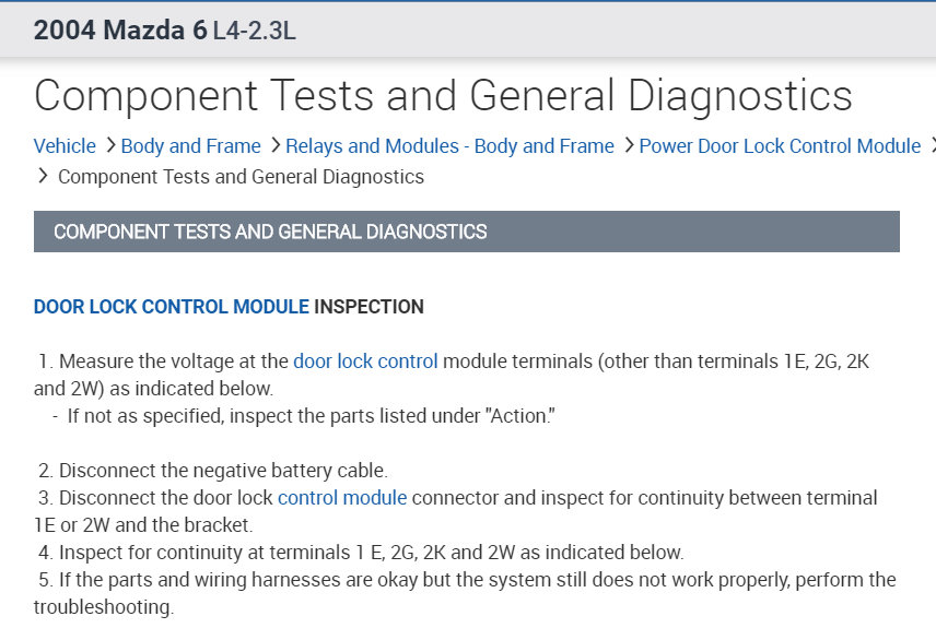

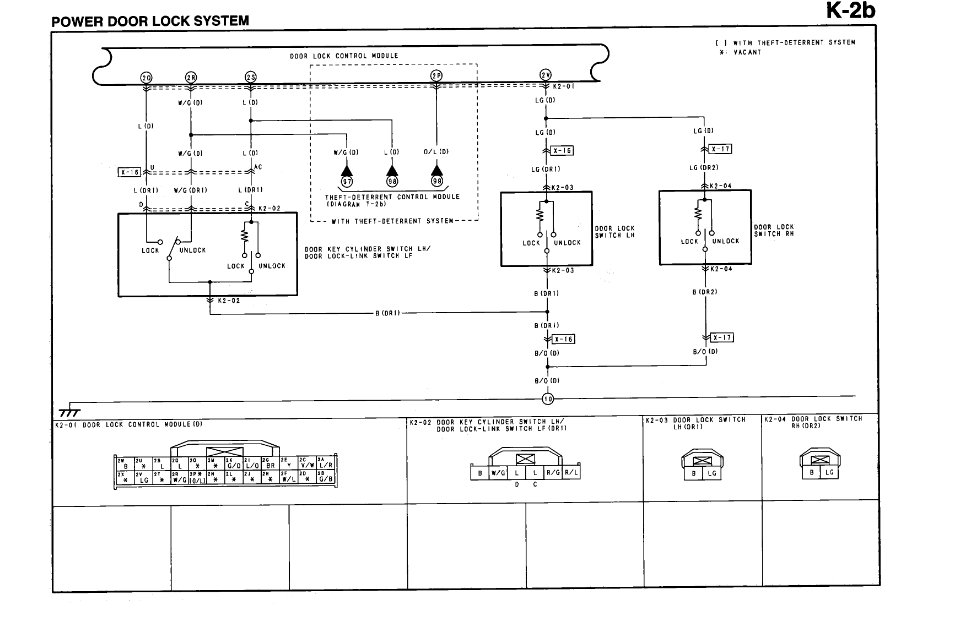

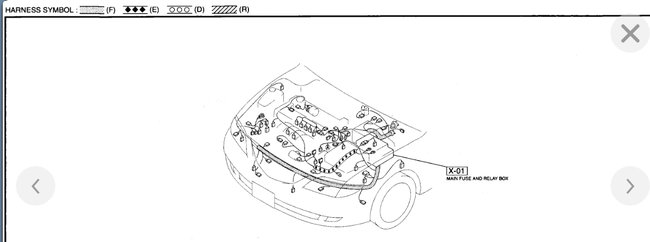

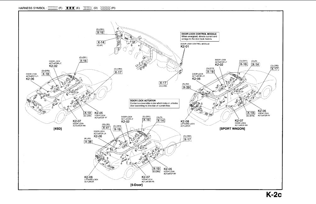

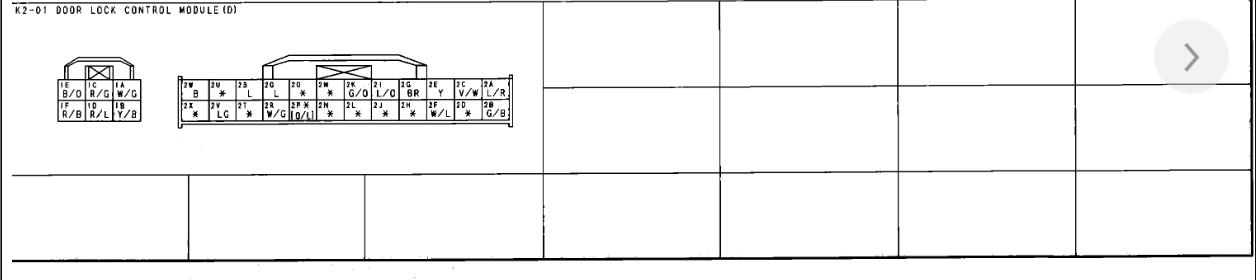

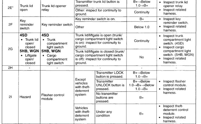

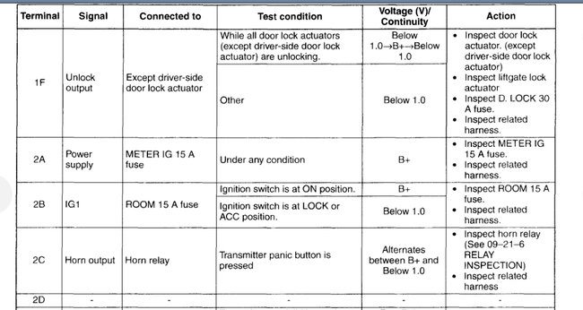

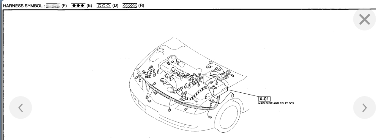

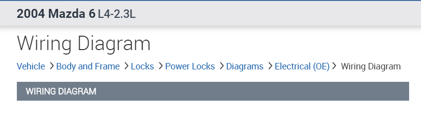

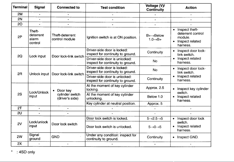

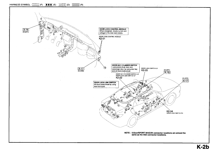

This could be a problem with your vehicle's Power Door Lock Module. In the diagrams down below I have included the schematics for your vehicle's power door locks, the wiring diagrams for the power door locks, and a troubleshooting guide for the power door lock module. Please go through these guides and get back to us with what you are able to find out. The troubleshooting guide will require you to use a Digital Multi-meter [DMM], so here is a link below explaining how to use one, if needed:
