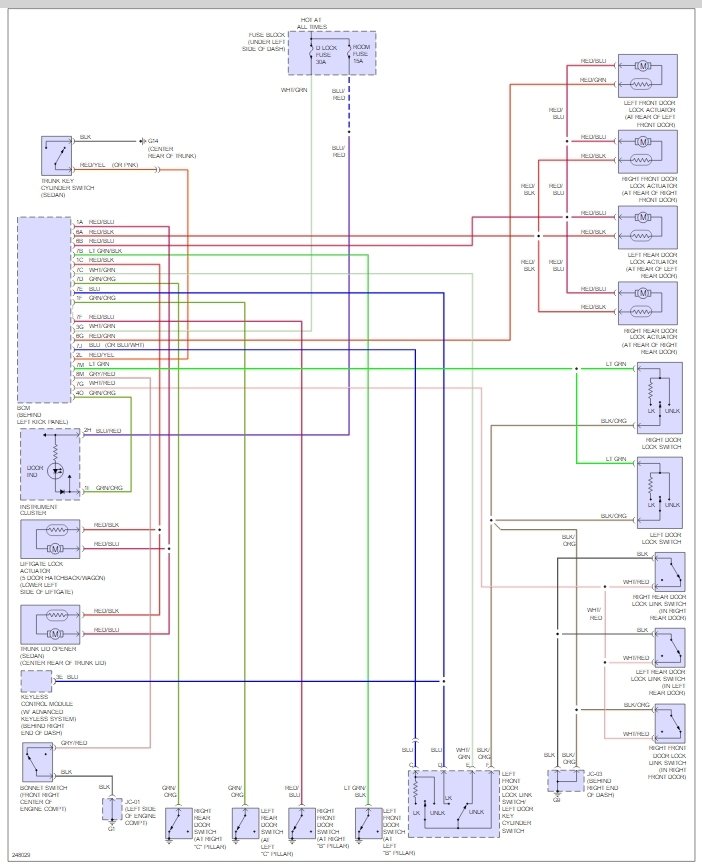

The door locks have stopped working as well as intermediate working of the parking and turn signals. What could be causing this?

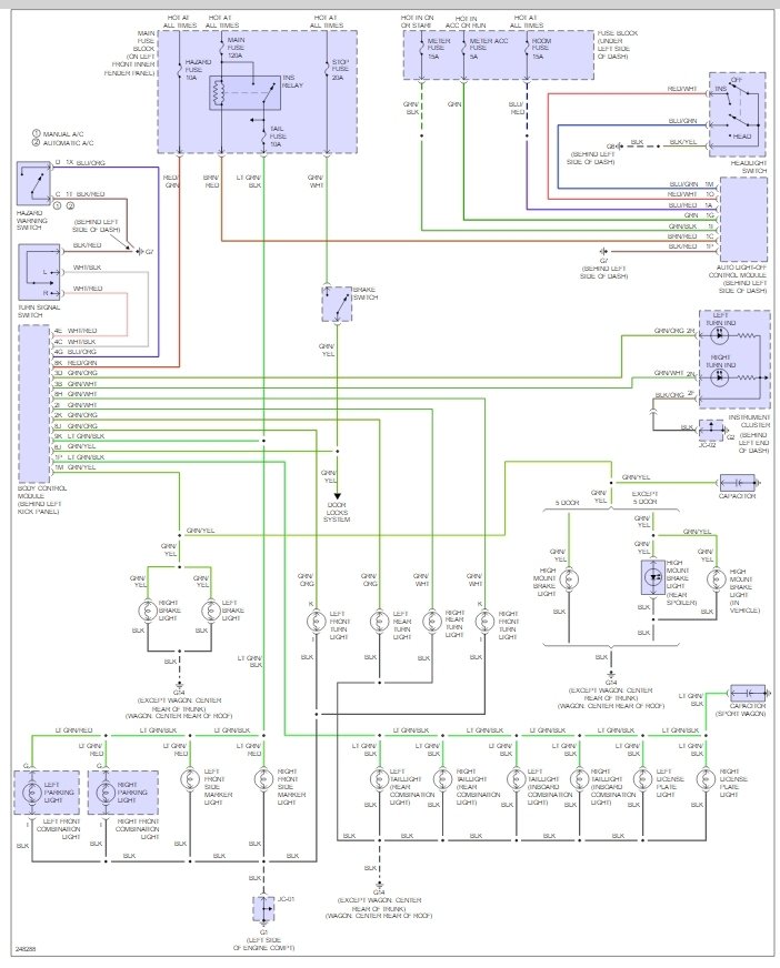

The problem is that the directional lights do not work as they should along with the parking lights.
Also, control locking of the locks on the doors stopped working and I assume that is the same problem.

I BELIEVE THAT MAY BE THE FLASHER , BUT NOT WHERE IS LOCATED TO LOOK FOR

It sounds like the multi function switch or the BCM has failed causing the parking lights and directional light not to work along with the door locks. Here is a couple wiring diagrams.
Let us know what you find
Best, Ken
