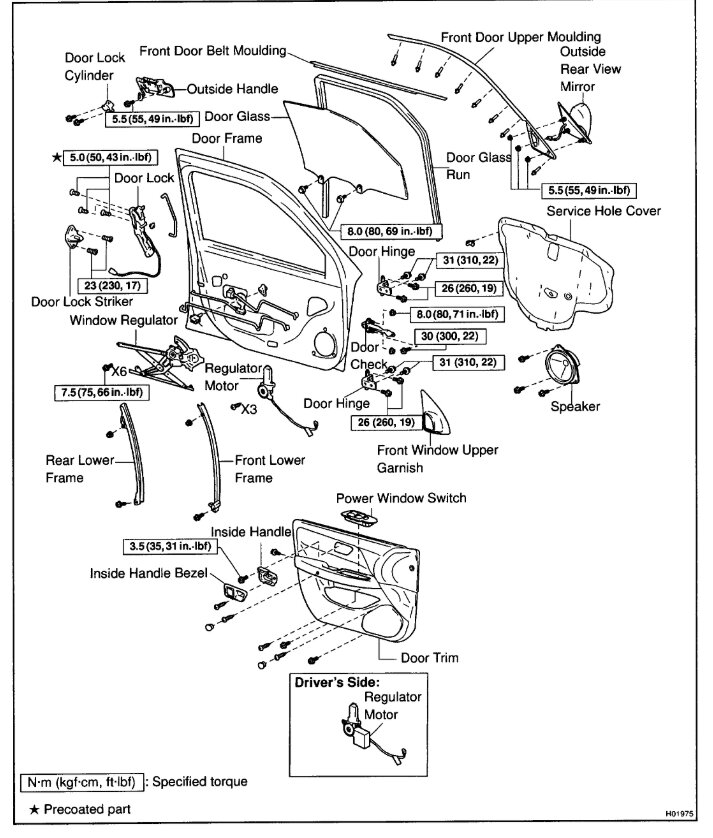

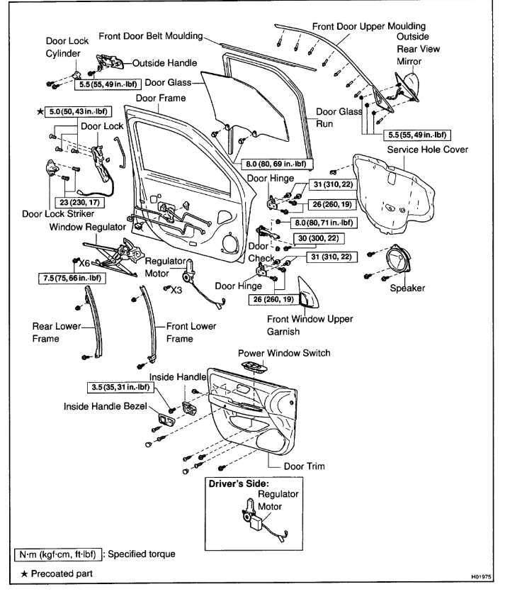

I'm removing my driver's door. Is there one big plug or individual connectors to the harness? My car was built in Japan does the car door I'm getting need to come from a car VIN # starting with J.

Once you have the wiring boot off of the door jamb there will be one plug to disconnect so you can remove the door. Here is a diagram for you which should help. You might need to remove the kick panel to get at the plug. Check out the images (below). Please upload pictures or videos in your response of any problems so we can see what to help you with.
