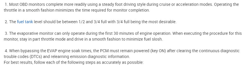

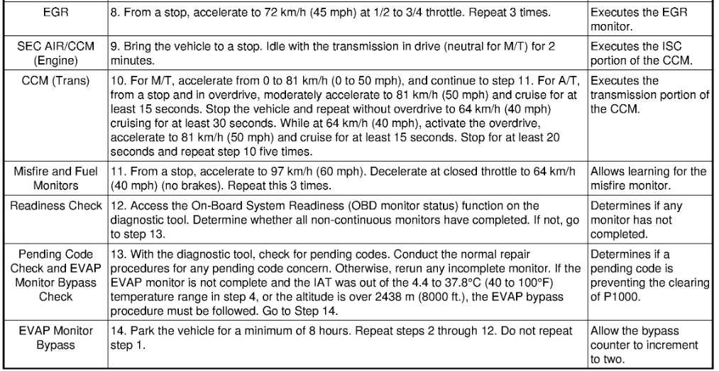

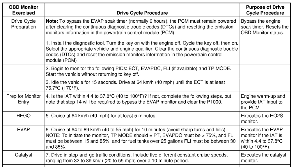

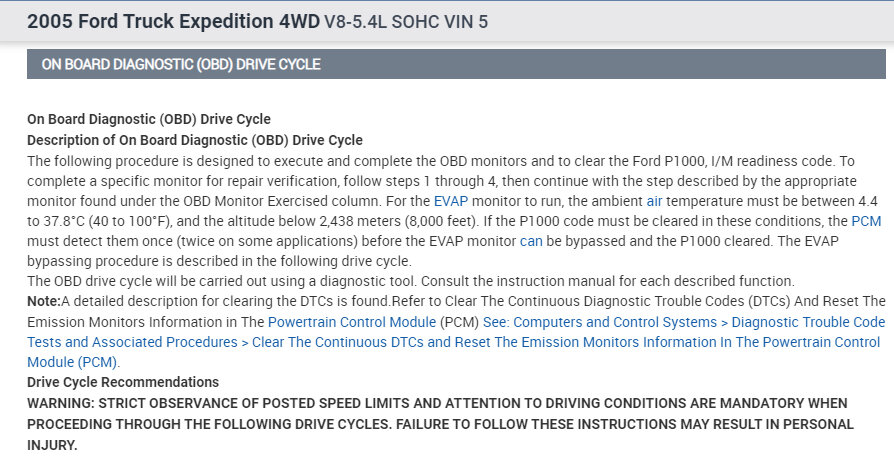

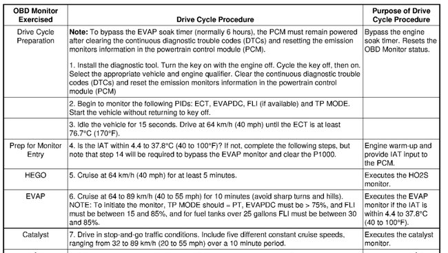

The drive cycle will vary, but half to three-quarters of a tank of fuel is listed. I attached the drive cycle information from my manual below. Take a look through it and let me know if it helps answer your question.

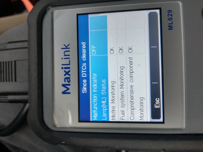

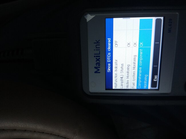

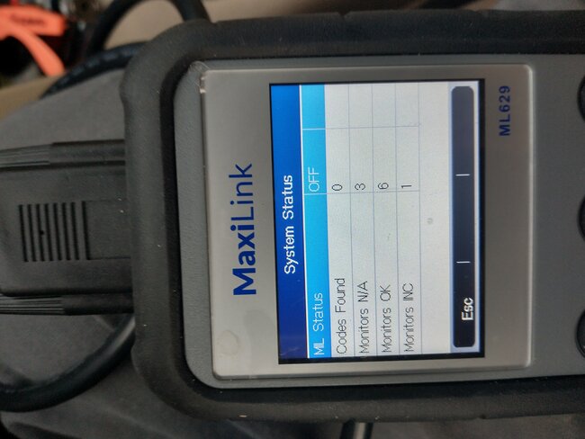

I completed all of the monitors tests
Except for the cat monitoring.
I am looking at the "Since DTCs Cleared"
And not the "This Driving Cycle"?

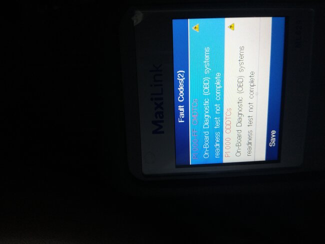

Look these pics and see what you think.
I see under step # 7 in drive cycle docs you provided, how to complete catalyst monitor.
I still have the P1000-FF CMDTCs
showing readiness not completed. See pic.
Do I clear these after I complete cat monitor test?
Thank you,!

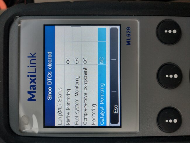

Pic with cat monitor showing INC

And I just drove the car and followed the drive cycle directions, and the cat monitor is still showing as INC. I guess I will just keep driving?
Mar 17, 2023 at 9:24 AM
  • 110,244 POSTS
The catalyst is always the last one. Keep driving. Hopefully, it won't take much longer.
Let me know when it completes and is IM ready.

I drove more miles and the cat monitor was finally completed.
I still have no CEL.
So, I parked my car and scheduled an inspection.
