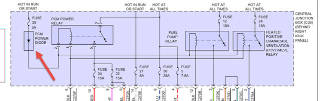

where is the PCM power diode located?
Feb 4, 2017 at 10:05 AM
HMAC300
  • 48,601 POSTS
it is in central junction box, but may be part of it and not serviceable. See picture.

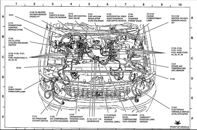

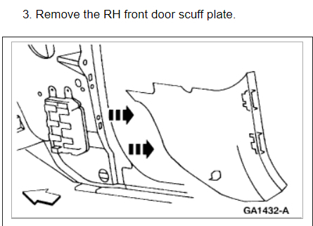

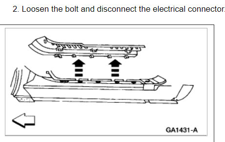

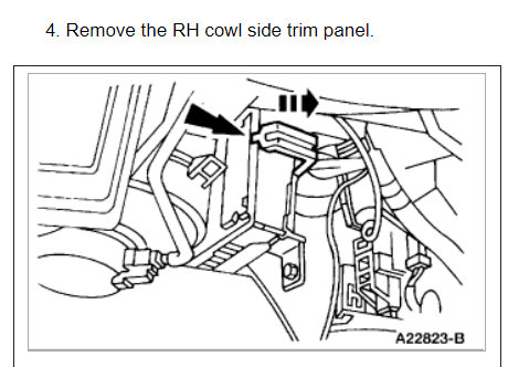

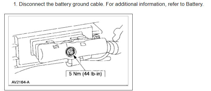

The PCM is located under the dash on the passengers side by the blower motor, here are diagrams to show how to replace the PCM
Cheers
