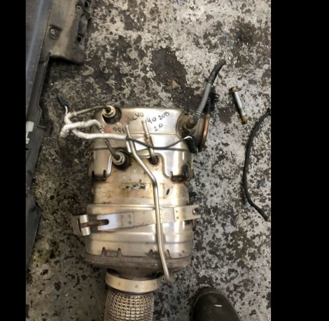

A few weeks ago a notification popped up saying, "soot particle filter full - see manual". After researching online and reading the manual, I assumed it would regenerate and clean itself- as it's meant to. After a few weeks of it continuously coming up, I took it to a mechanic who put 2 spray cans of german filter cleaner into the filter to try and clean it. This cost $300.00 and delivered no results. Since the notification has come up the car has been sluggish and unresponsive to acceleration. What do you think this means and what do you recommend I do?

Good morning,
The filter is clogged with soot. The filter will need to be removed and baked to vaporize the soot.
I have never seen that spray work for cleaning out the soot. It must be removed as I stated and either baked or replaced.
Once that is done, the performance will return.
