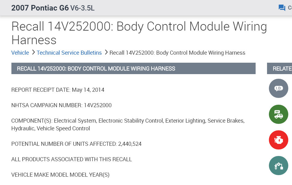

The door locks on my car listed above (base model) have started going nuts. It's constantly clicking, locking and unlocking, sometimes it just makes the sound. Almost as if someone is sitting in the car constantly pushing the button.
What's causing this? I don't know whether to replace the BCM or the Door Lock Actuator.
I've had so many problems lately that honestly I don't need or want another $200.00 plus repair.

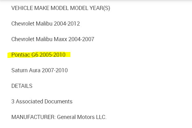

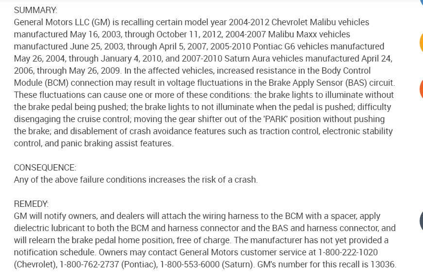

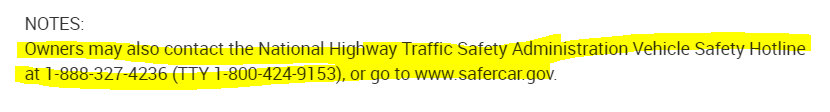

I have included information in the form a Technical Service Bulletin (TSB) for your vehicle of a recall for the Body Control Module (BCM) wiring harness. Please contact your local dealership's service department about this recall, and keep us informed as to how everything turns out.

Actually, I have my original notification about this recall, GM Recall #13036. My notice is dated July 2014 and I show it completed by Skinner's Chevrolet, Buick, GMC Terry, MS in September 2014.
As a matter of fact, I received a second Recall notice 3-4 weeks later concerning a potential problem which was transmission shift cable was at risk for fracturing.
Both recall notice issues were completed on the same day by the same preferred dealer specified above.
I haven't had any other recall notifications about either previous issues or any new issues.
So what should I do now?
