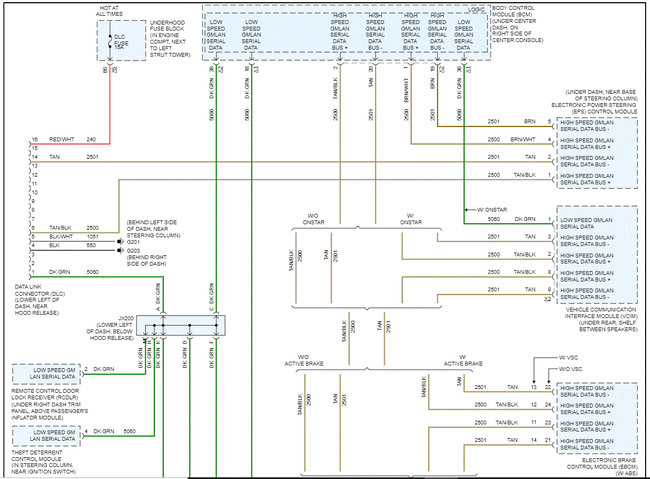

My car has had this problem for a while. Sometimes while I am driving the doors will randomly lock/unlock by themselves. When this happens the check engine light flashes on and then back off and the speed gauge jumps up 20 or so MPH and then goes back down to the speed at which I am driving. Only seems to happen while I am driving, and acceleration can feel a little sluggish after it happens.
Known bad door lock switch on driver's side.
I believe both front and back door lock actuators on the passenger side are bad.
Any Ideas?
My ideas are:
Could it be the door lock switch? Actuators?
Could it be that the BCM for some reason thinks I am shifting into/out of park which automatically locks/unlocks the doors.

The idea that you notice the check engine light flashing when this happens puts several different thoughts in mind. First, when the light flashes, under normal conditions that indicate an engine cylinder misfire. The speedometer jumping doesn't seem directly related to the locks either. Do you ever notice the interior lights flashing on and off when this happens?
There is a ground located under the driver's seat (black wire/G301). It may be a good idea to check that to make sure it's in good condition. That grounds the door jamb switches. If they fail and the BCM thinks a door is open, it will cause havoc.
At this point, they don't see related other than happening at the same time unless there is a ground-related issue that ties them together. What I would start with. The vehicle has a can-bus system that is used for BCM to communicate with other modules. (CAN = controller area network). Before we start replacing things, I recommend having the network (CAN) scanned. Basically, all modules are tied together via a few wires. If there are diagnostic trouble codes, this will retrieve them regardless of the module storing them. Because the check engine light has been on, there must be codes.

Check the ground first. Hopefully, it will be something simple. As far as scanning, it does require a scanner that can read can-bus codes. Here is a link that shows in general how it's done. Additionally, there is a video showing it being done.
https://youtu.be/InIlnsjOVFA
As far as the can-bus, the newer the vehicles get, the more involved they are. There are more and more modules/computers on cars. If the manufacturer had to run separate wires to each, the car would weigh about 1000 pounds more, hurt MPG, and be much more expensive.
It is confusing, but really interesting how it works. The powertrain control module makes determinations for the car. If two signals come over the same wire at the same time, the PCM determines which is more important. LOL Things just keep getting more and more involved.

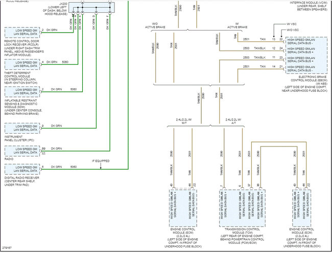

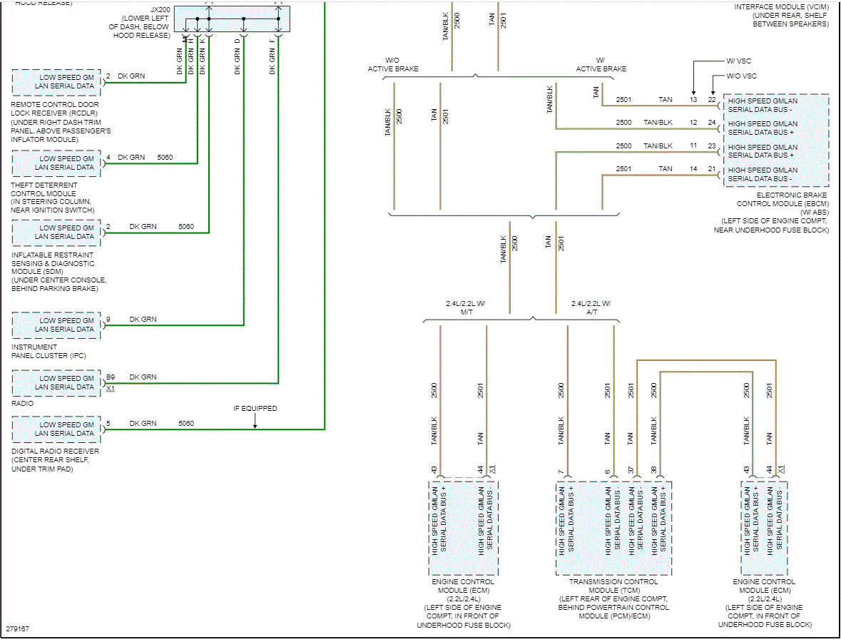

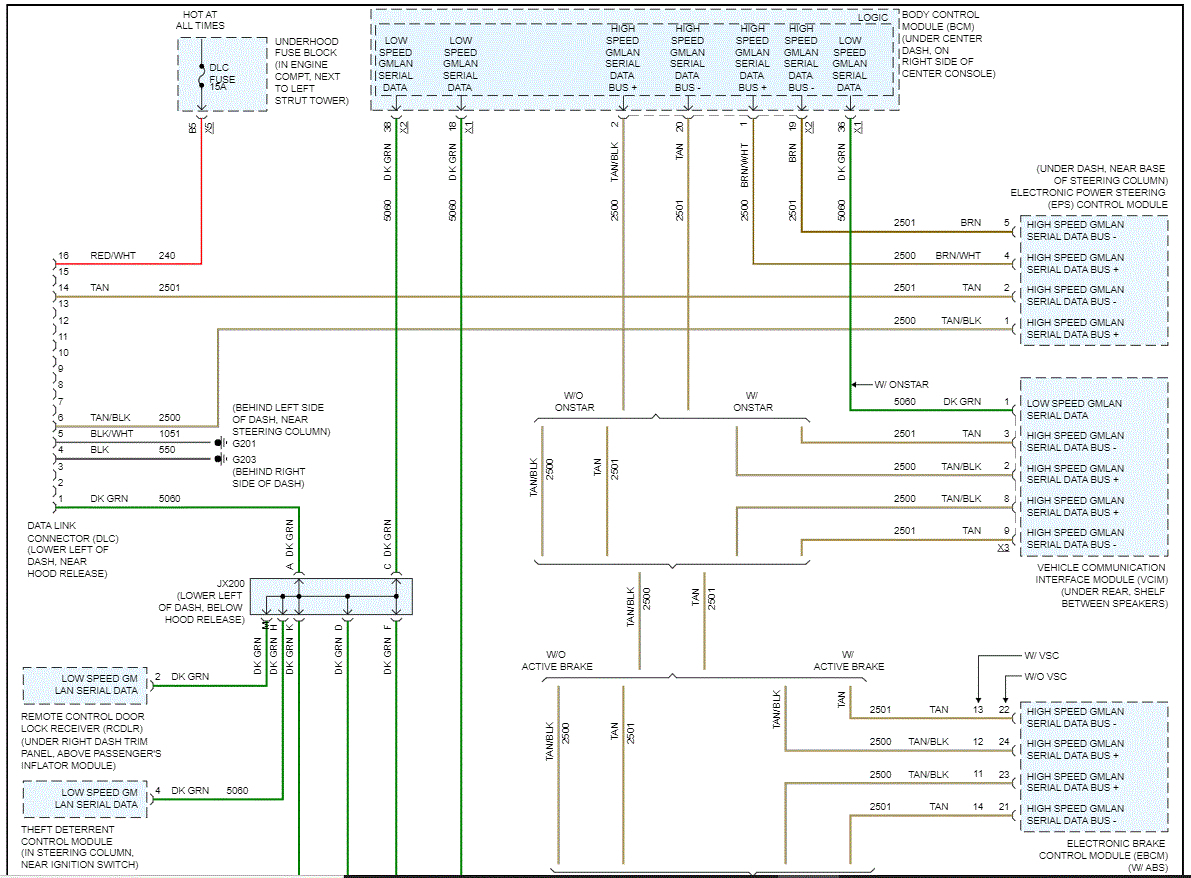

Just to let you see it, I attached the schematic below for the computer data lines. Notice there are both high speed and low speed. Notice that all are basically the same colors via high speed. The low speed are all the same colors. That's because that is the single wire running from module to module. Ugh!!! LOL Also, the low speed will always be a single wire circuit that runs basically from a 0v to 5v signal to communicate between circuits that don't require an instant response. A high speed will usually be two wires (often twisted together).
The term bus simply means this. Picture a school bus. Many students ride on the bus to their destination. The concept with the can-bus is a single circuit (similar to one school bus) carries multiple module/computer transmissions to their destinations.
