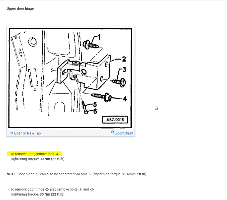

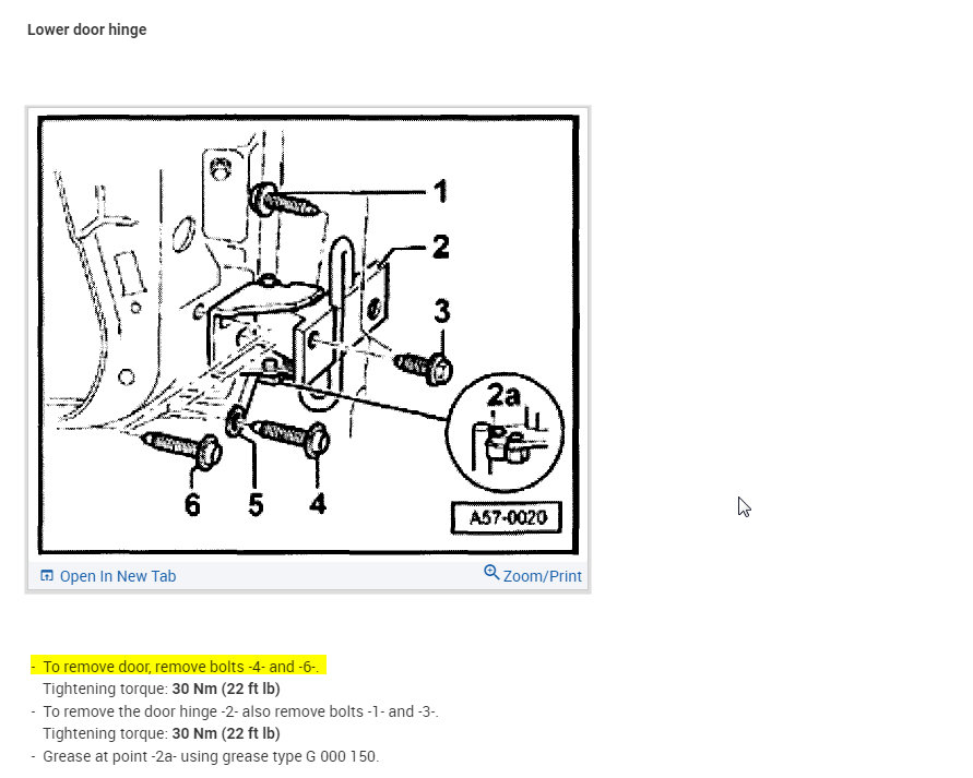

Need to know how to take off my rear left door on my Audi A4 estate 2002 plate.
Thanks
PS. not the door panel. The whole door. Fed up of seeing door panel everywhere just want to know how to remove the door.
Simple question. Simple answer. Thanks
Sep 27, 2019 at 2:30 AM
You just need to remove the door hinges but just the bolts that I highlighted. Let me know if you need more information. Thanks
Sep 27, 2019 at 9:21 AM
