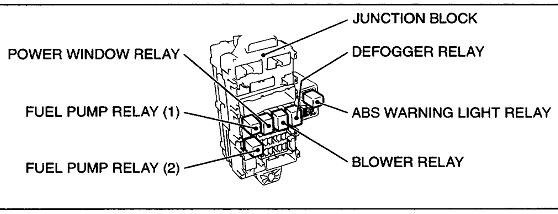

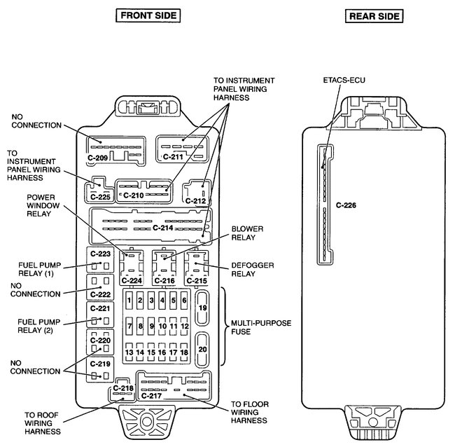

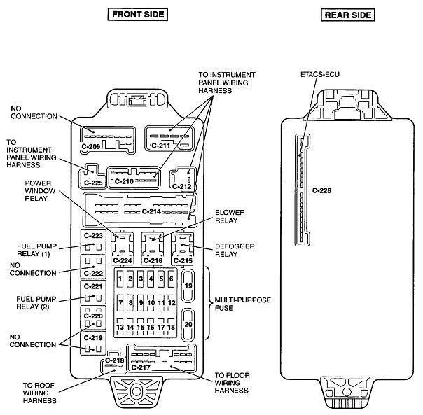

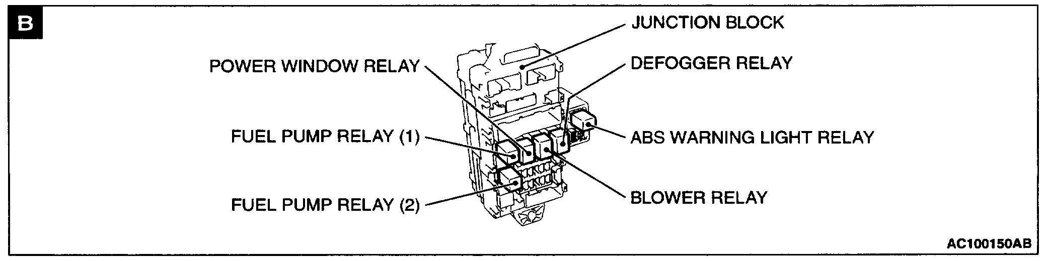

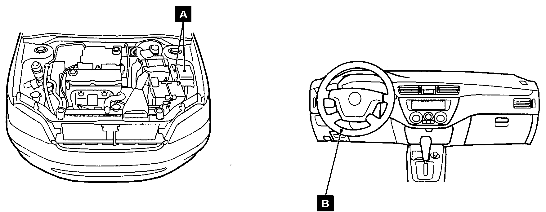

where is the fuel pump relays location? How many fuel pump relays are they for this car one or two?
Apr 21, 2018 at 9:24 AM

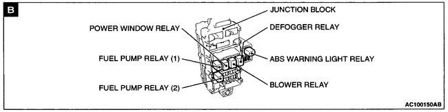

Good evening. The relay is in the under dash fuse panel, drivers side. Check out the diagrams (Below). Please let us know if you need anything else to get the problem fixed.

I have purchased a new fuel pump and it is still got no power to it. My partner looked under the bonnet and under the steering wheel and cannot find a relay. I have no idea what to do, any suggestions would be appreciated.

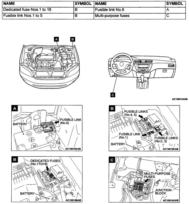

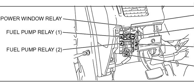

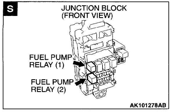

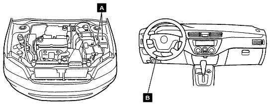

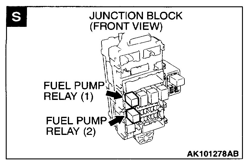

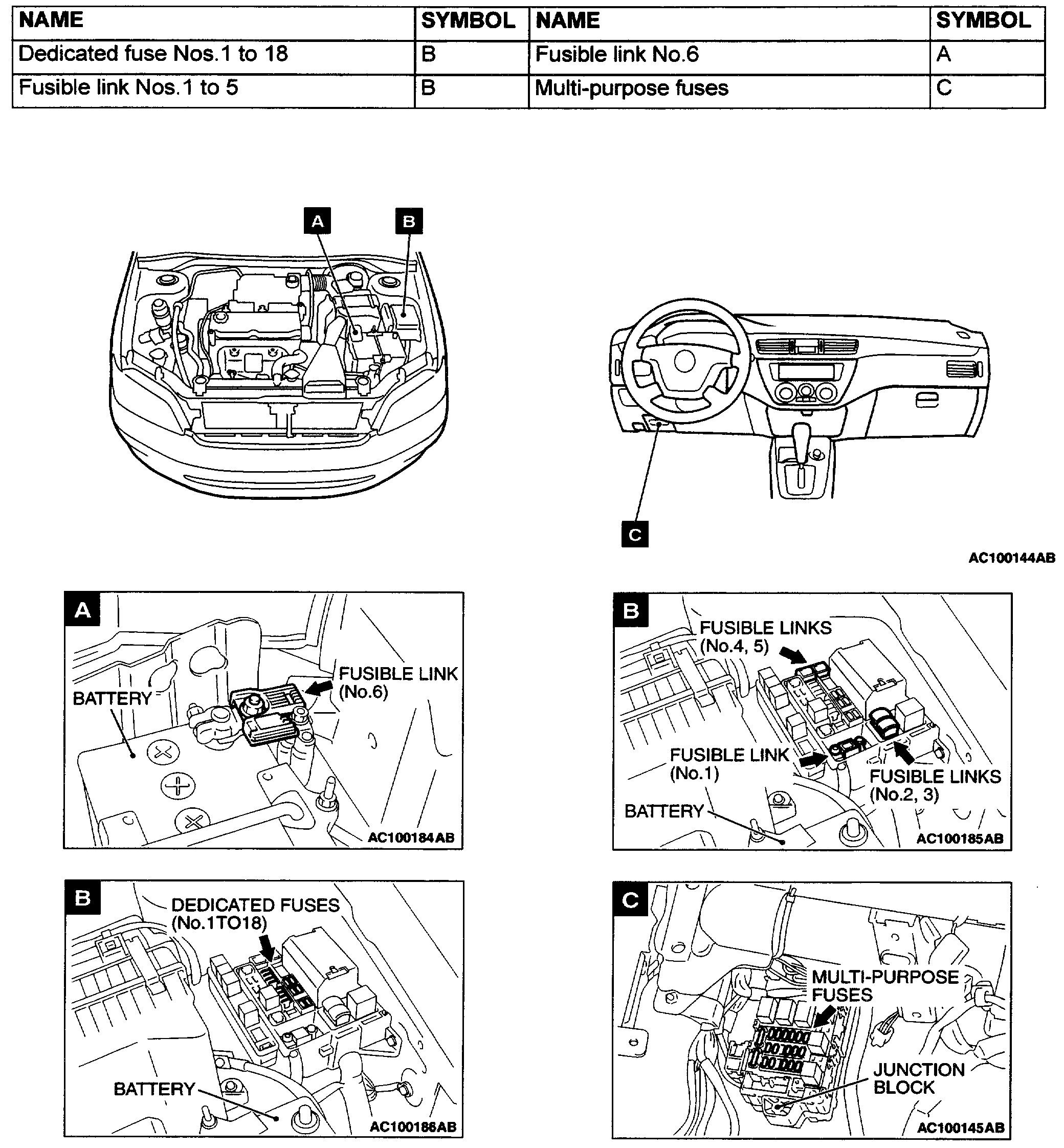

The relay/fuse box is under the dash on the left side of the vehicle. There are two fuel pump relays. I attached a few pictures to help you locate them.
Under the hood, check fuse 8 in the fuse box. See last picture.
Let me know if this helps.

If you have no spark, this conversation will need to go in a different direction. If you never hear the hum of the fuel pump, either during cranking or for that first one second after turning on the ignition switch, look first for fuse number 10, a 15-amp, in the under-hood fuse box, then fuse number 8, a 7.5-amp fuse in the inside fuse box on the left end of the dash. That inside fuse box is also where you'll find two fuel pump relays. Both must turn on for the pump to run. Relay number 1 turns on when the ignition switch is turned on. Relay number 2 is turned on by the Engine Computer for that first one second, then again during engine rotation, (cranking or running).

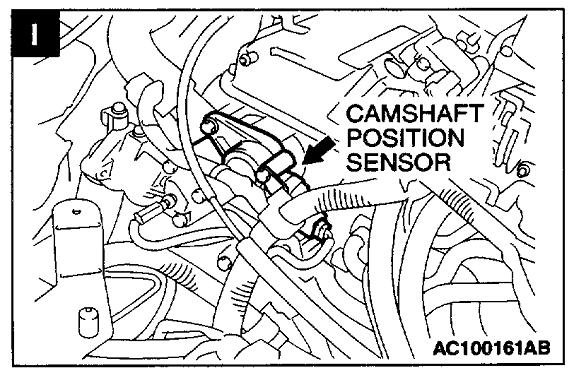

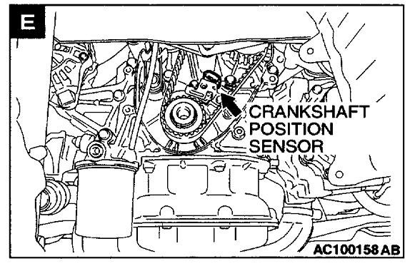

If you get 12 volts to the fuel pump for one second, but not again during cranking, the common suspects become the crankshaft position sensor and the camshaft position sensor. It is their signals that tell the Engine Computer when the engine is rotating and it is time to turn on that second fuel pump relay. With the signal missing from one of those sensors, you will not have spark either because the computer does not know when to fire the ignition coils.
Before you randomly replace a sensor, read and record any diagnostic fault codes. Normally when a part is referenced in a fault code, it is actually the cause of that code only about half of the time. First we have to rule out wiring and connector terminal problems. In the case of these sensors, they do have a fairly high failure rate, but be aware it can be difficult for a fault code related to them to set, so just because there is no fault code, that does not prove the sensors are good.
