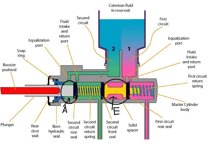

If I open the wheel cylinder nipples and let the old brake fluid, flow out of the system(into a bottle) by gravity,
will ALL the brake fluid in the system flow out?
At the image of the dual master cylinder that I attached, it looks like that the brake fluid in the circle parts, which I marked as A and E, will not flow out.
Will the brake fluid in those parts(A and E)really stayed in the master cylinder or will they, also, flow out of the system?

There is no picture here but I can tell you that any one wheel will not drain the master totally. The master separates 2 wheel brake systems and holds 2 reserve reservoirs so if one runs out of fluid, the other will still work. Some separate front and rear, others separate them diagonally.

Here is the image.
And i meant that i open all the wheel cylinder nipples,not just one.
I hope,that addition information will help you answer my question.

A and E are pistons and solid material. There shouldn't be any fluid there.

If you look carefully at the picture you will see that these parts contain fluid(around the solid material).
Look at the equalization ports,imagine the process,and you will see.
It looks like the rubber seal wont let the fluid get out but maybe it will flow through the equalization ports and down to the pipes?
