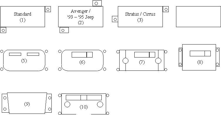

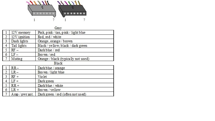

The next thing to cause confusion is 1999 through 2003 is where there was a lot of change-over between face plates and plugs. If you look at my nifty drawing, style number one was used from the mid '70s through 1998 on most models, and until 2003 on full-size vans. Styles two and three are shown with their special mounting ears and applications. All of these used two seven-pin plugs, one gray and one black. The '70s through mid '80s models used different plugs, but by the late '80s if you have any "square-face" model, it uses those two plugs. The wire colors could vary a little, but for the most part, they were standardized over all those years and car models. Notice terminal 7 in the black plug gets 12 volts switched onto it when the ignition switch and the radio are turned on. That is the wire that tells a power antenna to go up, and / or an amp to turn on. That wire was often missing on the base model cars up to the mid '90s. If you upgrade to an Infinity system, you could find a plug in a salvage yard, pop the terminal out and stick it in your black plug. In later years that wire was already there, even when it wasn't used.
Some of these Mitsubishi and Alpine-built radios also have a two-pin white plug with just one terminal inside it. As I recall, that was for cars with steering wheel controls. Nothing has to be plugged into that, and if your car has that plug hanging there, it doesn't have to be plugged in to anything.
1999 was the first year they switched to the "round-face" face plate design. That was style number 5, but it still used the same two plugs. Those were found in the Neons. Every year a few more car models switched to that face plate, but by 2004, all had switched to style number 6. They look the same and have the same four mounting holes. Only the plug design changed to a single white plug with two rows of terminals. This plug also has two ground wires in it. The old gray and black plugs didn't have a ground wire in them. That led to lots of blown tail light or dash light fuses when people mistakenly found those with an ohm meter and thought they were ground wires. Those older radios were grounded with a bolted-on braided strap or a plugged-in ground wire.
