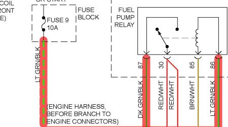

Ck fuses, relay, replaced fuel pump, no power at pump. It was running fine, the next day it wouldnt run I pulled the fuel supply at rail, spun engine no fuel, have spark

Check fuse no. 9 10amp if okay test the fuel pump relay -Your power start at this fuse goes thru the relay and straight to fuel pump.
https://www.2carpros.com/forum/automotive_pictures/12900_fp_relay_5.jpg
