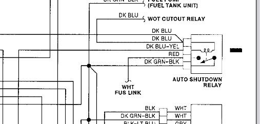

I had my truck in the shop and I pulled the transmission because I had clutch problems. Put the transmission back in and found that my cps (crank position sensor) had been pinched in the bell housing. Pulled tranny again and got it out. Cut the wires and replaced them one at a time. Put back in the truck and ran. Then a day later it runs barely and stalls and dies when it want. CPS wire had fell out because the wires broke. Put it back together taped it and made sure it was tight now I have crank and no start? Could doing the wiring trip the add relay and cause it to not start. I'm not sure if I can hear the fuel pump when turned "on" but I have fuel to the fuel rail. The valve will shoot fuel to the top of the hood when it's open? So is my problem still the CPS or something else? By the way I replaced the ignition coil brand new Cps after I pinched it. Help please? What can this be? Oh and when it finally quit completely I was driving down the road a block from my house and it just cut all power to engine. No stall no warning. I was on the accelerator when this happened so pretty sure it's not the tps but not completely sure

First of all, get rid of any electrical tape. That will unravel into a gooey mess on a hot day. The only proper repair where moisture can get in is to slide the wire strands together, (don't twist them like when using wire nuts in house wiring), solder them, then seal them with heat-shrink tubing. For outside the cabin, use tubing with hot-melt glue inside to seal the joint. All auto parts stores have it.
Second, at any time did you remove the crank sensor? If you did, the air gap when reinstalling it is critical. New sensors from the dealer have a thick paper spacer stuck on the end to set that gap. It slides off and is lost the first time you crank the engine, but by then its job is done. To reinstall that type, get a new spacer from the dealer's parts department. Many aftermarket sensors have a thin plastic rib molded on the end to set the gap. To reinstall those, you are to cut the remaining part of the rib off, then use a paper spacer.
I replaced thirteen transmissions while working at the dealership in the '90s. At first I cut those spacers in half so I could save a few pennies. After a while, I thought I was smarter than the engineers, and I just shoved the sensors in all the way, then pulled them back about 1/16". I got away with that on a couple, but the last one developed an intermittent stalling issue that turned into a no-start. Since the owner had no knowledge that the sensor was involved with the recent transmission replacement, he didn't share that with the next shop, so they misdiagnosed it as a bad sensor. Had they known it was recently removed, they may have just rechecked the spacing first.
Next, the Engine Computer turns on the automatic shutdown (ASD) relay for one second when you turn on the ignition switch, then again during engine rotation, (cranking or running). The fuel pump will run for that initial one second. That is why you see fuel pressure at the rail. What is important is if that relay is turning on again during cranking. If it isn't, you won't have power to the fuel pump, AND you won't have spark. To check if the ASD relay is turning on, measure the voltage at the ignition coil, any injector, or either small terminal on the back of the alternator. A test light works better for this than a voltmeter because it's easy to see when working by yourself. You'll see it flash on for one second when you turn on the ignition switch, and you may hear the hum of the fuel pump. If it doesn't turn on again during cranking, recheck the wires and air gap for the crank sensor. If it does turn on solidly during cranking, you have a spark OR a fuel supply problem.
On newer cars that wire to check the voltage on is usually dark green / orange. I can't remember the color on a '93 truck, but it will be the same color and stripe at every injector and the ignition coil. The same color wire feeds the 12 volts to the alternator, but because of the black rubber terminal block, you can't tell which wire goes to which terminal. The wrong terminal is still a valid test point because while its voltage may be less than 12 volts, it still will only be there if the right terminal is getting voltage. Those are my favorite terminals to use because you don't have to back-probe a connector and wonder if the probe is making good contact with the terminal. Never, ever poke a hole in a wire to take a reading. Moisture WILL get in there and corrode it.

Thanks so much. Got it to start an it runs great for a little while. It will stall and then run fine. Is that spacer causing this? Or a bad connection? It ran fine for 15 min when first installed and now this?

I have a 1991 d150 5.2, it would not start so I checked the positive side of the coil and there was no power so I ran a wire from the positive side of the battery to the positive side of the coil and it ran great drove home that way, I need to know what feeds that positive side of that coil.

That voltage comes from the asd relay. Must be a problem with wiring circuit from asd relay to positive side of coil. Can't be the relay in my opinion, that relay supplies voltage to several system, those system wouldn't work either, if the relay was faulty.

It does not stay like this long, when I got home to check everything I took the wire off the battery and there was power to the coil again, I know the coil wire goes to the ignition switch but I never seen one go in and out, and there is a relay under the hood, I think it is called asd relay, do you have a wire diagram I can look at, thanks

The coil gets B+ from the asd relay, as do several other systems. When you add the jumper wire you could be back feeding voltage to the other systems.
