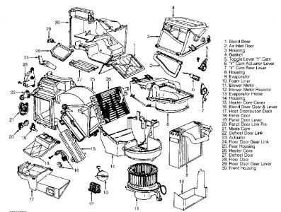

Blower motor is working on high only, know that it is the resistor, but exactly where is this located?
Jan 28, 2007 at 5:56 AM
SERVICE WRITER
  • 9,123 POSTS
Passenger side bottom of the HVAC plenum
See diagram below for location

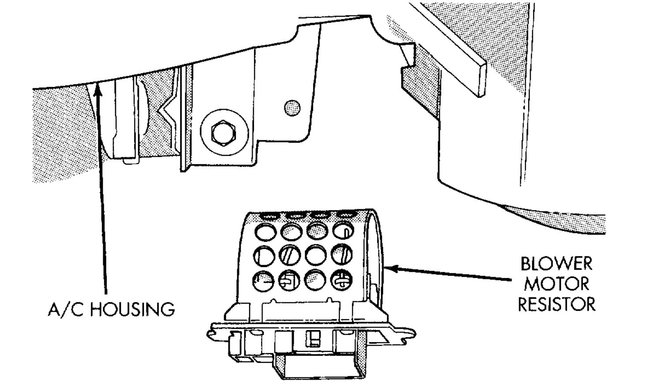

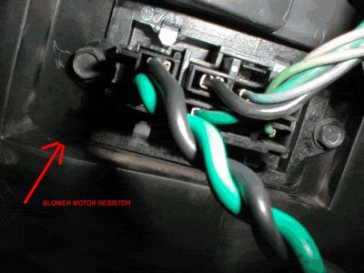

Yes it is there. Just next to the blower motor. Look at this picture.

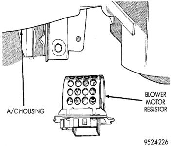

  • 75,988 POSTS
The blower motor resistor is located on the lower right side of the heater housing. REMOVAL Remove lower right underpanel silencer/duct. Disconnect wiring connectors on blower motor resistor. Remove blower motor resistor retaining screws. Blower Motor Resistor
https://images.2carpros.com/forum/automotive_pictures/12900_b_18.jpg
Pull blower motor resistor out of heater housing. INSTALLATION For installation, reverse the above procedures. https://www.2carpros.com/kpages/auto_repair_manuals_alldata.htm

MTSMGS
2000 dodge stratus se 2.5l blower and temp controm problem
Hi, The afore mentioned vehicle has only (4) highest speed working on blower switch. Also, temp knob doesn't regulate the temp at all. Where is the resistor located for the blower and how do I fix the temp switch. Thank you very much for your time and input!
Dec 31, 2018 at 2:28 AM (Merged)
SERVICE WRITER
  • 9,123 POSTS
https://images.2carpros.com/forum/automotive_pictures/30961_strres_1.jpg
https://images.2carpros.com/forum/automotive_pictures/30961_strres1_1.jpg

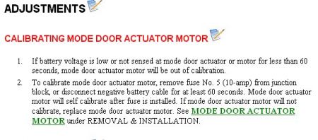

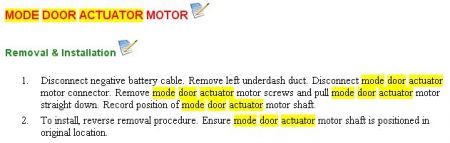

MTSMGS
Thanks for the advise. I changed the resistor and now all 4 fan speeds work, however, the temp control knob still doesn't change the temp of blower air. Can't hear any sound when i turn it, (like a door opening and closing) control motor for temp switch?
Also not sure where it is . Any ideas would be appreciated..
hanks again for your help.
Mike
SERVICE WRITER
  • 9,123 POSTS
I assume you tried to calibrate it? If not do so first.
