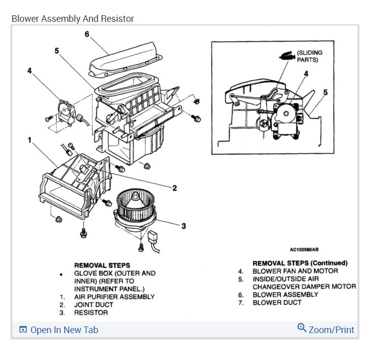

my heater at one point would only work on high, I was lazy and didnt replace the blower motor resistor. Now the heater will not work at all and I was wondering if I possibly did more harm to the unit?

No, you shouldn't have harmed anything else. It sounds like the blower motor went out here is the location for the blower motor and resistor so you can replace them to get the system working again this guide can help as well.
