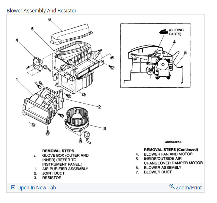

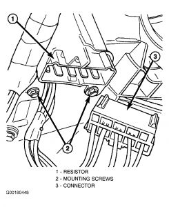

DOCFIXIT
  • 18,828 POSTS
Hi Most likely the blower resistor that lowers voltage to motor for slower speeds. Located in air plenum just left of motor has plug and couple of screws. see diagram
https://www.2carpros.com/forum/automotive_pictures/198357_Graphic_596.jpg
Hope this helps
