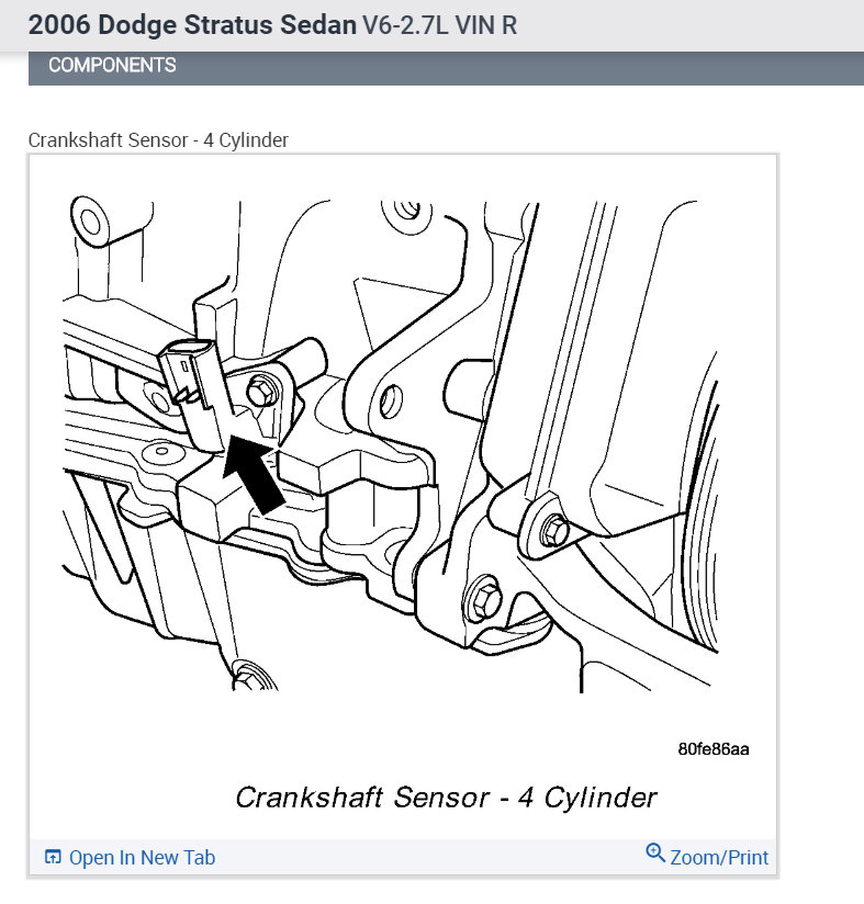

I have had an issue with loss of power when accelerating and even my car dying. The OBD light is on. I just received a quote from a service station to replace the crankshaft sensor and get a tune up. They want to charge me 370.00 to do this. Is this repair easy to do on my own and is this amount a reasonable amount to pay for the problem I am having. They also suggest fuel injection and carb flush and air filter replacement.
Jan 22, 2009 at 2:17 PM
  • 75,992 POSTS

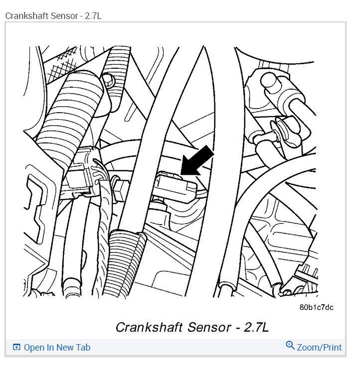

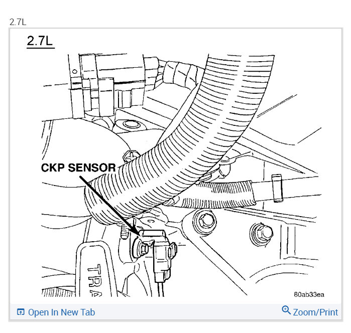

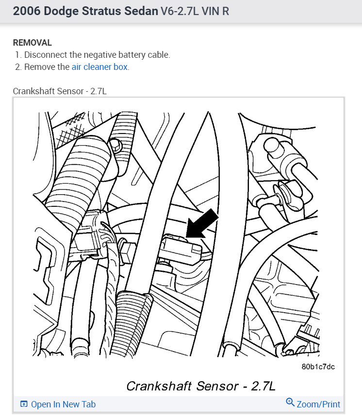

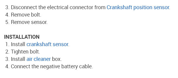

Hello, Here are the instructions and location of the sensor so you can change it out yourself. Check out the diagrams (Below). I have included all engines. Please let us know if you need anything else to get the problem fixed.
